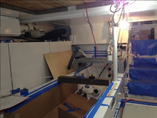

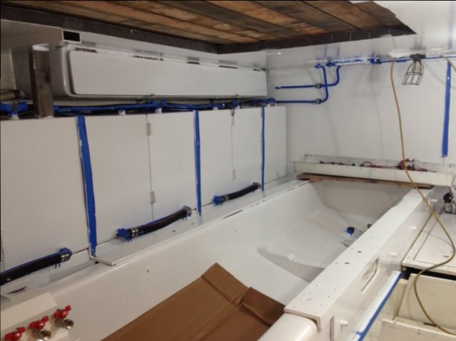

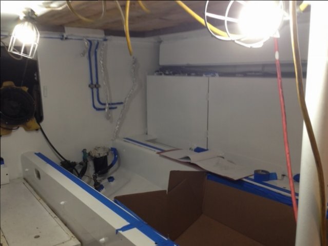

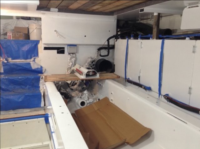

    Love to see some pictures of the current ER.
  11. Donzi 54
    Donzi 54 Member
    Oct 21, 2009
    176
    Point Pleasant, NJ & Morehead City, NC
    Lets see some pics
  12. Capt Ralph
    14,565
    Uh Oh, Better post some pics. We like to watch..
  13. DOCKMASTER
    DOCKMASTER Senior Member
    Feb 26, 2012
    1,661
    Ketchikan, Alaska
    OK here you go. Some boat porn for you :)

    Nice and clean, nice rerouting of hoses/piping.
