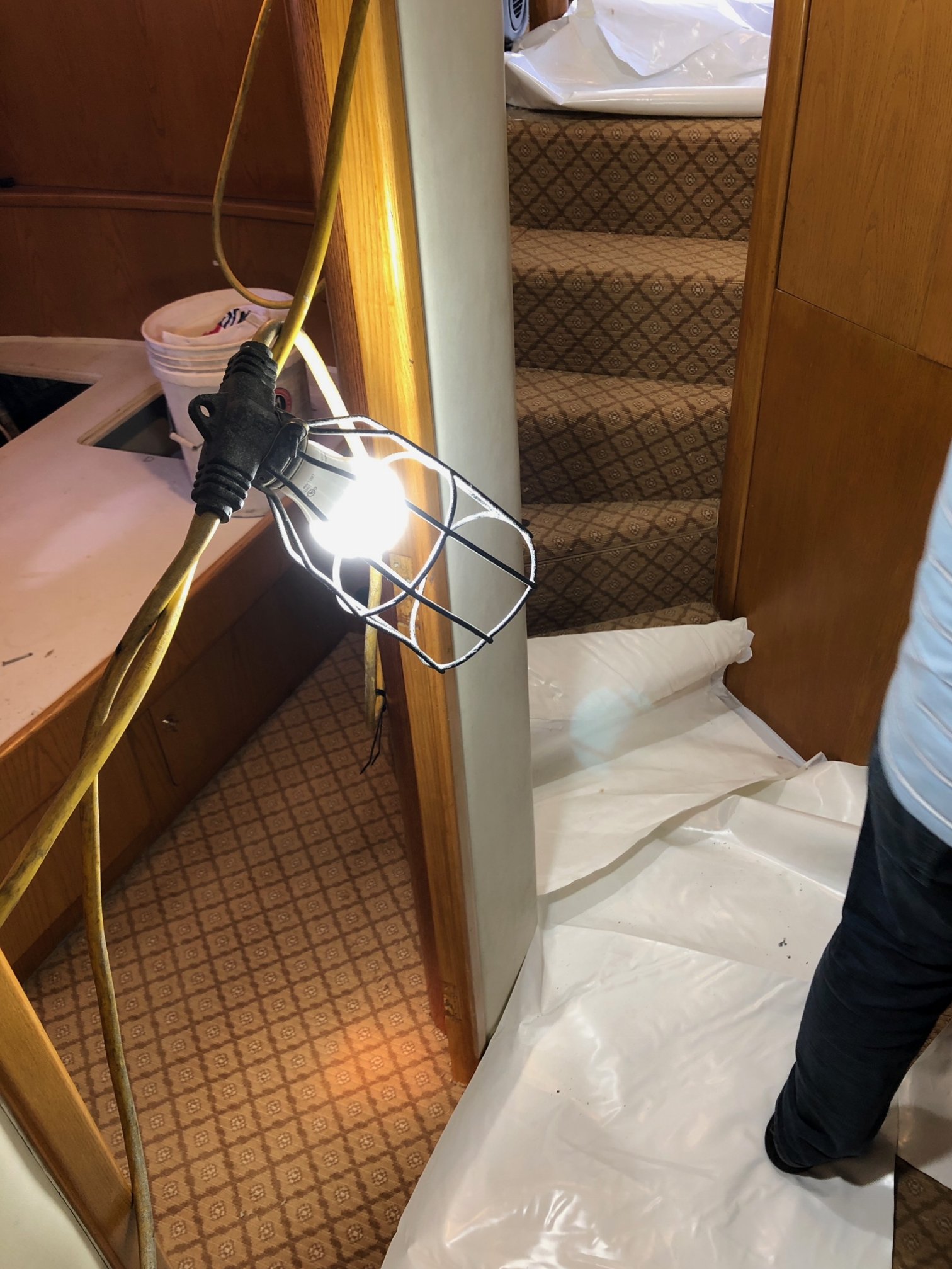

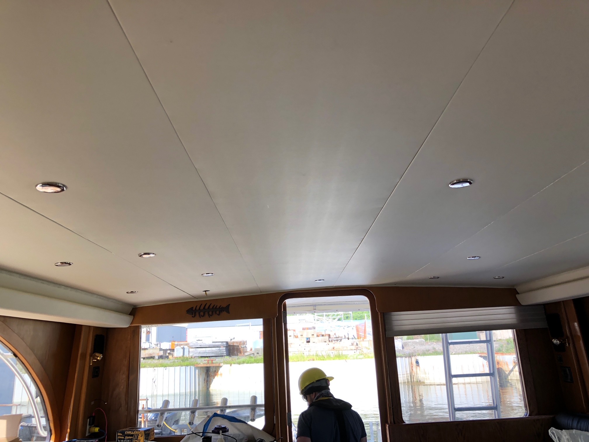

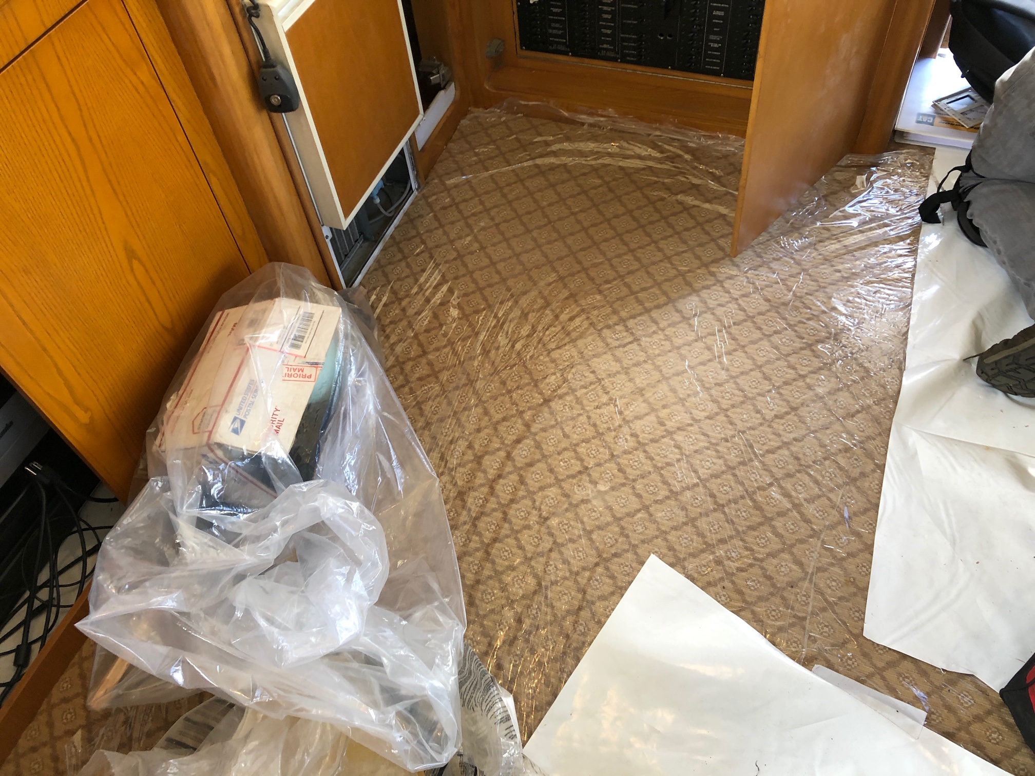

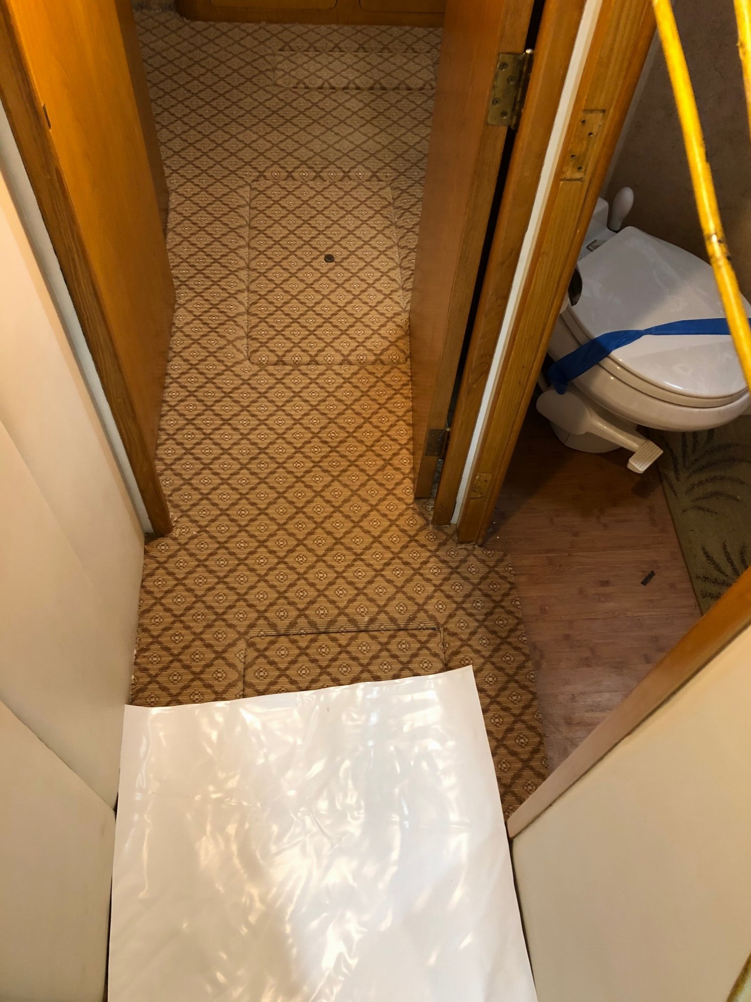

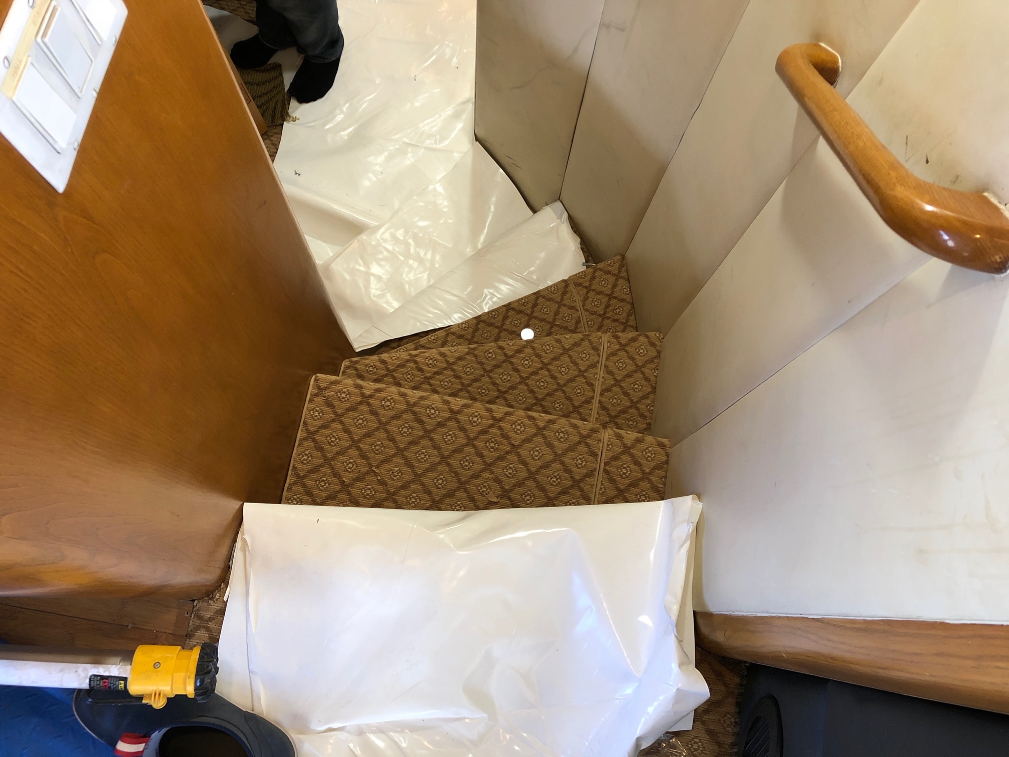

    Had some trouble with cockpit freezer compressor. Somehow it ceased up while sitting there over the months. New one on order. Galley compressor fired up fine and is all charged up. Continuing to get thru testing and lots of little things. Carpet install is just in finishing details. Here's some pics of the new carpet and the new headliner with new LED fixtures installed. For the carpet, I was going for a classier, richer look vs. the Polynesian look the old palm frond design had. But I didn't want to go with a dark color. Keep in mind the sun is a rare thing up there so dark colors are depressing. :):)

    Very nice selection, I like the carpet pattern !

    Thanks PB. I struggled with the selection. I kept being drawn to darker colors that would likely look more expensive. But I just couldn't put a dark color in given where we do our boating. But, of course, I got final sign-off from the boss (wife) on this selection. Happy wife, happy boating :):)
