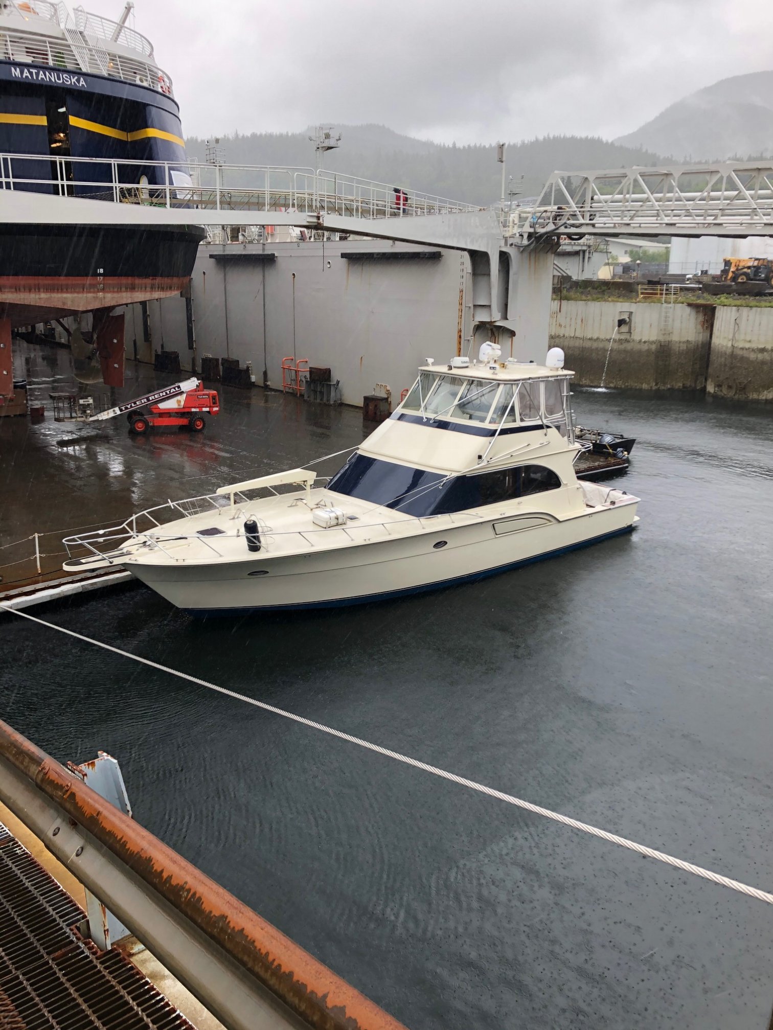

    Got back in the water this morning after 9 months on the hard. Went very smooth. Not a single leak anywhere despite all the work done. Lots to do still. Should be lighting off and testing the new gens in the next day or two. Will check and adjust final alignments if anything needed after sitting in the water a few days to acclimate. After commissioning and testing the new equipment then we go through from stem to stern, top to bottom and test operate EVERYTHING! New carpet still going in as well.
    Cat scheduled to arrive 6/8 to do checks and engine start ups. Trials on 6/9 or 6/10 depending how light off goes. Keeping fingers crossed on everything.

    She looks lite best I can tell from photo, as expected. But water tank is empty and still have more to put back on. Carpet, dinghy, etc, etc. Will see when all is back to normal. We are keeping at the shipyard to finish and do trials from there. Much easier access for tools and equipment. Will go back to marina slip after trials.

  14. Capt J
    14,901
    Well, it's ALWAYS nice to go back in the water after sitting on the hard for so long. I too look forward to seeing sea trial results. Very odd to see a SF without outriggers! :D

    I can't remember to have ever seen rod holders at the bow, either. If that's what they are...?
    Beautiful boat, anyhow.
    If someone would have said she's a brand new build, I could have believed that!

    I took the outriggers off and they are in storage. They are never used where I am and it is harder to get from cockpit to bow when they are installed. They narrow an already narrow walking path trying to get around them. I didn’t see any reason to drag them around with me.
    Yes, those are rod holders on the bow. We use them when we are bottom fishing. If we fish the max 6 rods I like to spread the bait and helps prevent tangle ups when current pushes lines around.
