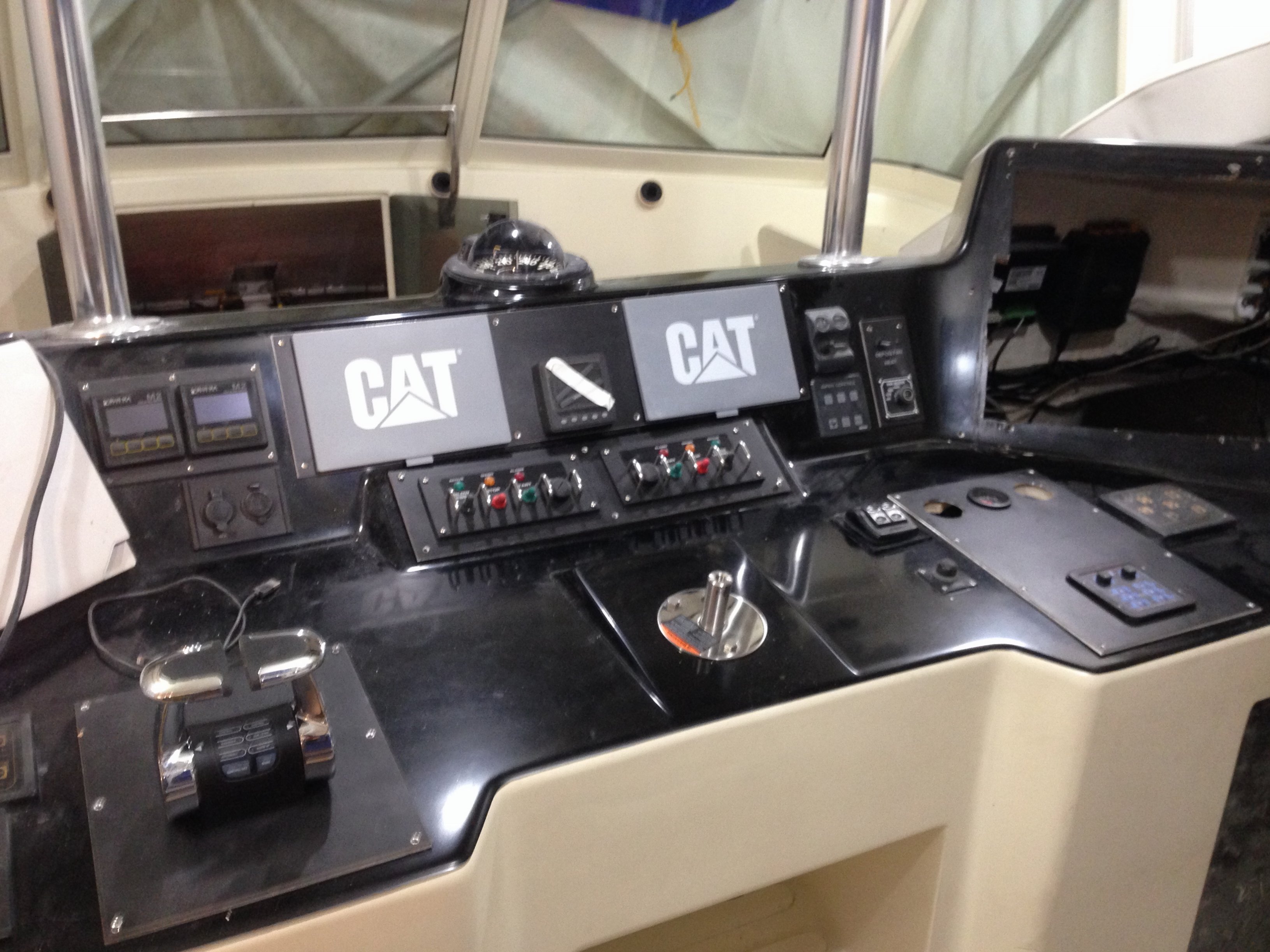

    I don't think an alum console will work here but it is a good idea. You can see the patch panels we're using in the below picture. This will do for now. I think next winter we will glass in all the holes, re-paint the black and start over. This will give me an opportunity to lay-out items exactly as I want them. We also could benefit from having the 3(ea) Simrad screens mounted without a panel which will require a short height extension where they go. One Simrad is to port and the other two mount in the opening shown to Stbd. The two stbd screens are out for easy access behind for all the electrical we have to do.
    We changed things up quite a bit from the original plan. The small screen between the CAT panels is the ZF data display. We originally had it and the ZF back-up panel right in front of the engine controls. And we had the 3 fuel gauges between the CAT displays. The ZF back-up panel is now to Stbd and is the one with two dials on it. And you can see where the fuel gauges are going. You cannot see the thruster control in this picture, it is to port of the engine control levers.
