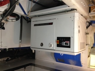

    Real nice progress, love the attention to detail, the upgrade to the main electrical panel and the resilient mounts under the genset.

    Those resilient mounts under the gen are secondary. There are resilient mounts inside the cover too so it is double isolated. If memory serves Northern Lights calls them auxiliary mounts or something like that. Suppose to further reduce vibration and therefore reduce noise.

    Yes it will, that’s the right way to mount a genset, give it another layer of quietness. I also like to do the same with lift mufflers, putting them on resilient mounts before mounting them to a platform.

    The new NL options include an alloy box (Jem) and second set of mounts.
    Just installed another 12 & 20 set. Not the answer to all but it does help over the usual set up.
    Down in your installation, should work very well.

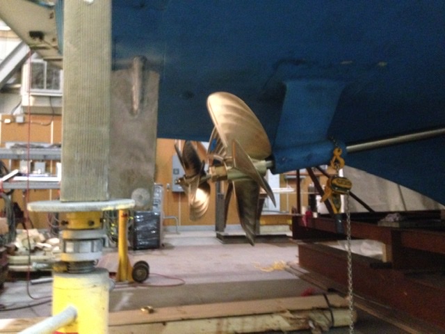

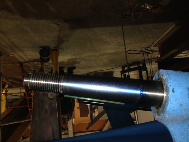

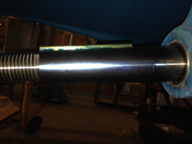

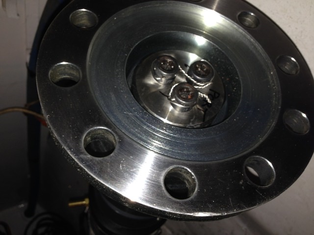

    Finished the 9kw other than a few final dressing items. We blue fit the new Veem props to the new shafts. Pretty much a perfect fit on both the props and the couplings. It’s nice when everything is CNC machines with standard spec’d tapers. We final torqued the coupling keeper plates and safety tied the bolts.
    Please, please don’t everyone start yelling about the prop nuts. This is just temporary to draw them up for the fit. We will switch the nuts around for final install. BF2C41C0-F217-41E8-8E1F-E6B79B8F207C.jpeg 835D86D6-A5A3-4F22-BCD1-E472FB9D3B96.jpeg FB87E39E-D18F-4C81-A943-C41A2E72FD7B.jpeg D3CBC170-BF4F-4F5F-99E4-ED6B419C8CD1.jpeg 908BF5AB-552B-4D08-91A7-046D2869F56A.jpeg
