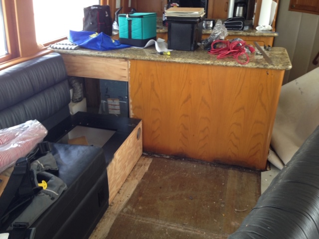

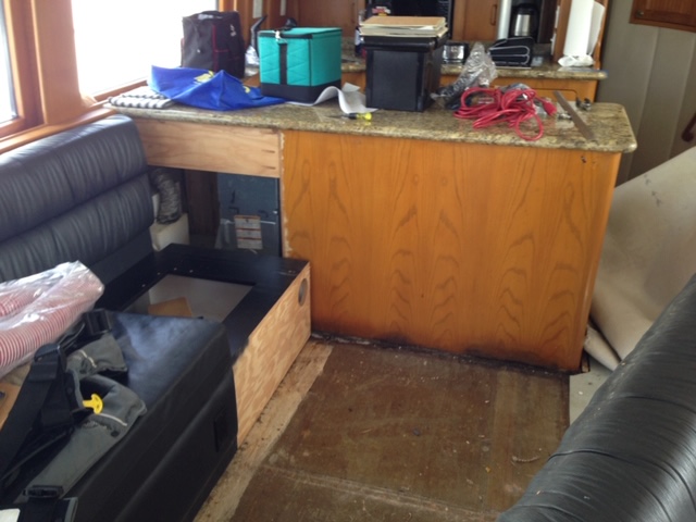

    I'm starting a new thread to cover the Repower of my 1994 54' Donzi (by Rosciolli) Sportfish. Today I formally placed the order for CAT C18 ACERT 1150 hp engines and ZF665A gears. These will replace the existing Detriot 12v92TTA's. In addition to the engines and gears I am also replacing the generators, propulsion controls, oil change system and likely other items as well that make sense while we are torn apart. I'm still making final decisions on some items and will post once I have info.
    To swap engines we have to cut out the salon floor and aft salon bulkhead as there are no hatches. Today we started removal of Settee's, carpet, dining tables, cabinetry and joinery work. We have done our mock ups and laid out the access cuts. The boat is scheduled to be hauled and go into a building on 9/26. I'll document progress and post pictures as we go along.

    My lead guy has been doing detailed layout and mock up the last few days. The good news is the holes in the deck/engine room ovhd will not need to be as large as we thought. We will separate the engine/gears and have a sequence to be able to get the items in/out along with the gens. By doing this we do not have to touch any of the galley equipment or cabinetry, etc. The window in the aft bhd is not large enough. We will be cutting just above the cockpit freezer and below the flybridge. But will leave enough room for fiberglass overlays going back. I spoke to CAT and they have no issue with us separating the gears from the new engines since they work with us regularly and know our capability. In the attached picture you see the galley island/bar with granite countertop. By reducing the deck hole size this can now stay in place. Boy things sure get ugly in a hurry when you start tearing things apart!

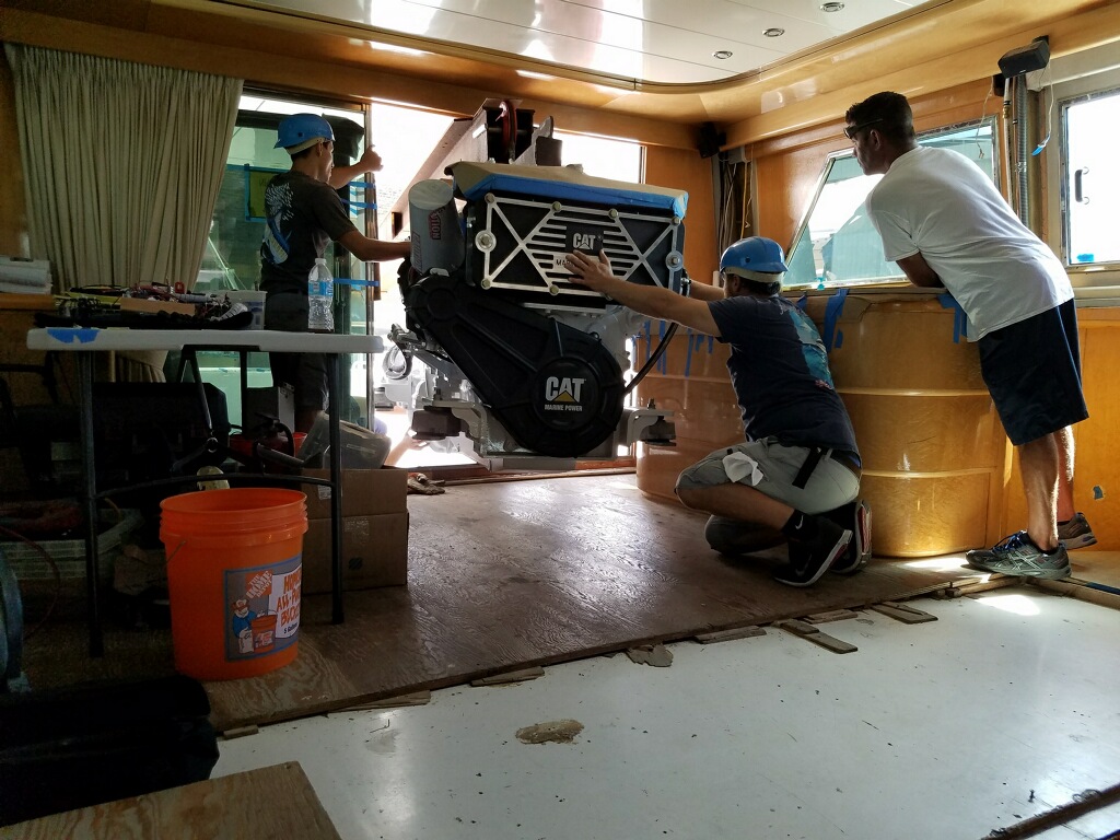

    I wish you had photos too! :) If memory serves you went to bigger engines. The C18's are near identical to the 12v92's, actually a smidge smaller. On the port side we will decouple the gear, slide the engine fwd until up against the fwd bulkhead, then remove the gear and small gen, then we can slide the engine aft and get it out with the deck hole aft of the island.

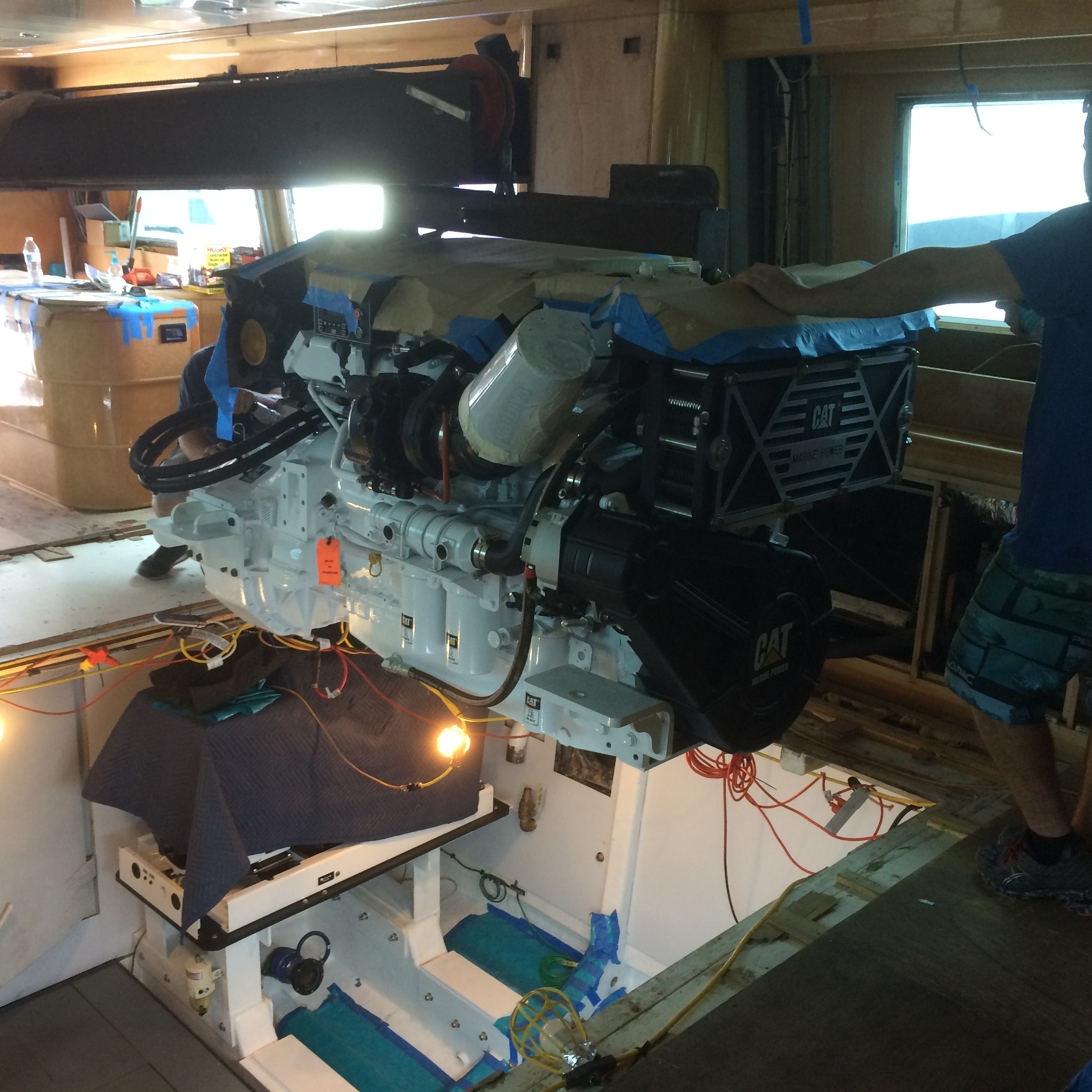

    You'll find that the C-18's are a bit taller than your old "V" configured Detroit's. I repowered a vessel in 2016 by removing triple 12 cyl MAN's with no issues space and rigging wise and had everything figured out for the new Cat installs until coming through the aft sliding salon doors with a lifting stinger that the C -18 wasn't going to clear the raised threshold and O/H door valance without wood butchering and engine accessory removals taking place. The rigged C-18s were 10 inches higher vertically coming in than the v-12 MAN units were leaving.

    For clarification, your lift rigging points on the Detroit's are going to be significantly lower in the well of the "V" as opposed to the lifting points on top the straight 6 cyl Cat C-18's and that was a difference that snagged me 9 months after the MAN's came out. I adapted and overcame in the end but I'm assuming that your going to reduce the size of your Detroit's via removing the turbo's , blowers, heads & motor mounts to keep its profile skinny when removing?

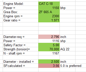

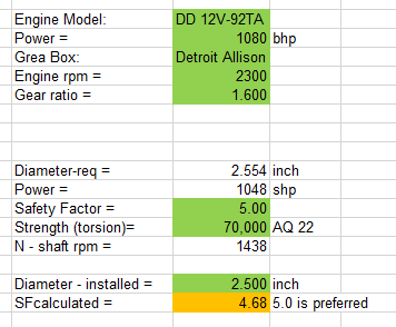

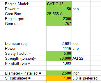

  19. DOCKMASTER
    DOCKMASTER Senior Member
    Feb 26, 2012
    1,408
    Ketchikan, Alaska
    I was really hoping to keep the 2.5". I'm currently exploring 1.525:1, 1.757:1 or 1.9:1. I realize the 1.9:1 is probably best option but I'm guessing that drops my safety factor below 3 on the 2.5" ? How much difference will there really be in performance? And, of course, if I change shaft size then I have no choice but to do props as well.
    I know when Donzi 54 repowered he indicated he was able to bore the existing struts and go up to 3" shafts. I don't know about the hull shaft entry? Perhaps Donzi 54 will weigh
  20. PacBlue
    PacBlue Senior Member
    Jan 9, 2009
    1,988
    Dana Point, Ca
    Here's a look at where you where at and going forward:
    Original Installation with 12V-92TA's:
    CAT C-18 with ZF 665-A gear and 1.757 ratio:
    And with CAT C-18 and 1.971 ratio:
    Looks to me you would need at least a 2-3/4" Shaft.
