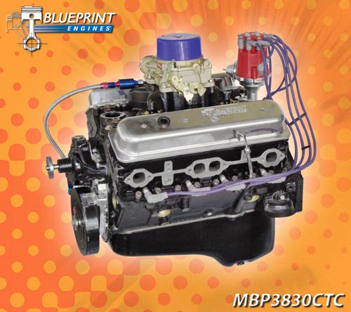

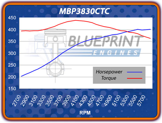

    Here is the crate outfit claiming 400/435 I based my stroker idea on
    Block:
    Seasoned 4-bolt main
    Max .040 bore
    One piece rear main seal
    Sonic tested to assure wall thickness
    Align honed main bearing bore
    Rotating Assembly:
    New SCAT premium crank
    Keith Black Hypereutectic pistons
    New COMP CAMS roller camshaft
    Cylinder Heads:
    Cast Iron Vortec
    1.25 dia. valve springs, hardened retainers and keepers
    2.02 swirl polished intake valves
    1.60 swirl polished exhaust valves
    Elgin hardened push rods
    Long slot rockers with positive lock adjusting nuts
    New Brezinski cast iron marine intake
    Edelbrock Fuel Pump
    Edelbrock stainless steel fuel line and filter
    Cast iron circulating pump
    Edelbrock 750 electric choke carburetor
    Professional Products harmonic balancer
    MSD Pro-billet distributor
    MSD Blaster SS coil
    AC Delco spark plugs
    MSD wire looms
    MSD Super Conductor plug wires
    Blueprint "Signature Series" polished aluminum valve covers
    Rubber coated steel oil pan
    Brass freeze plugs
    All engines are dyno tested on a state of the art DTS dyno and ship with a complete spec sheet

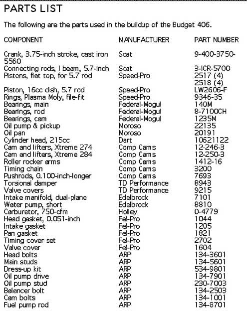

    Checking into the 400 youre right its the best SBC TQ motor out there. Biggest isssue and not really is steam ports on the heads as it seems any set of 350 heads will match. The do say they are prone to over heating.
    I assume you could find junkers but just to check I found the following remans long blocks so they are out there
    CHEVY 6.6 400 V8 - 70-78 Small Block, 6 bolt heads 2 bolt block
    CHEVY 6.6 400 V8 - 70-78 Small Block,6 bolt heads 4 bolt block
    CHEVY 6.6 400 V8 - 79-80 Small Block, 7 bolt exhaust, 2 bolt block
    The consensus seems to be the 2 bolt is better???
    Chevy performance with the parts listed claims 450HP/500TQ
    What would you do to "marinize this set up"?
