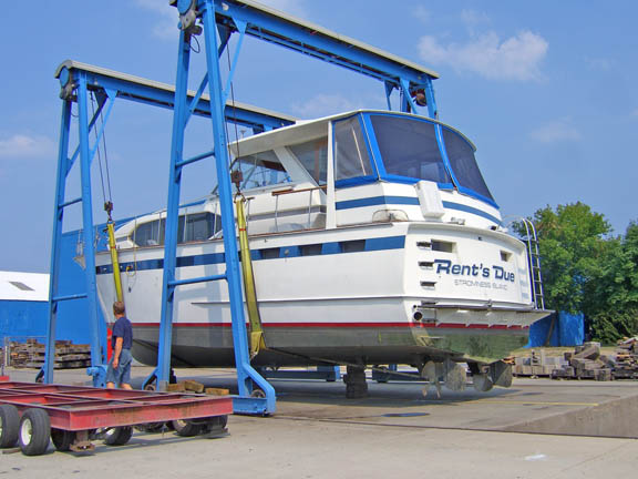

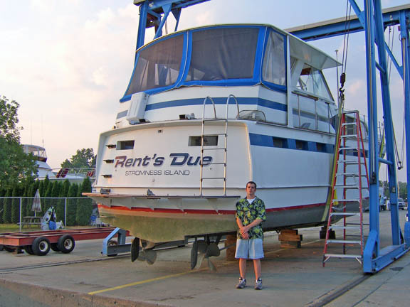

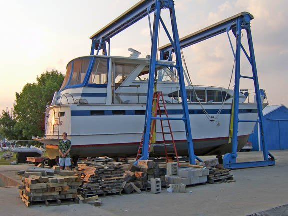

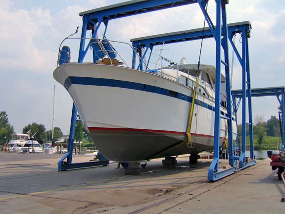

    The following slingshots were made shortly before we got underway when we had her lifted to clean the bottom and install a new depth sounder/fish finder:

    Inspirational pix there, acellist. Now I'm all revved up to get down to the boat tomorrow!
