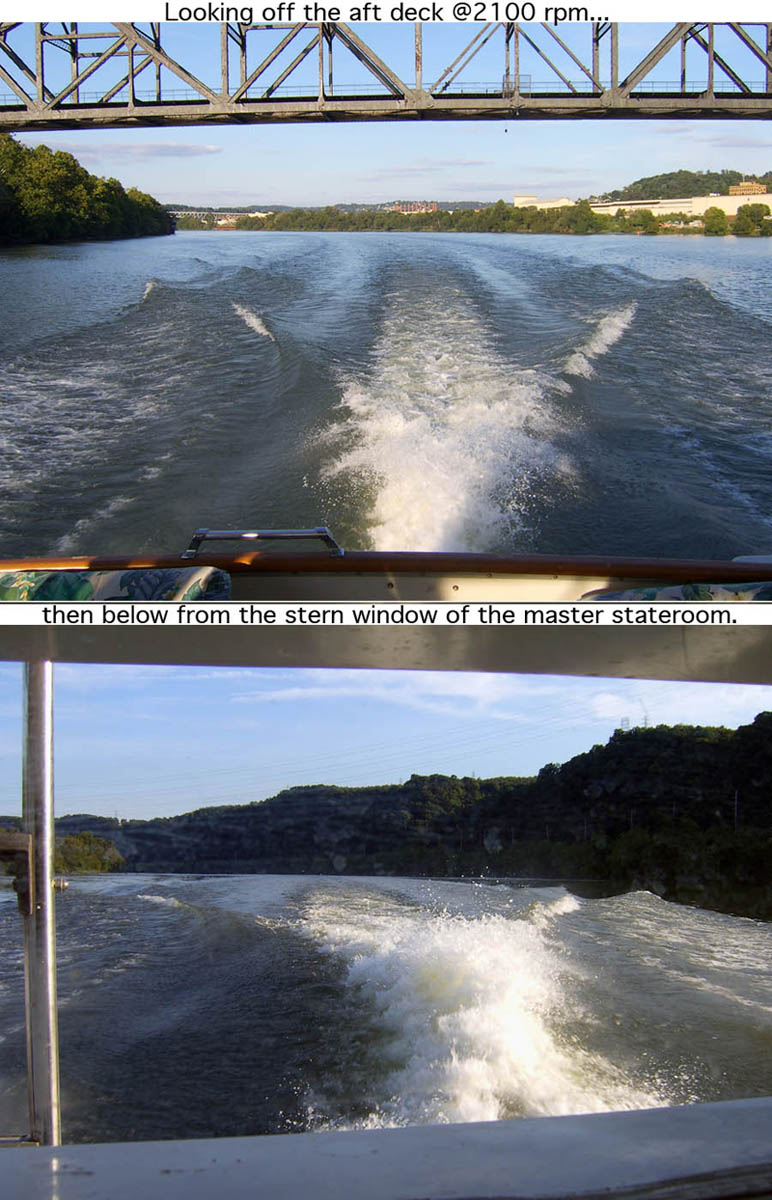

  13. acellist
    acellist Member
    Oct 16, 2005
    42
    Pittsburgh, PA
    Planing, exhaust and shaft size for 46' Roamer Riviera
    Our 8V 71N Detroit Diesels are rated at 320 hp in the original manuals from Detroit that came with our Roamer.
    The shafts are 1.5 inches in diameter.
    Wheels are four blade 28X28s.
    The exhausts at the stern are 6 inches OD about 5.75 inches ID.
    We took her up to her maximum rpm (2100) and achieved 20.5 mph.
    That is 2.5 mph below Chris Craft's 1969 rating (1968 was an estimate at 27 mph) over-sized 4 blade props are probably the culprit.
    The bow started to rise around 1800 rpm c 17 mph.
    As I lowered the trim tabs on the way up to 2100 rpm the bow dropped somewhat, but not to a completely level attitude.
    There are few places around Pittsburgh where you may even think about performing such a feat.
    The two photos below were taken in one such place on the Monongahela River.
    Our wake was still a bit deep for true planing in my estimation.
    She was rooted and very stable at that speed.
    I do not know if she would have "planed" or gained more speed if I had raised the trim tabs when she stabilized, since we ran out of wilderness after 3 miles, what do you think.
    At best it remains an experiment for the Spring season.

    acellist, thanks for the numbers. I love the shot out the transom window.
    1.5" shafts with 871s? Hmmm...that leads me to believe that the shafts are not made of 304 stainless. Your exhaust sizing tells me that these boats were purpose-built for the power they originally came with. A sister ship to mine (ie 427 gas-powered) also came with the 4"ID pipes. So, given that I'm not interested in refitting shafts or exhaust on this boat, the limiting factor to the max HP I can install is the exhaust (assuming gas boats came with shafts of the same material as diesel boats).
    OK, so with 640hp on tap you can and do thunder down the river at 20.5mph. Tell us, what speed to you tend to travel at and why? Also, at 10kts or so does your boat handle like a pig?

    That shot out the transom certainly made things clearer to me and in answer to your questions q240z, we traveled the 2250 miles of our trek from Harrison Twp, MI on Lake Saint Clair through Lakes Huron, Michigan and the inland river system from Chicago to Pittsburgh aiming to average 100 miles a day. It took us 25 days to make Pittsburgh. Fortunately, although I was making allowances for waiting time at locks, there were only two long periods (more than 15-20 minutes) spent sitting at idle. One was Brandon Road Lock on the Illinois River System (3 hours) and the other was a few days up the Ohio where we waited an hour and a half or two. (That’s pretty efficient river traffic handling, 32 locks and only 2 extended waits.)

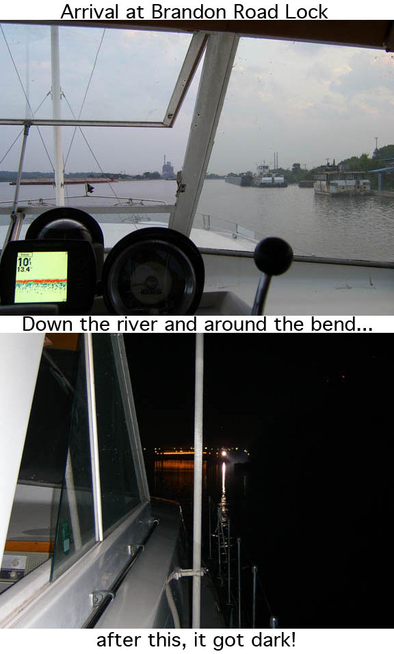

    If anyone wants to see them there are 79 out of the 6159 pictures Kim took on our ride at: http://outdoors.webshots.com/album/560759815Ntalud
    As to what speeds I tend to favor, I had been told by a reliable source prior to departure from the Detroit area that diesel engines like to run at two-thirds of their maximum rpm and pretty much kept to 1400 rpm throughout the journey which produced c10.5 mph on the GPS. We left every day about 7:00 AM and arrived at each next stop around dusk. Occasionally, when port arrivals demanded, we would push up to around 1500 to 1600 rpm and produce c12.5 mph. That’s all subject to slowing to no wake speeds when passing marinas, cities, and partying boaters pulled up on beaches along the way. These rivers were sparsely peopled for the most part.
    You asked about handling. Frankly, I was delighted at her performance at any speed (the port engine is idled a little slow and tended to cut out when pulled all the way back.)
    South of Peoria I gave my wife and two crew members a respite and towed them in two turns on a two man inflatable triangular raft, positioning the tow rope to hold them atop the front edge of the third roller in the middle of the wake at 10.5 mph. During those rides I performed two 360s, one to port and one to starboard. Far more stable than our previous Bayliner 2855 Ciera with the 7.5 liter Mercruiser outdrive.
    She handles like a charm when making small detailed maneuvers docking at idle speeds. I manage docking by approaching at 900 rpm or so and going into neutral about one to two boat lengths away, executing landing at idle speed using only the gear shifts with the rudders angled away from the dock side. Having those big four blade props helps greatly in controlling motion and drift at those idle speed maneuvers. I can honestly say that she responds to the touch and handles with ease in every situation I’ve come across, including backing down immediately from two sudden and harrowing encounters.
    Out the eight cruisers I’ve owned, she’s my favorite without any doubt!
