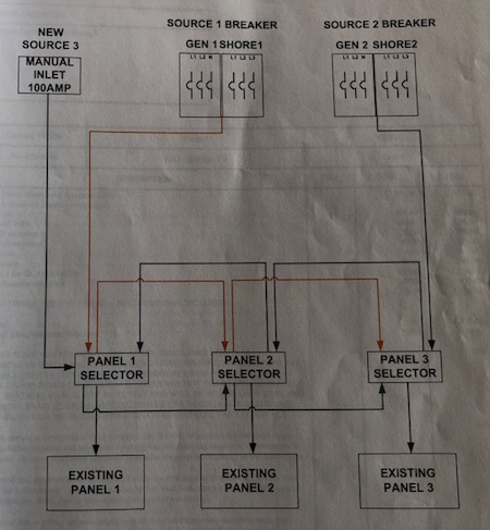

  17. cnvsback
    cnvsback Member
    Nov 18, 2009
    54
    I have a client who's 75 Hatteras has been retro fitted with a similar shore power setup. From Hatteras factory all 75's came standard with 2x 50a shore cords and Glendenning electric reels. The particular one I'm speaking of has been fitted with a single phase 100a shore power inlet, Charles C isolation transformer, the associated breakers, transfer switches and wiring at the main distribution panel. The installation is done very nicely and to ABYC electrical standards. If I remember seeing the invoice correctly $30-35k when installed in 2009. As far as the 50a system goes that has been left in place and the boat can accept either single 100a or dual 50a services you just need to correctly source select at the main distribution panel.
    The 75' came in 4/5SR layouts, when 8 guests or more are onboard its not difficult to find the threshold of the 50a system on a hot Florida summer night in 85+/- degree cooling water. Seven direct expansion AC units don't help the cause(this boat has a additional 48k btu flybridge air). The previous owner of the boat was tired of resetting breakers in the middle of the night with a full guest load on board and retro fitted the single phase 100a service. For this boat I feel the system is a good addition being as it is a dockside floating condo with minimal generator usage. It also gives flexibility when moving marina to marina. If they have an available 100a service, great. If not get the 50a's out and load manage. Theres a huge locker on the swim step where the 100a cord is accessible with relative ease.
    See main switchboard wiring schematic below.
  18. Jdow
    Jdow New Member
    Dec 23, 2017
    27
    Massachusetts
    Thank you, the boat has 2, iso boost 50 transformers. Some more discussion with the client is needed before going further
