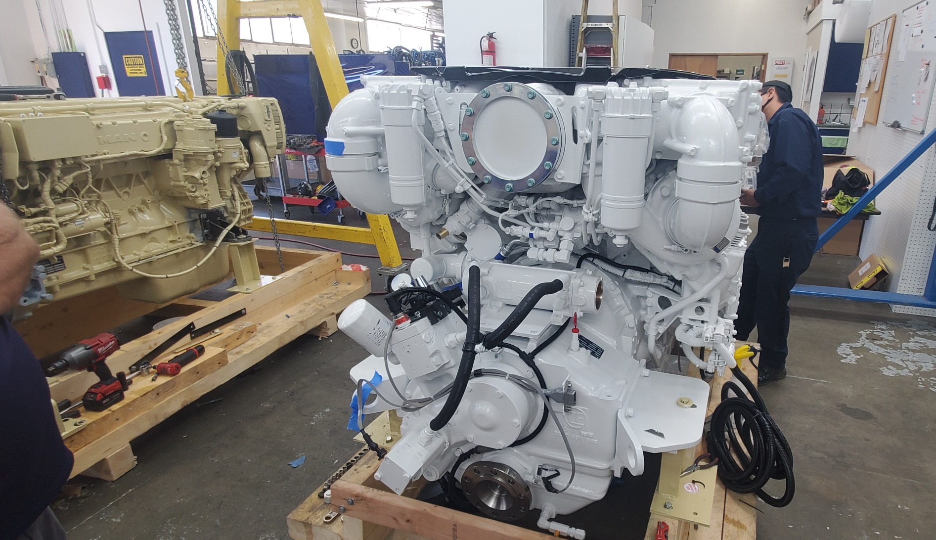

    I can't see any colour name or code in your photo.
    Can you (or anyone else of course) be more specific?
    I'm assuming you are talking of white engines, which is what I am interested in.
    MAN also used blue and grey in the past, but AFAIK only for some commercial engines.

    Yes. White engines. Works very well. Perfect color match for MAN engines or atleast those installed by RDI the MAN distributor on the West Coast.

    My understanding is that MAN ship the engines to their distributors and/or builders already painted.
    So, I don't think the white is different in those installed by RDI (or any other dealer for that matter) vs. those installed elsewhere.

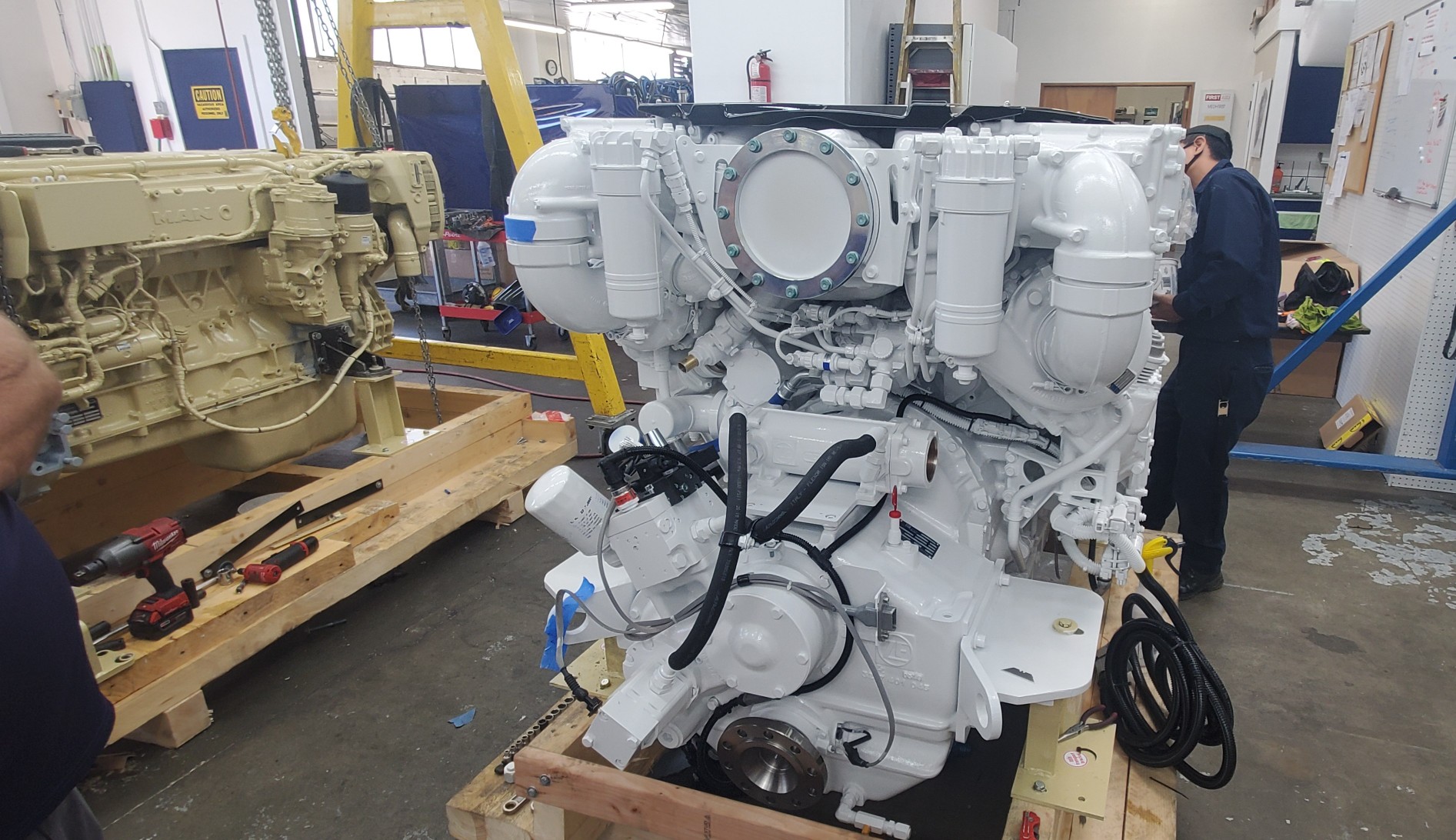

    From what I have seen RDI orders engines primer only and has their own paint booth so they can paint once the engine is set up for the intended installation. Here is a pic from a recent visit.
    TahoeJohn likes this.
  5. NYCAP123
    11,209
    That makes sense. A customer could want a custom color such as gray for navy vessels. Also if they decide one day to change their color it would be no big deal at that point, but if they have 40 painted blocks on the assembly line it could get expensive.
