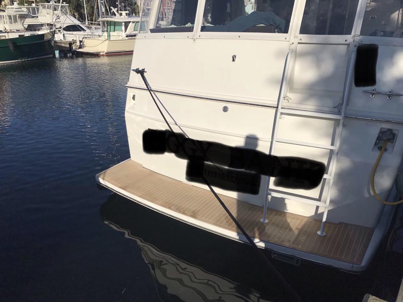

    This is a picture of my faux teak. I think it has about 4 years old. It is not maintenance free and it is hot to the touch, but it is not that big of a deal. Rightly or wrongly I chose faux teak because I thought it would hold up better than teak on the swim platform. It does have a 1/16th of an inch of seam that the installer has fixed once but I am pretty sure it is back. Going back to the boat next week after the hurricane layup, will check on the seam. Feel free to comment on whether you like the look or not.
    Carl, I tried to convert pixels to megabytes as megabytes is how my IPAD sizes pictures. The conversion was more than I could handle so I apologize if I exceed the size.

    Forget the faux teak, whoever painted the name on the back of your ship should be hung ! :rolleyes:

    Yea, I could not read it either. Must of been applied by a government trained redact guy.

    That lools good for the rear platform. If it were installed over all the decks then it would be subjective. You have an older boat and looks good. I've seen it on several Formula boats and 45 yacht and for the price they were charging I would not have it installed. For your rear platform i would think it helped with being non slip and an improvement.

    F350 thanks for the compliment. It was expensive. Chesapeake and Capt Ralph I will get with the transom painter and see if he can buff that out.

    I think that faux teak looks good on that boat. It may not on a Rybovich, but we'd be comparing apples to oranges if that were the standard. For instance, my gelcoated toe rail is no match for a high gloss Rybie toe rail of teak, but mine looks good - at least I think so.

    Fixed. :)
