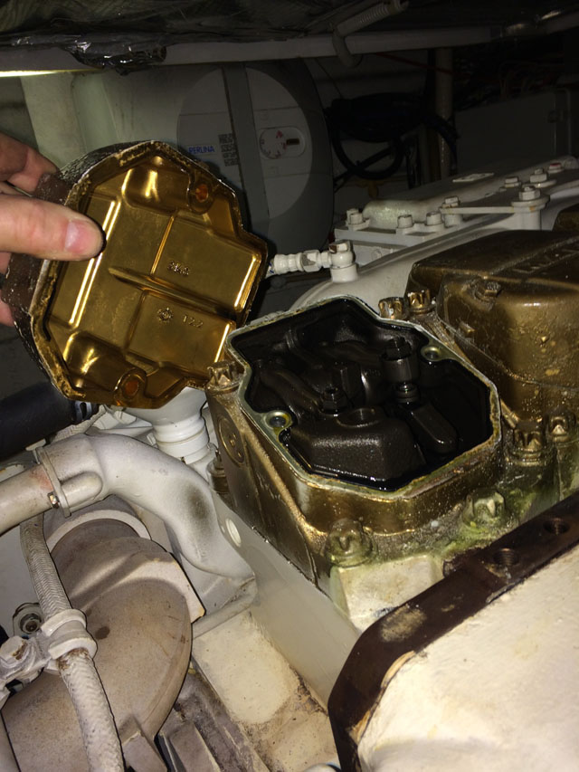

  3. Fiammetta42
    Fiammetta42 Member
    Sep 28, 2017
    130
    Liguria Italy ( boat )
    The gold are not painted, the alloy is gold here’s the inside of one .

  4. BoulderGT3
    BoulderGT3 Senior Member
    Jun 19, 2014
    168
    Ftl
    Same as the chrome.
    I learned the hard way that the plating on the inside is an issue when blasting and powder coating. The heat can make the inside bubble. Not good as it could let flakes fall in the engine.
