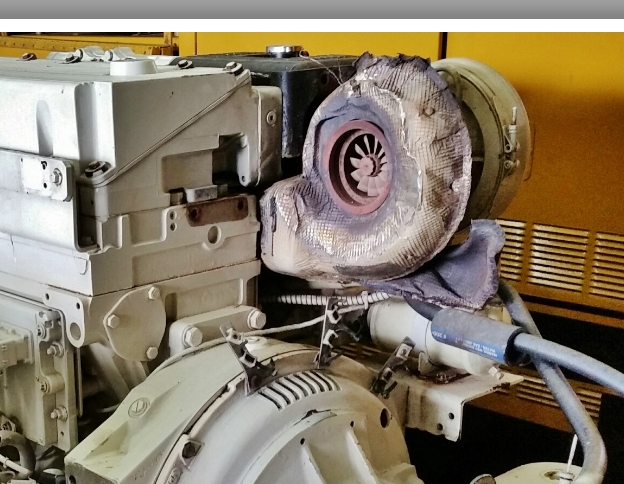

  12. PacBlue

  14. PacBlue

    Dana Point, Ca
    There has been a lot of discussion on dry exhaust manifolds and dry turbo's on the higher hp recreational ratings for the QSM-11 on other forums. Something a buyer should be aware of: https://www.sbmar.com/articles/propping-cummins-qsm11-to-prevent-exhaust-leaks/
    Nagging exhaust leaks leading to other maintenance issues and reduced parts life.
    A wet Exhaust Elbow after the Turbo does not equal a wet (water-cooled) turbo. Check and see if it has an insulated wrap around the Turbo - then it is dry and not water-cooled.

  16. PacBlue
    PacBlue Senior Member
    Jan 9, 2009
    1,995
    Dana Point, Ca
    The 48 Formula came with 660hp QSM-11's. Cummins does not have an 800hp rating for the QSM-11.
