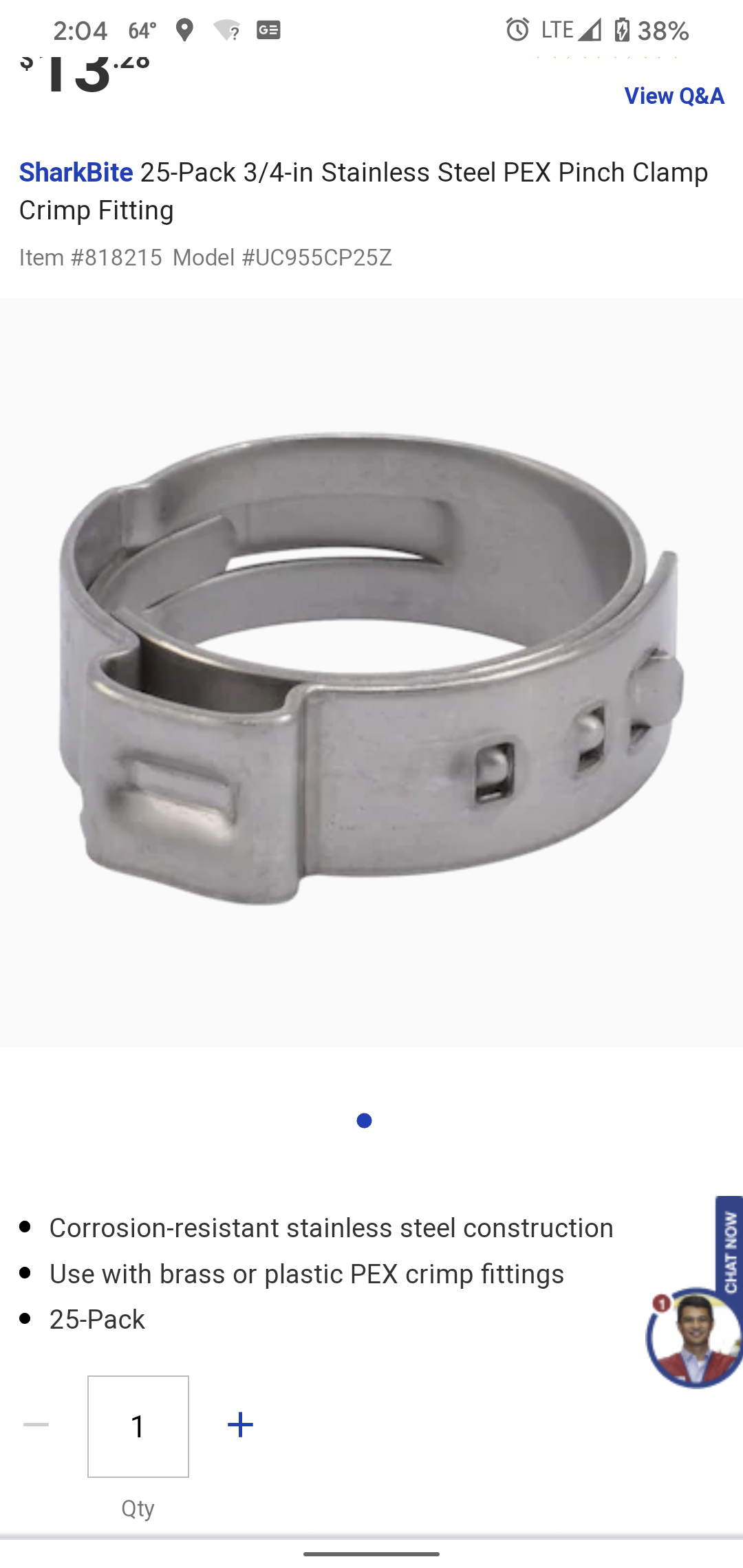

    I was looking at these crimped on brass vs Aqua lock. Plenty of room to double clamp. Screenshot_20210418-140436.png Screenshot_20210418-140436.png

    Perhaps not mentioned here, try to avoid using brass on a boat. If you use stainless clamps, use the quality ones usually not found at Home Depot or Lowes.

    I hope not, When using Polybutylene and clamp, the clamps, eithey alloy or monel were a failure topis.

  17. Capt J
    14,445
    You DO NOT want to crimp the connections. They pex expands and contracts with temperature changes and with vibration from running the boat. It is a major failure point. Either the crimps cut through the hose, rot and fall off, or expand. Use the plastic push lock connectors like every yacht builder under 100' and be done with it. The o-rings don't fail and the connectors generally last 20 years.
