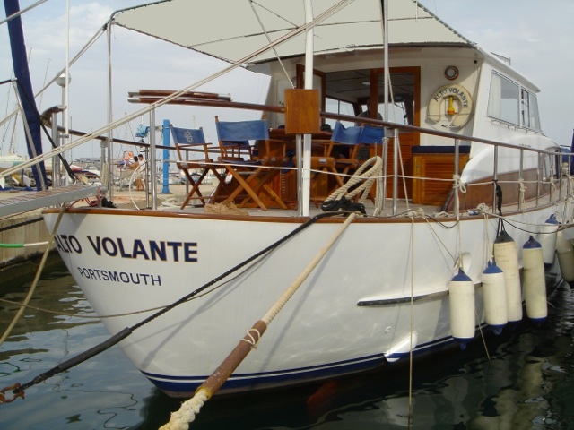

    Exhaust staining
    Here is a pic taken showing the hull and exhaust covers as she was when I bought Alto...no staining

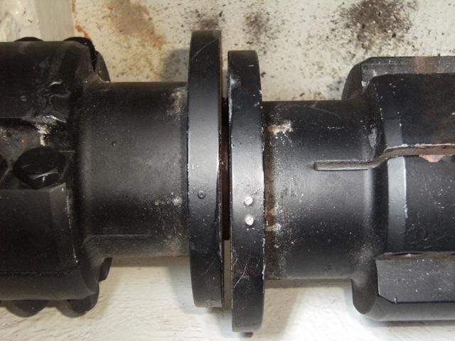

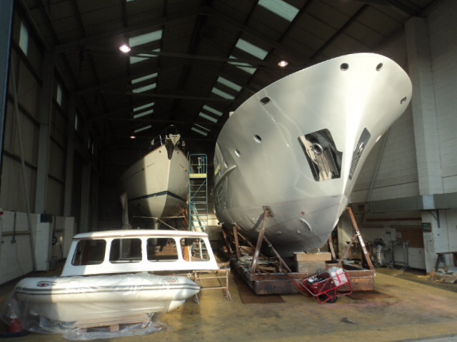

    Alto's hull has been filled /faired and just had her first coat of white applied and is at last starting to look like a boat again after 4 years of her hull looking like the surface of mars…I’ll post some pics when I can get a decent distance away from the hull as currently she’s in the corner of the shed surrounded by other boats
    When we undid the half-shaft couplings to draw the shafts , we discovered both shafts were seriously misaligned - the PS by approx 12mm. The cause /origin of this is still a real mystery (see attached pic of PS coupling when undone) as is the monumental cost of remedying the problem, which has involved major surgery to both the A brackets, having new steel bearings made up for aft ends of tubes (as the PS bearing was cracked, possibly as result of the misalignment) , new bronze sleeves fitted on the stern gland where there was also considerable wear, and then adjusting the Python bearers, moving the engines and altering the exhausts.
    We had new shafts fitted in Spain and they must have used jacks and chains to get the half shafts to line up.. In any event, hopefully everything is now all lined up and correct.

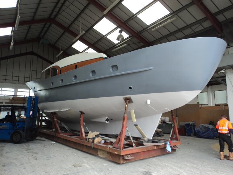

    Meantime , here is a pic showing Alto with her grey undercoat prior to first coat of white

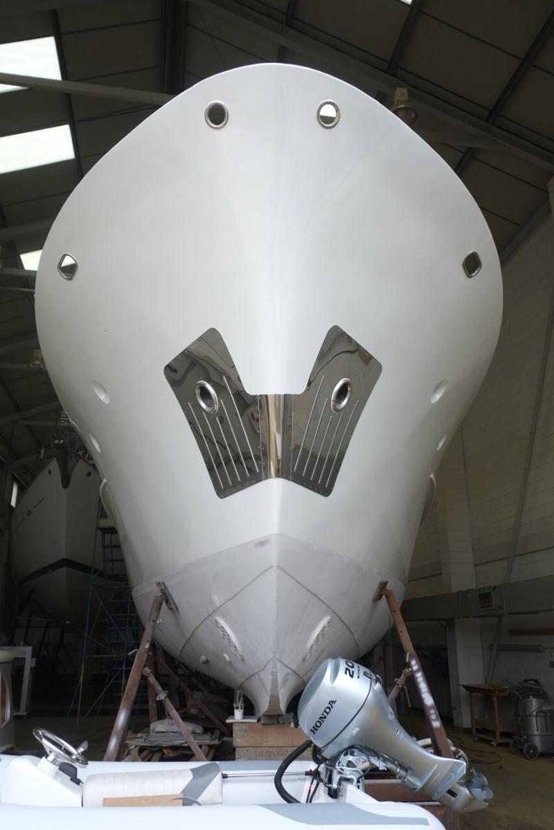

    Awlgrip topcoats now complete. In fact there some small runs which the the yard decided were not acceptable and had to be rubbed down again. The yard did the rubbing down on a friday afternoon and couldn't respray till monday which was too late for overcoating so the entire hull that to be rubbed down again and resprayed, she had an extra topcoat which cant hurt! She is now basically finished but there are till a lot of bits and pieces to complete before we do sea trials. Here she is with her anchor plate fitted.
    She is now being inspected for CAT 2 MCA. One issue that has already come up is the handrail height which the MCA require to be 1mt (ie 39.5cm) whereas the current handrail is only 30" high. Raising the s/s stanchions and teak handrail isn't practical and would look ridiculous at 1 mt. One solution is to fit a sign restricting guest access to the deck and making crew wear lifelines but that isn't going to be adhered to so some I'm hoping for a dispensation on account of her being an existing classic yacht.

    We've finish the coatings and the finish in Awlgrip "Off White" is superb. We're now starting to put her back together . Here she is with her new shiny anchor plates ..I don't know how long they'll stay looking like that!! Polished s/s rub rails next followed by the teak cappings and stanchions and handrails. Although we've used Ephiphanes on the teak superstructure, we're using Coelan Gloss on the hand rails and cappings. The finish looks as good as Ephiphanes but according to many magazine tests lasts at least 5 years in mediterranean summers, and maybe more. I used it on my mahogany 1938 Chris-Craft, which Ive left out over 2 English winters and summers and so far it still looks great. The down side of Coelan is that it can be difficult to apply on vertical surfaces and it is extremely expensive ...with the primers etc it works out approx £70 per Msq.

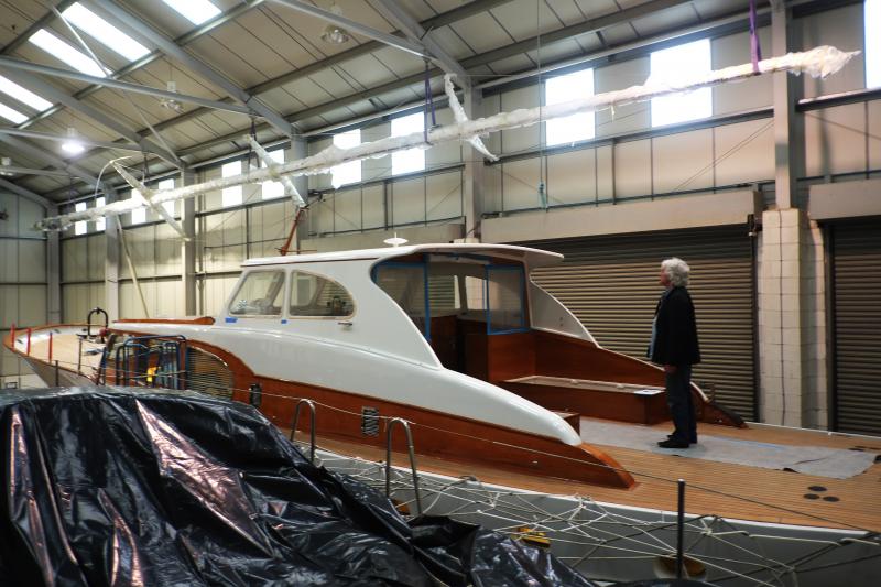

    here she is with new PH fitted - still loads to do!

    She is absolutely stunning! Bravo.
  12. Capt Ralph
    14,567
    Wwwoooooooowwwww!!
    That's beautiful!!
    That is the correct PH. Great design and work.

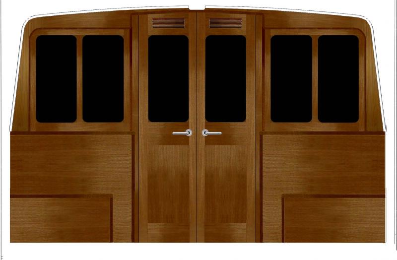

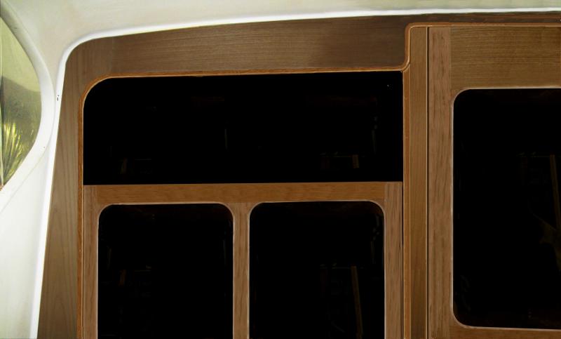

    thank you for your kind words. The aft screen is interesting, I think. In order to provide versatility the PH can either be completely closed up or be made completely open plan to aft deck. To achieve this the aft windows rise/fall electrically via a slot in the top of the aft island lockers and when down completely disappear into the lockers (the top of the widow frame is in fact the section of the locker top that was cut out to provide the slot for the window, so when when window is down the top fills the slot and the grain matches). The 2 doors can be easily and quickly removed and stowed in the aft seats. .(the attached pics are renders I produced with photoshop but everything has been made and is ready to fit)

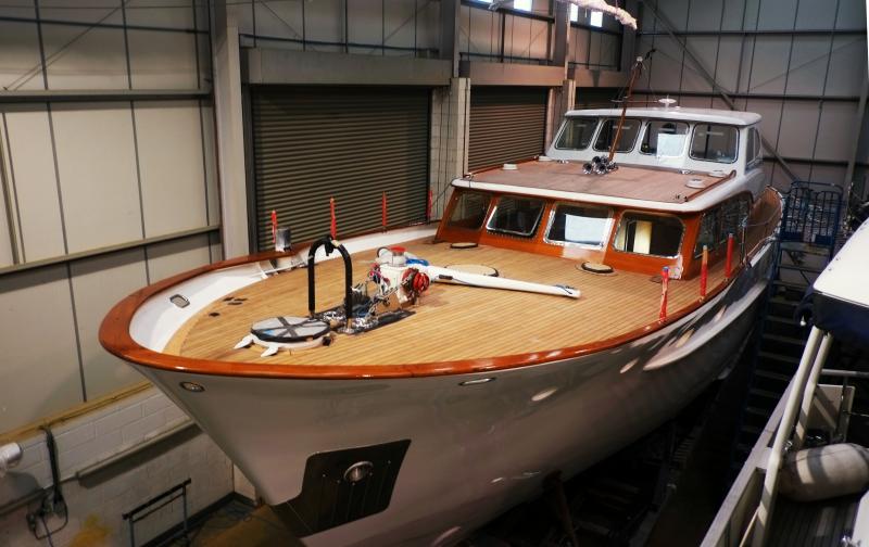

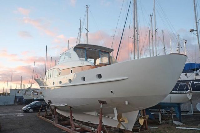

    Here are some photos of Tiky, painted and now on the hard at Foxs. Still a way to go before she goes south to the Med.

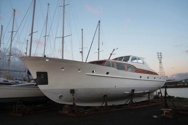

    Tiky - feadship
    And another view

    WOW ! She is gorgeous. Great job.
