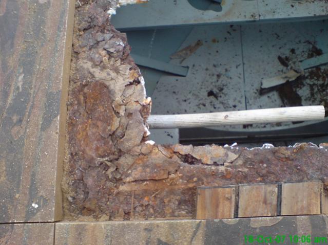

  3. david_japp
    david_japp Senior Member
    Feb 7, 2005
    369
    london

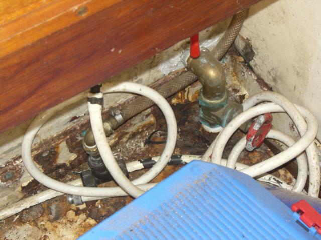

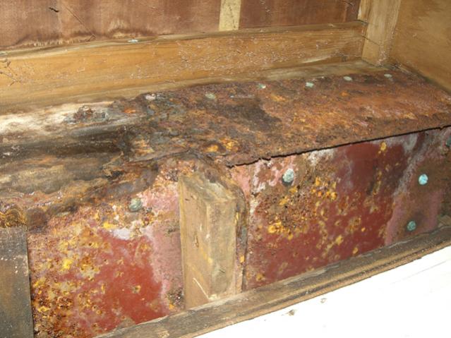

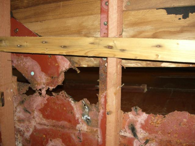

    TOTAL REBUILD OF VINTAGE 1961 62ft FEADSHIP ALTO VOLANTE (pka TIKY)

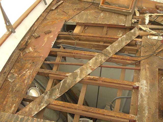

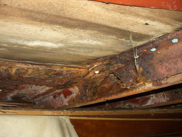

    thanks..here are some pics of some of the horrors we unearthed in the steel sub-deck structure

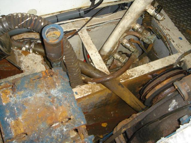

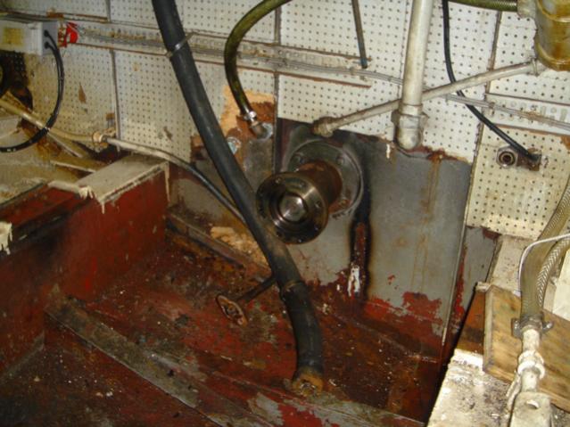

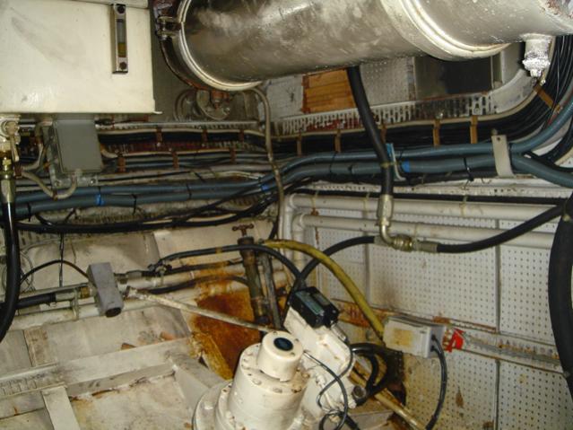

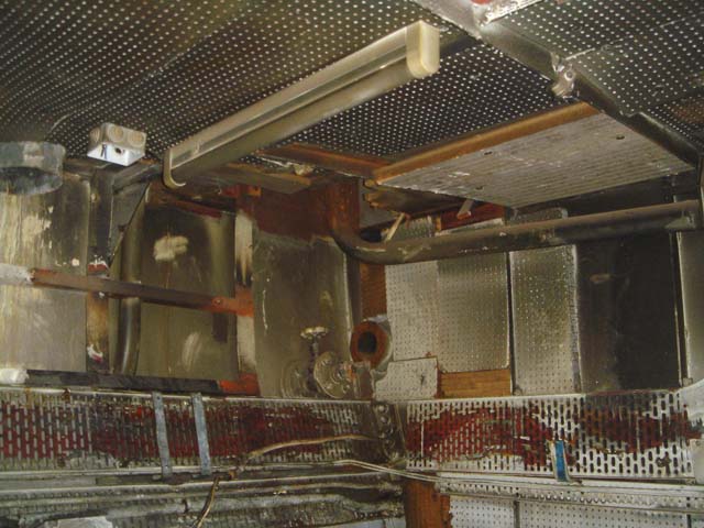

    and here are some pics of the engine room (described in sales info as "meticulously maintained" so "meticulously maintained " that one engine was totally seized and beyond repair and we ended up replacing both engines as well as the g/b's and shafts as well as literally every other bit of gear in the ER..

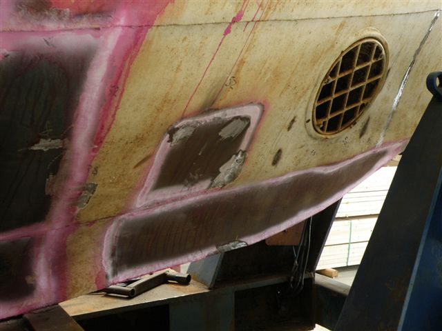

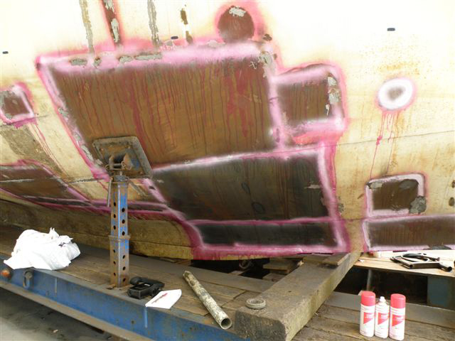

  5. david_japp
    Feb 7, 2005
    369
    london

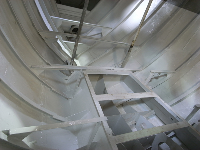

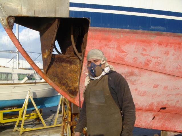

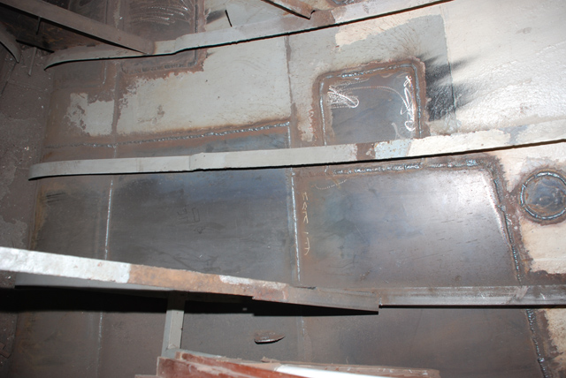

    and some pics of some of the hull plating works - we removed all doublers , grit blasted inside and out to smoke out suspect areas and then did ultrasonic surveys - we then cut back all thin areas and let in new plating. We then tested all the welds with hammers and did penetration dye tests (Shown in purple) along all welds and examined them under a microscope. Prior to fill/fair, the entire hull was grit blasted in small sections and immediately coated before proceeding to next section.

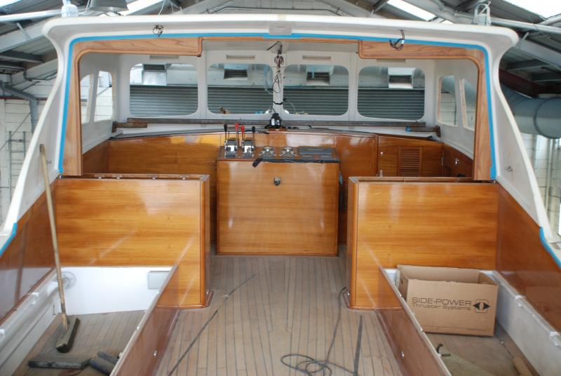

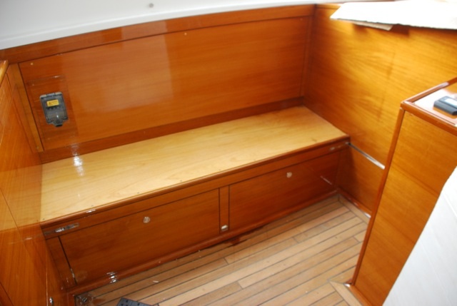

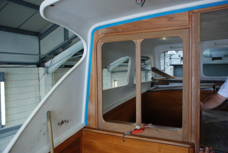

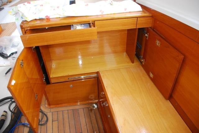

    the PH seat that extends to be a pilot berth
  7. david_japp
    Feb 7, 2005
    369
    london

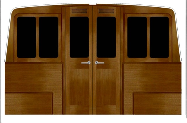

    A digital render of the doors and windows that form the aft screen of the Pilot House. The 4 P & S outboard windows lower electrically and entirely disappear into the P & S lockers, and the doors are removable to be stowed in the aft deck seats. This makes the PH a very versatile space - ie fully closed up in inclement weather or when the pilot berth is being used for a crew or a guest, or fully opened up so as to link seamlessly with the aft deck.

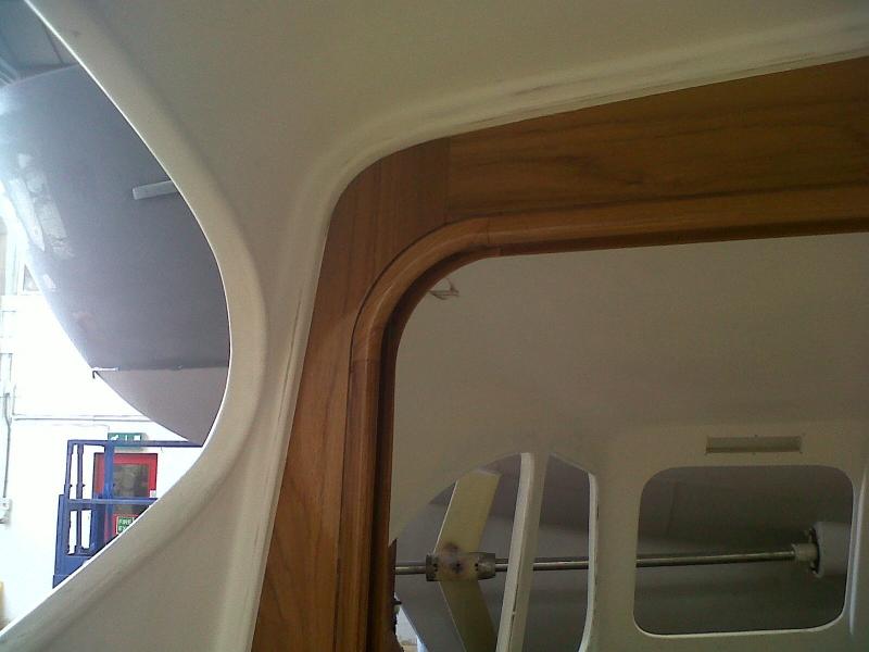

    Total rebuild of vintage feadship
    Aft end of Pilot House showing lockers

  11. david_japp
    Feb 7, 2005
    369
    london
    Vintage feadship
    The PH seat ( the seat base extends to form 30" pilot berth - the s/s tracks on which the top slides are visible on the BH? Life rafts are stowed beneath in dedicated lockers.

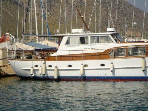

  12. ombreetsoleil
    ombreetsoleil Senior Member
    Aug 19, 2011
    824
  13. david_japp
    Feb 7, 2005
    369
    london
    Vintage feadship
    Hi
    Tiky's big sister, I think you mean....a lovely vessel.
    Yes, I have fitted stabs. She originally had Vopers fitted but these, like everything else, we're in such poor state that I replaced the whole system with a Wesmar system. Its all fitted except the fins which will be fitted after the fill/fairing and coatings are finished. She does have Aircon throughout, hence the wooden grills you can see in the pics.
    In fact I think we're going to base her in the new marina in Imperia, a few miles from Genoa and I'm due to go check it out next month
    Best
    D

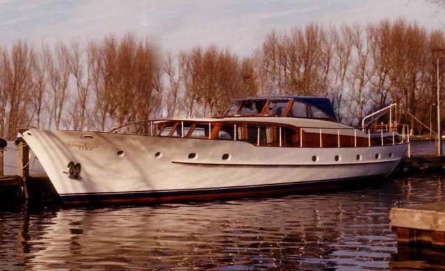

    Vintage feadship Alto Volante pka Tiky
    Another vintage pic

  19. david_japp
    Feb 7, 2005
    369
    london
    Total rebuild vintage feadship alto volante pka tiky
    Her are some pics showing the ugly and ungainly PH That was built in Holland in the early 1980s. The size and shape of the windows didnt match the saloon windows and the general boxiness of the PH was all wrong for curves on the rest of the boat. As it happens, as we discovered after we removed the PH, much of its supporting structure turned out to be rotten so it would have had to be rebuilt in any event. Ater much fretting I designed a PH that I believe is more approporiate for a boat of Alto's vintage and sympathic to her lines.
