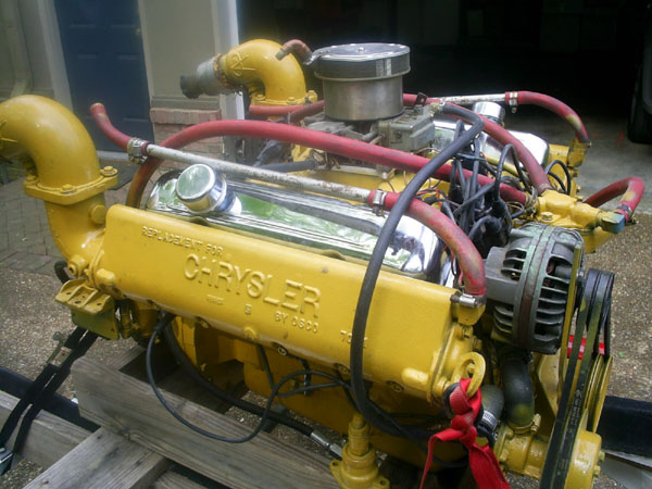

    i just love that boat too much. i am thinking of repowering with Diesels. i would need to replace everything from the engine out to the prop. (or maybe reuse the existing props ?)
    can anyone give me some advice ?

    You will likely also have to replace the galv steel fuel tanks, gauges, add fuel lines, increase engine room vents, etc., etc., etc. I really wanted diesels also. I looked into this last year on my Roamer and it looks like at least a one year project with extensive unknowns and unknown costs. Likely not a good return on efforts. I've had both my big block MoPars rebuilt for $10,000. Look at all parts of the project.

    a bunch of engines. about 3 years ago we went with custom pistons/ceramic coating on the combustion face. they are indestructible. UNLESS a Walter V-Drive locks up/breaks the flywheel into little pieces/causes some horrible damage to the engine.
    it is heart-breaking. it is a good boat with a good hull. but at best these were race-car engines. i can't work on them myself, and this happened on my first outing of the season.

    I hear ya about not be able to have something reliable. That's what lead me to have both motors rebuilt. Last year I did run across a set of 4 cylinder Detroit Sidewinders at a great price that had similar power and torque and weight to the Offshore motors. I just thought the project was too open checkbook. this is the second time my Offshore original motors have been rebuilt, last time in 1978. You will still need the Walter V-Drives unless you reconfigure the salon and engine room.

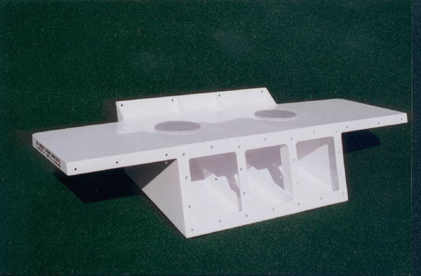

    displacement hull, i would think i need a lot of torque ? obviously i would want to remove the swim deck. what would need to be done to attach these animals to the boat ?

    Here are some ideas:
    "Each twin engine bracket with a swim platform is 84” wide and like the
    basic twin bracket is rated for 500 horsepower. These brackets weigh
    approximately 175 lbs."
    http://www.armstrongnautical.com/brackets.htm
    http://seamount-mattson.com/twinplat.htm

    You could consider mounting them as outboard as possible, on the strongest portion of the hull/transom. This would leave you with a smaller swim platform in the center, but at least its something
    You would probably have to beef up the transom as it was not designed to support outboards. I know my transom is only approx 3/4".
    Jack plates would also be a good idea.

    i don't mind losing the swim platform. i ran the idea past the mechanic. he said he did not know if this would work with a displacement hull like mine, vs a planing hull ?
    but you guys seem to know. obviously i need some help.
    as far as reinforcing, i have a great fabricator/welder. i would just need to tell him what to do. a big concern is putting the boat out of balance in terms of weight all the way out there on the back.
