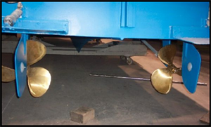

    When it was converted from twin engines to single engine, what was done with the rudders? I would think it would need a large single rudder behind the prop. The Roamers are generally short on rudder area and without direct prop waterflow, I think it would be difficult to handle. I think 4 gpm would be a stretch.

    I did not measure the rudder but thinking back it seemed to about 16 to 20 inches sq. A swim deck of about 3 feet was added.

    The owner is stating that it burns 2.5 gph at 10mph. Look up a fuel curve chart on the 6v53. I am not familiar with their burn rate, BUT I would bet that at 1,000 rpms that engine is probably burning about 2.5 gph. NOW, whether or not 1,000 rpms will push the boat 10 mph, is something that needs to be tested.........Depending on the hull configeration, I wouldn't think that a 36' boat would have a displacement speed of 10mph, but I may be wrong.
    As long as the boat has a properly sized rudder, I don't think that navigating rivers should be a problem........docking may take a little practice.

    I still think steering will be an issue but a sea trial should answer that.

    Is this single engined Roamer having a prop on one side or one in the middle?
  12. Capt J
    14,643
    If the single propeller came out in the center of the boat, and they installed a rudder behind it in a typical single engine installation and removed the 2 rudders, why would steering be an issue? Rudders don't even have to be directly behind the propellor, if they are large enough, to be effective.
