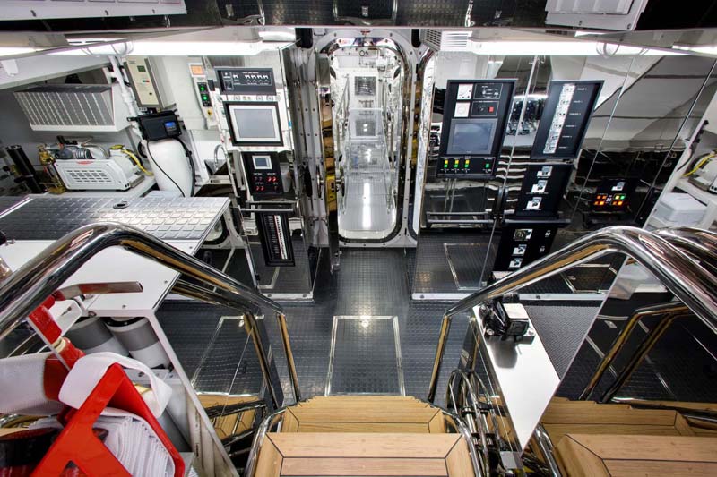

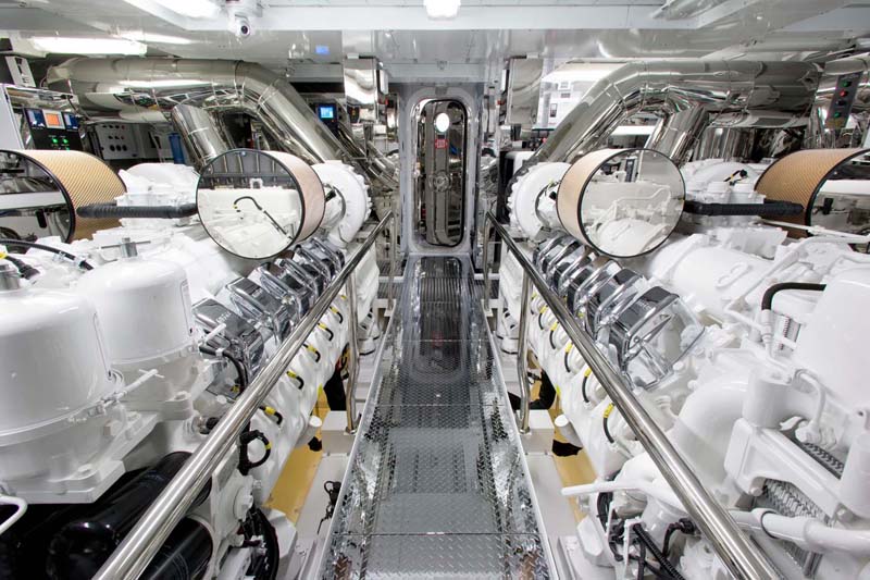

    Awww, come on guys. A "little Chrome" never hurts! I was responsible for this house of mirrors as the build engineer. 2nd engineers job was to walk around the engine room with a roll of paper towels and Windex...

    my point exactly - looks very nice when you lift the hood. In your case - excellente!

    Unfortunately this Christensen was one hull behind the "King of engine room mirror stainless" John Staluppi's Casino Royale and once the owner of Odessa peered into his house of E.R. mirrors the die was cast for hull 34. Couldn't say no to the man paying the bills and convince him that a little stainless goes a long way with copious amounts of Snow White Awl-grip. Tried to talk him out of 50 % of it but failed. Odessa is ten yrs old now and a charter horse but the engine room still looks decent.
