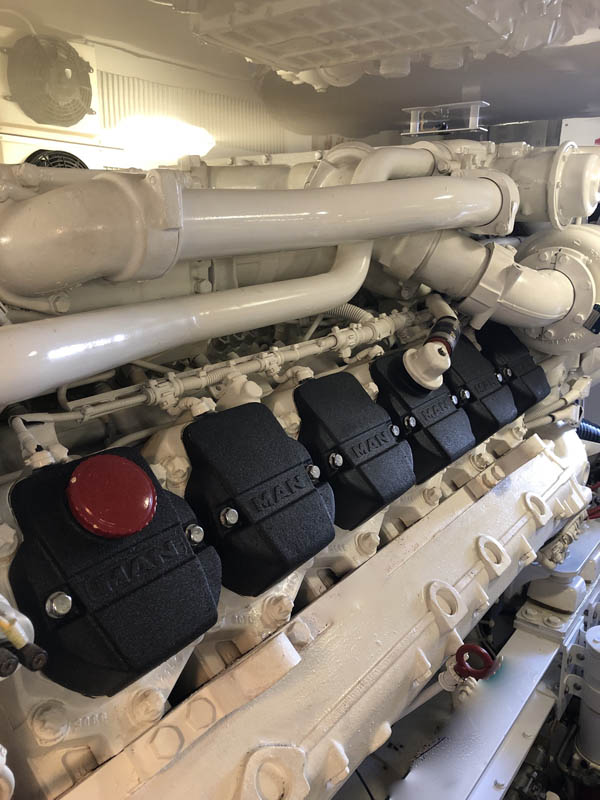

    I just saw this. I redid my MAN covers and looked at all options. To have them rechromed correctly is very costly. I looked at wheel shops, guys who did Harley covers and other options. It was $200-250 a cover to do it correctly. I ended up doing black wrinkle powder coat and even then I ruined a couple of valve covers getting it right. It's looks great and should be much more durable.

    They are $225-275 each depending on if they have the oil fill/breather. Gaskets are about $12 each. The prep for chrome is very difficult and can be impossible if they are badly pitted. The wrinkle finish hides a lot.

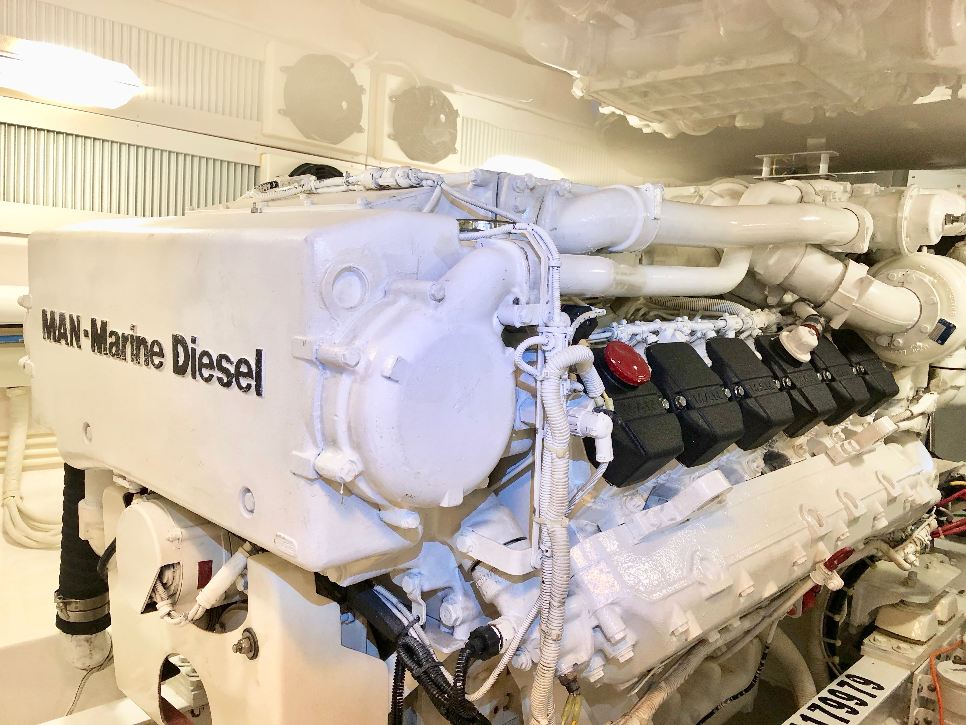

    A bit of follow on from the valve covers. Full detail in the engine room after the 1000hr service. I had two years on the heat exchanges and 4 years on the after coolers. Both looked good visually and tested fine. The only surprise was a broken manifold bolt that cost maybe $1000 extra to drop the manifold and repair. Did the sea trial and temps are exactly where they were before but I know it's clean as a whistle and good to go.
    The major service took about 2 weeks plus a week for detail and a week to find the right conditions to sea trial. I waxed the walls and ceiling. Did HVLP touch up on motors as needed.

    Looks excellent. Looks like a very nice ER, too. What hull? I've been looking at the possibility of a dark blue wrinkle coat

    It's a Viking 56. Really good working room.
    Blue wrinkle would work great. The keys I learned are to not let the inside of the cover get blasted and use a medium wrinkle finish.

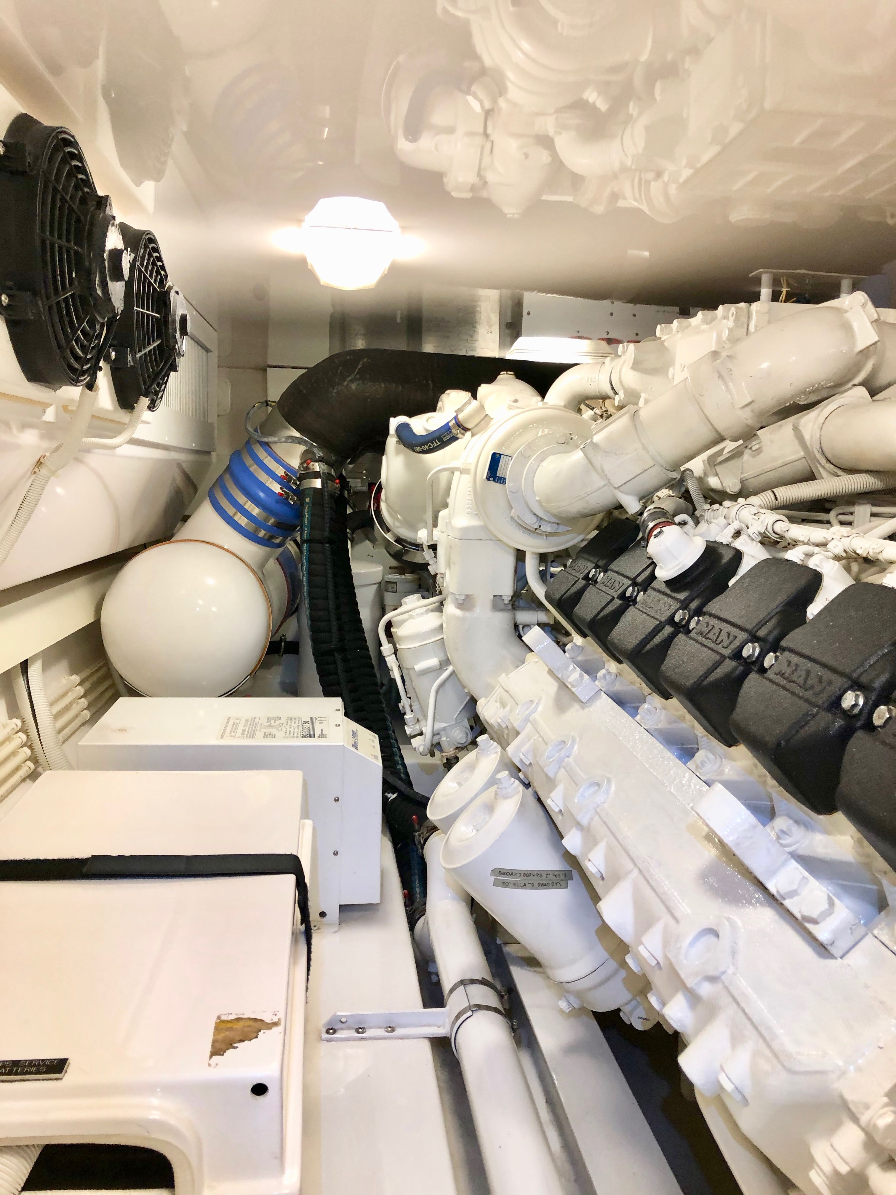

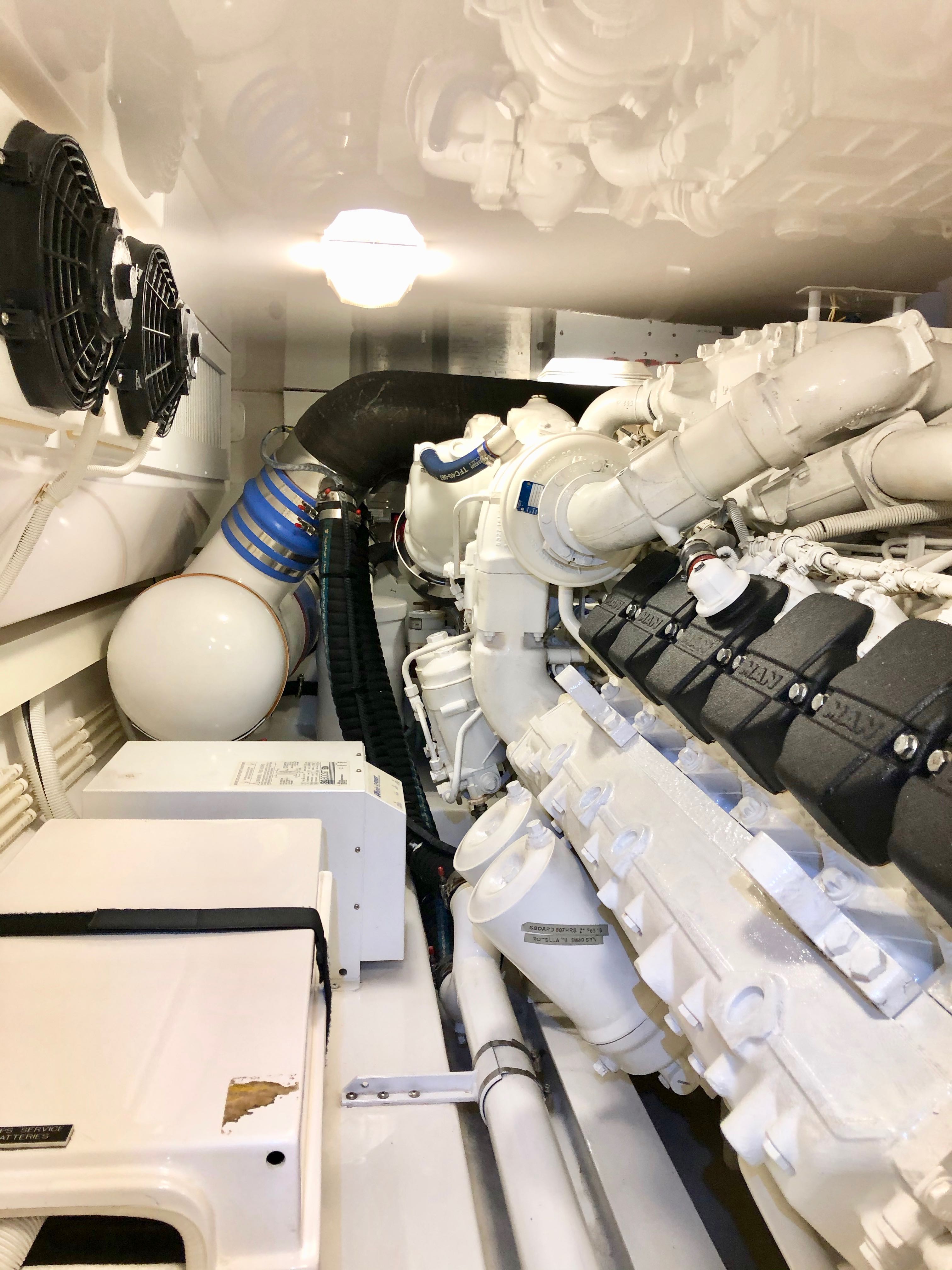

    The motors are 2006 CR1550 with about 970hrs when I did them last spring. The outboard ones were the worst. Picture of the outboard side now. If you have MAN's and want to go through this send me a note and I can fast forward you through it. I ruined three covers my tech gave me and spent about $400 to figure it out. I've got pictures of the ones I screwed up too.

    Interesting that Viking didn't move the oil filters to the inboard side?
