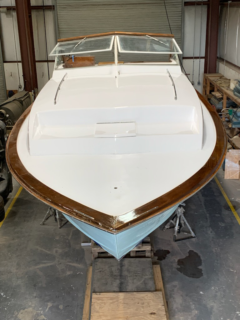

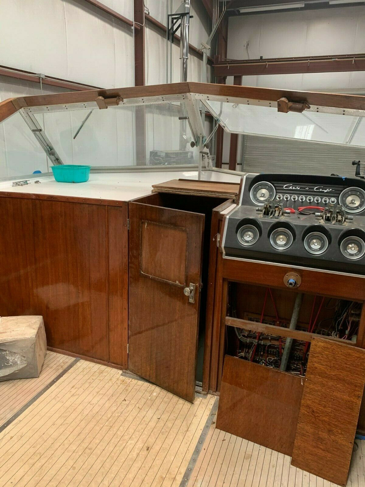

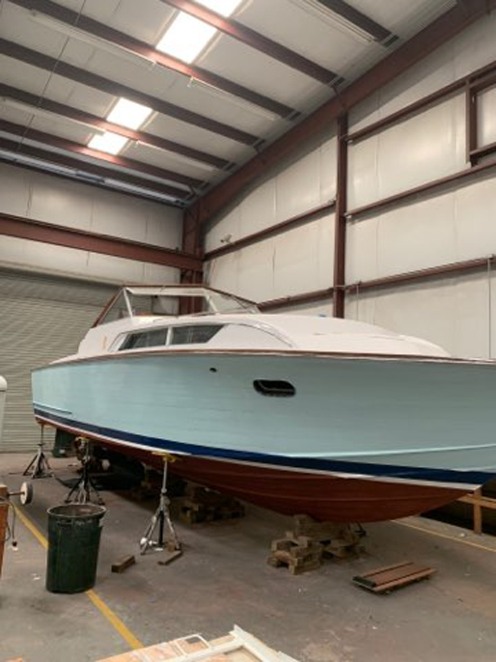

    Well, I decided I loved it, so I bought it! It's more like a giant speedboat than a cruiser. As I mentioned earlier, the PO had disassembled much of it to repaint the hull, but the engines/V-drives, generator, and most of the systems are still in and in working order. The wood is actually in very good condition, although totally dried out due to sitting in a warehouse for six years. I'm taking advantage of this to strip and treat the bottom with CPES and barrier coat in an effort to preserve the hull for a while longer. I was wondering if anyone whose on this forum still has one of these? It's hard to find any information (pictures, etc.) and it's kind of like a big puzzle right now. Lots of boxes and piles of shelves, doors, etc., so if anyone has one and would be willing to share some information, I'd really appreciate it. Here's a couple of pics... Fo'c'sle0.jpg StarboardSide.jpg Bridge.jpg

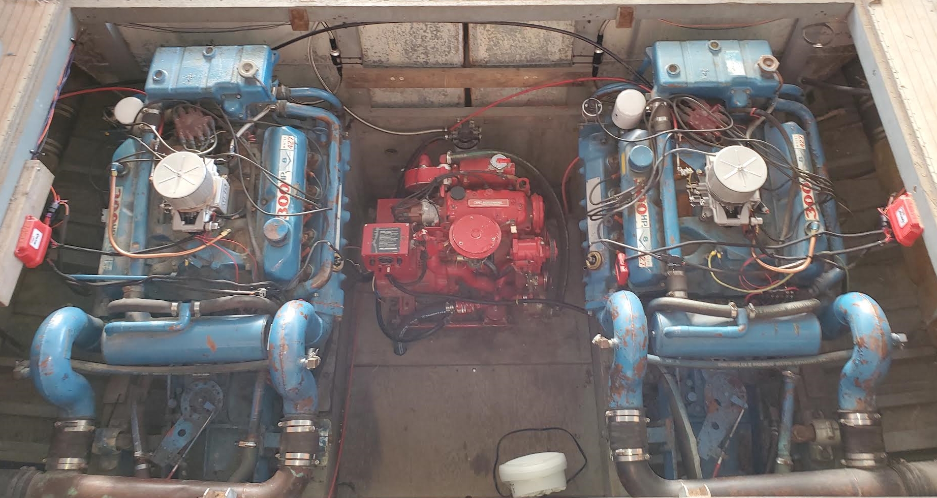

    Hi All, As I mentioned earlier, I went ahead an purchased the boat, and I've got to say, the more I work on it, the more I love it! After I bought it, the P.O. let me work on it in his warehouse for a few weeks since I didn't have any place big enough to store it, so I had until the first of the year to get it ready to launch. I did the best I could on the hull in that time and launched it on the 23rd of December. It didn't sink! is di take on a serious amount of water, but it has since slowed down quite a bit, so I'm hopeful it will seal up soon, I the mean time, I decided rather than repower it, I would "modernize" the original 427 power plants by upgrading them both to fuel injection. I opted to go with MSD's model 2910 throttle body system since it has the option to control a variable speed fuel pump, thereby negating the need to run additional fuel return lines in the engine compartment. I've got to say, it is the best decision I could have made! they both start up right away, and run very smoothly, even after over six years of sitting in the warehouse. As you can see in the pictures, since they're throttle body injection, they look basically the same as when they had carburetors. They just run so much better! IO highly recommend this mod to anyone who wants to keep their original engine(s), but have a more modern power system. :) 2.jpg

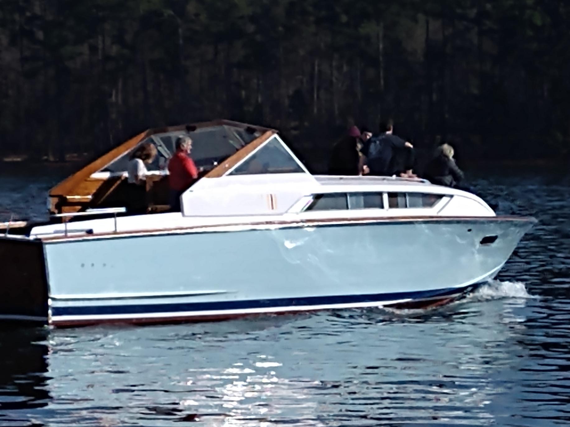

    Here we are on our first sea trial!

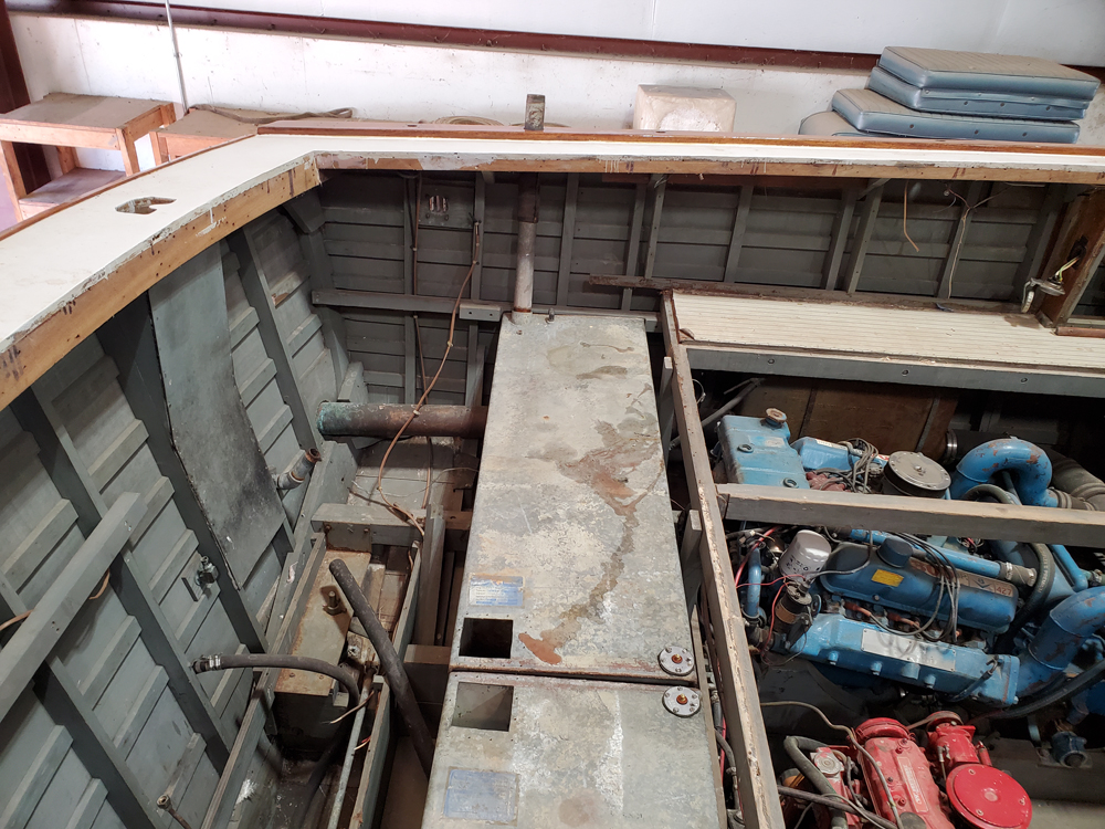

    Well, even though I did make the splash deadline, I only had one of the engines running by then. In the picture, only the port engine was running, so I didn't really get any speed runs in yet! Just two days ago, I finally got the Starboard engine running, but we're having some pretty nasty weather here in Georgia this week, so I haven't been able to take it out since I got both of them running. I'll update when I do. Right now I'm focused on getting everything functional and back together. The P.O. had disassembled much of the rear deck to get the fuel tanks out, so now that they're back in, and the engines and generator are all working, I can focus on putting the deck back together. Here's what it looks like now:
    I do have all the electrical working now, including the shore power connection, which comes in quite handy since this boat is still taking on water while waiting for the wooden hull to expand fully. Those bilge pumps ae getting a workout!
