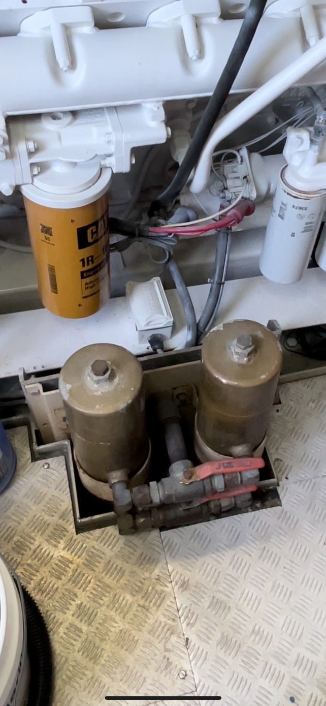

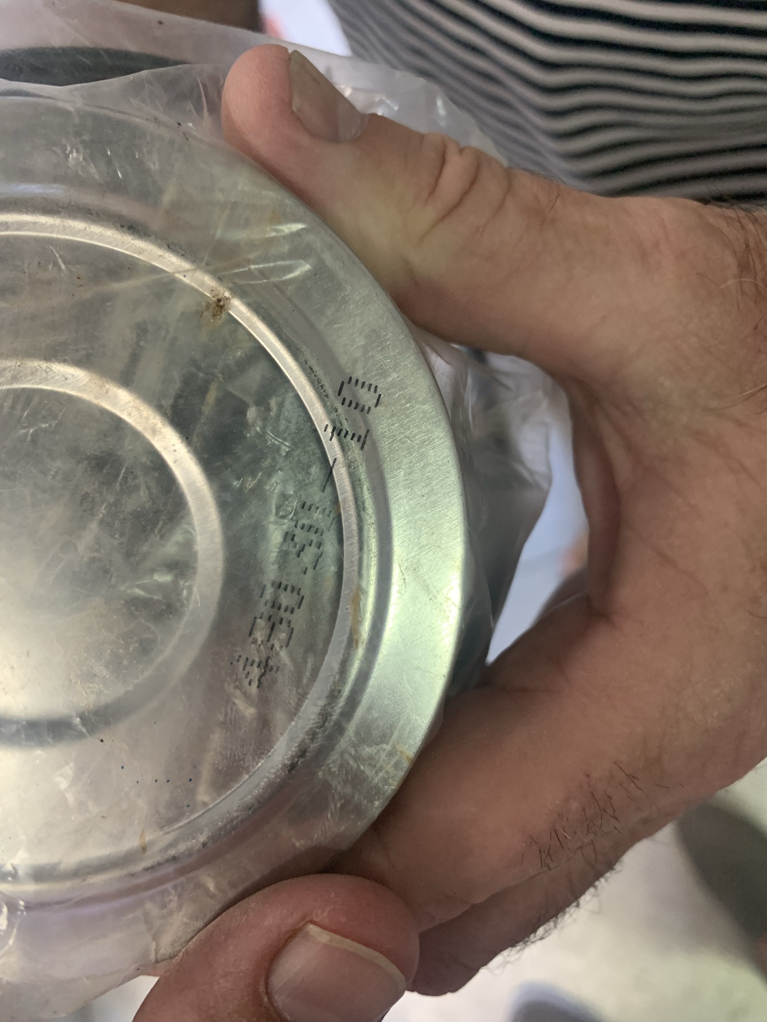

    90F0F607-5EA9-486C-861A-91DD46397A3D.jpeg YI bought an 80’ custom motor yacht which has 2002/2003 Cat 3412s and it came equipped with Racor Water Separators. We had a couple of spare 48030-10 elements on board.
    We are now looking for replacements but are now finding they are obsolete and not available.
    Would anyone know where I might find a case or an aftermarket replacement?

  7. Capt Ralph
    12,748
    You may have the old Dahl filter.
    Parker / Racor did purchase that company.
    Part number may still be good, Amazon even has it.
    Give us the model number or a picture of the filter assembly.
    Your purchase survey should have this info.
    From there, The later part numbers and what is available can be had.
    It is a 10 mic filter, I'm thinking it may go to a generator and not the main engine.

  8. Pascal
    8,166
    You re right. That metal frame looks like an Dahl but they were wider. At least what my boat had when I bought it.

    The 10 Micron was being used and I assumed I would stick with it. I cannot find the 10 or 30 micron elements. I am told they stop making this series???. Didn’t want to change out the entire Racor system but may have to.
    I am not near the boat. The service company sent this picture of the housing. It’s painted with no numbers.

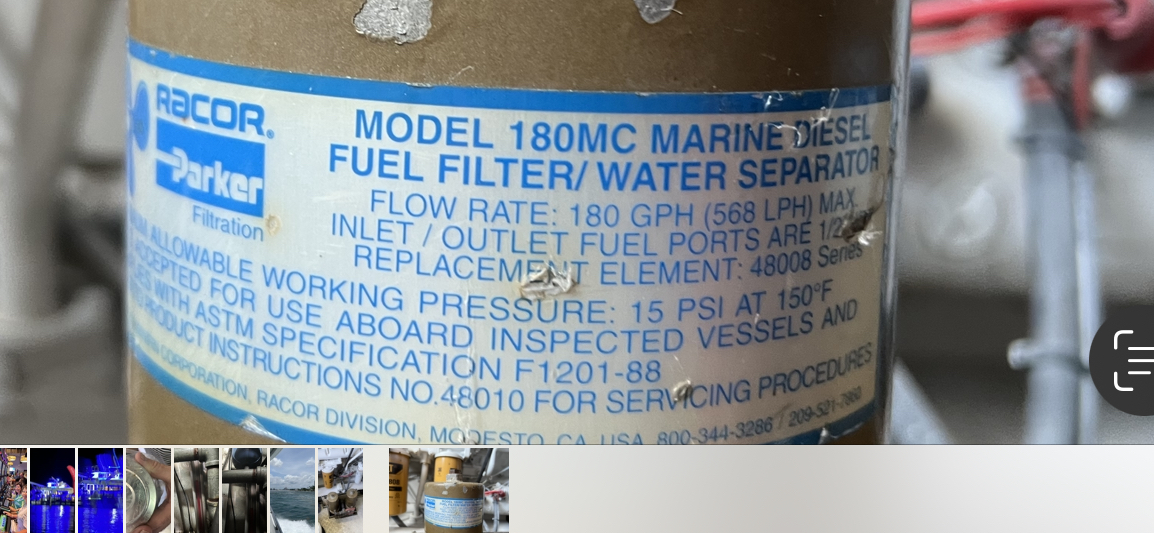

    This from the survey; Racor 180MC duel fuel filtration and water separator units serve main engines.
    Selector valve set at filler.
    Racorstore did not recognize the 180MC or the 48030-10. I have an email into Racor Tech…,I just got this pic from the boat surveys
