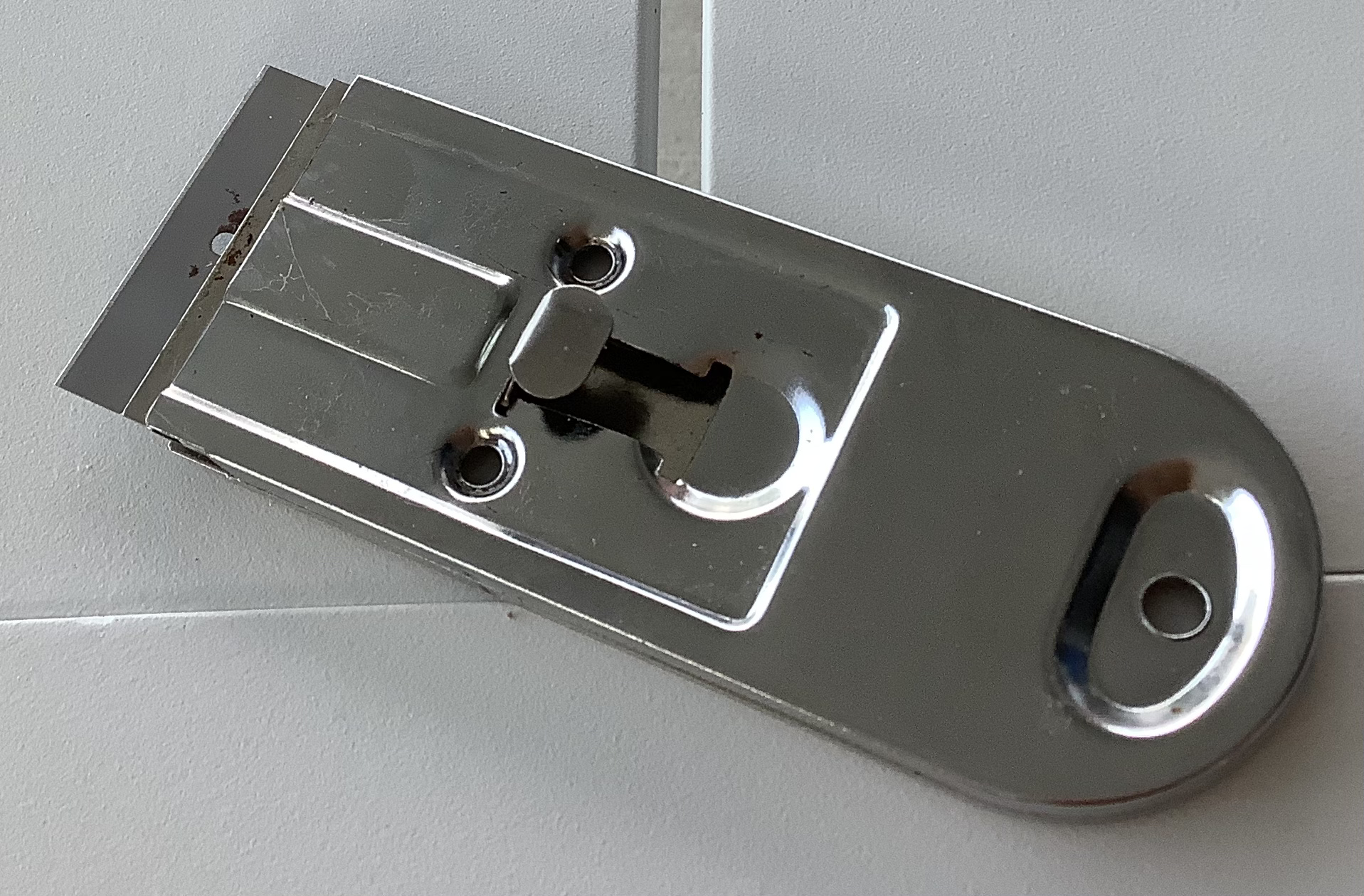

    Well there's another ouch. I was thinking a razor blade scraper like you use to remove stickers. Push it in and rotate left and right. just add patience. Lots of patience, but not finger nails.
  2. Norseman
    Norseman Senior Member
    Feb 24, 2005
    3,582
    Palm Coast, Florida
    Yes, I know what you meant, got 20 + years as a boat owner, been there done that in many cases, but always learning new stuff, or re-learning because I am not as smart as I look. :D
    Here is the razor blade tool I used trying to remove good old 5200:
  3. NYCAP123
    11,209
    Yep that's the one. But did you add patience to it.?:D
  4. Norseman
    Feb 24, 2005
    3,582
    Palm Coast, Florida
    I did, I tried, but the darn 5200 is like a bullet proof rubber band, can’t pull or cut it..
    Some patience, but had to lay on the dock, at high tide trying to clean the surface for the new fitting.
    A labor of love, I am telling you..❤️

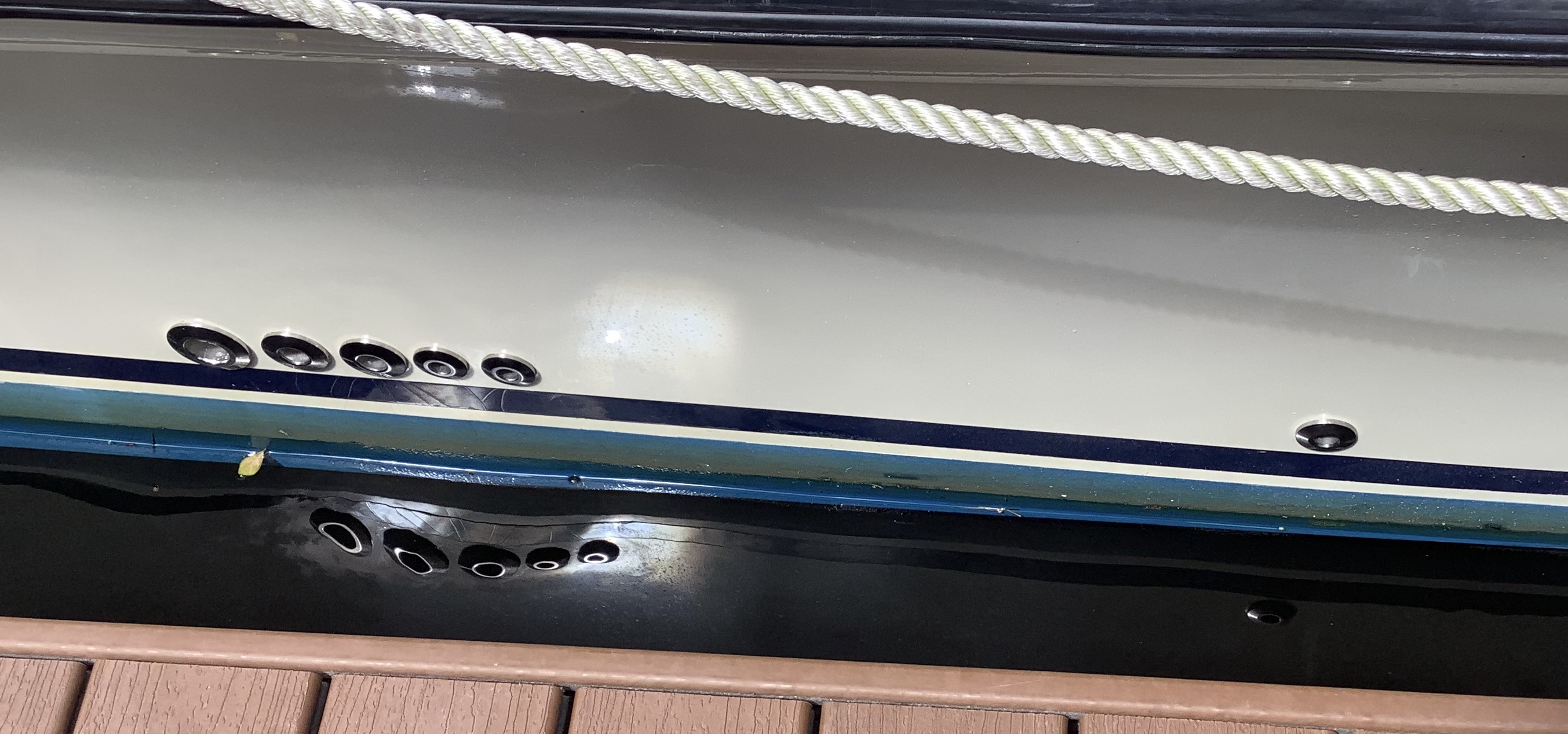

    Easy there Tiger: I did not remove and re-bed these things because I was bored and had nothing else to do...
    Hauled the tub June last year for a bottom job and a prop change.
    Also called a surveyor to come and sound the hull, check for any water intrusion and/ or delimitation.
    He found some moisture around these mushroom through hulls, nothing big, but he recommended I re-bed them some time in the future.
    Well, the future was yesterday and I pulled all 6, replaced 4 and re-bedded them all.
    Now I sleep better and life is good.
    (The hull is solid glass glass right there, I thought it was cored, hence I did all that to make sure nothing bad was going on. :eek:)

    More than by the sealant used, I'm rather puzzled by the surveyor suggestion.
    Ok, he found some moisture around those thru-hull, but so what?
    I'm very skeptic that anything will change after rebedding them, to be honest.
    Unless the hull above the waterline IS indeed cored, as you expected.
    If you said that it's instead solid just based on how it looked inside after removing the mushrooms, it's possible that it was glassed solid only in a small area designed for fitting them, but it's actually cored all around.
    Which could also be the reason for high moisture reading nearby, because while I don't think the mushrooms per se were the culprit, their different thermal behaviour could facilitate the formation of some internal condensation nearby, within any possible air bubbles left inside cored areas.
    Then again, also in this case I wouldn't hold my breath for any post-rebedding improvements.
    Who built the boat, and how old is she, if I may ask?
