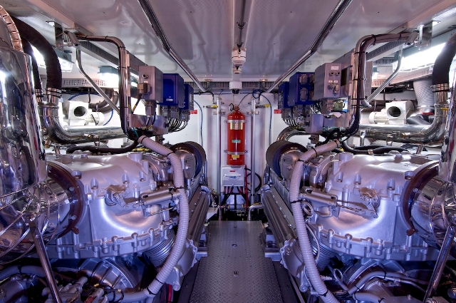

    An example of the MTU engines and fuel tank forward

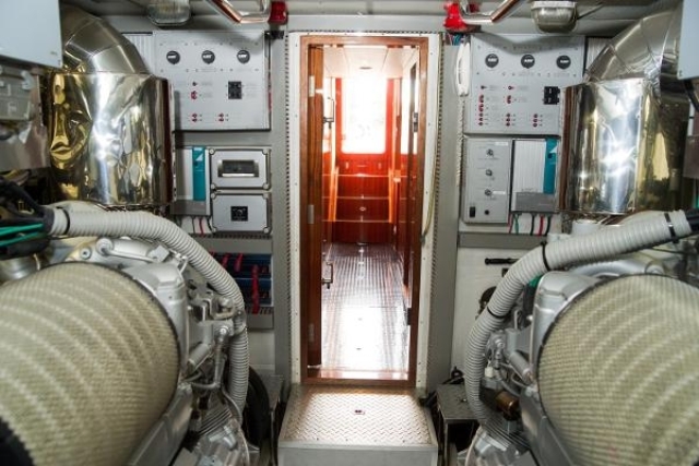

    The same engine room with MANs and side tanks

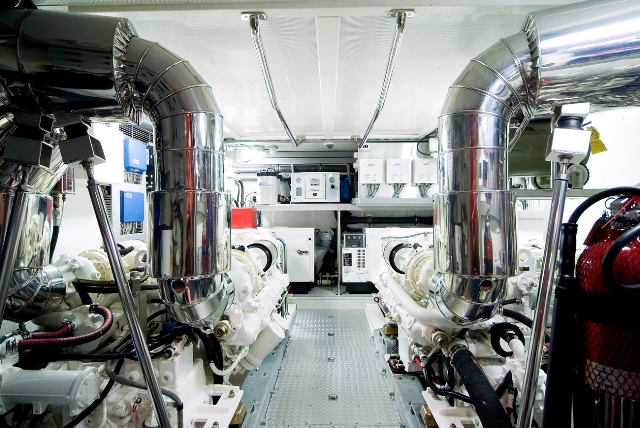

    Below, you will see the engine room of an Elegance 86 with MTUs and perfect access. The whole area behind the engine room is crew area with an access staircase from the Bb sidewalk and the salon plus transom door. In comparison to some Italo plastic fantastic, this is crews heaven :).
    And I do not believe, that is bad installation of technical equipment. And the size of the engine room is determined by the choosen layout of the buyer. And for an only 6 m beam semi displacement boat (must have been be a 74 0r 78 E-class), I would choose MANs.

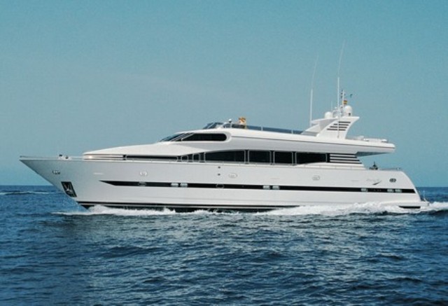

    Those beauties were called Asian Baroque some years ago in the Med :). And so was the interior. One of them can still be seen in Poto Portals.
    And this, I would call a fine example:
