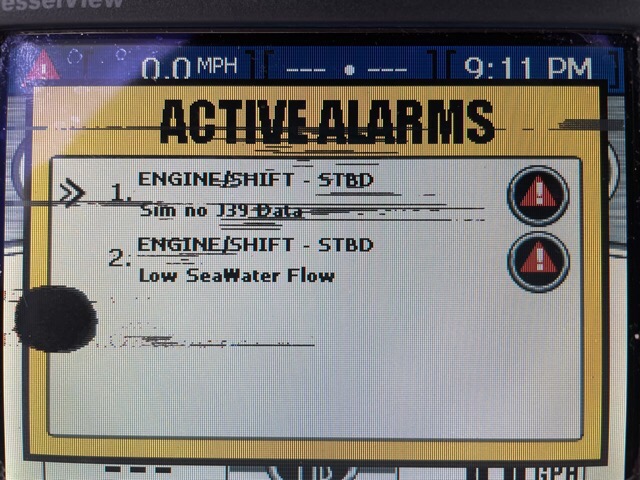

    The diesel shop came over today and did a flush of the raw water system and when I started the engines after the flush I got the error below.
    EMGINE/SHIFT STBD
    Sim No J39 Data
    then after a 30 seconds or so….
    ENGINE/SHIFT STBD
    Low SeaWater Flow
    Tech said low seawater flow was just because of the flush process but didn’t comment on the ENGINE/SHIFT.
    I can shut off the errors and in they seem to come back randomly.
    Engines start fine, shift fine, and all data seems to be present on the VV and analog gauges. We are leaving Ft Lauderdale on Saturday headed to MD.
    Headed to the diesel shop first thing. I have to return the rental car at noon. This is stressing me out.

    He didn’t do the typical circulation flush. Just removed the strainer cap, poured in 2 gallons with engines running and replaced caps. Let sit for 45 minutes and started engines. Errors appeared then and appear every time I start. I don’t get the no sim J39 data error. If I had no sim data I would have no data on the display.

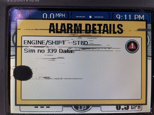

    Here is the first error….
    And the second…

    It was done on both sides. I know the normal way to flush is to circulate. He said they do it that way if the engines are overheating. I’m my case, the temps were OKbut I was getting a low water flow alarm. He said that this is the way they do an engine flush just to give it a good cleaning when it’s not overheating. He said they do it a lot as part of annual maintenance just to keep things clean. Whew we restarted mine a lot of brown gunk came out.
    So the final diagnosis is interesting. I called this morning and sent the pics of the alarm screens so he came over and replaced the stbd impeller. Same alarms. He went to the water flow sensors and found that there was no sensor on the stbd side and a screw was in the hole the sensor probe goes. The wires to the sensor were shorted together purposely. When he separated the wires the alarm went away. Haven’t seen a low water flow alarm since. They didn’t have the sensor in stock and I couldn’t wait. Leaving tomorrow and will replace sensor when we get home.
    ‘The “sim no J39 data” error is still there but not as frequent and it is not an alarm. Just a warning that reads across the top of the screen with a yellow triangle. It will appear for 10 or 20 seconds then go out and back to a green OK. I unplugged the sim cable, SC display cable and any others I could find and reach, sprayed with WD40 and replugged. Going to talk to Seaboard when we get home about what they have to replace the SC system. Cummins tech said upgrading the VV]I have to the latest and greatest would be worth it. I’ve heard that VV mobile works pretty good too. Problem with the VV upgrade or VV mobile is that they retain the same wiring harness. I think the SMX system does away with the SIM and comes with all new harness from engines to bridge.
