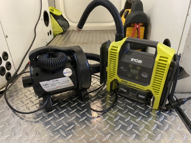

  14. Pascal
    8,166
    8x10 Shouldn’t take that long. It takes like 10’ to inflate our 4x26 Mission. It’s about 5” thick. We use the black pump in the picture for the float. For smaller things we use the ryobi. It s huger than your link, model P747
  15. Pascal
    8,166
