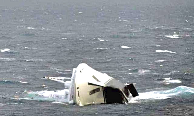

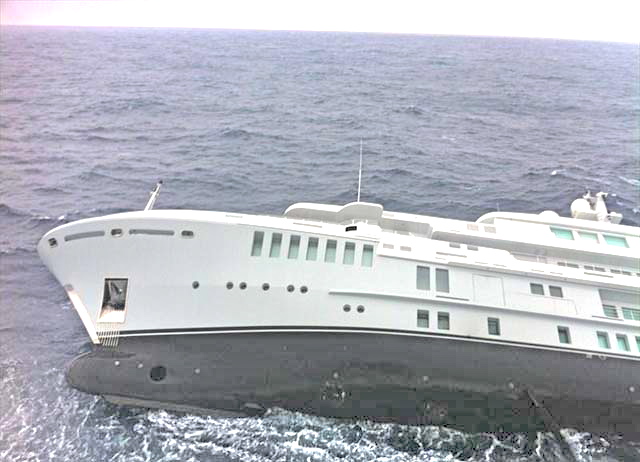

    I have lightened up the pictures posted here and it looks like it can be two dents forward of the stabilizer..? Submarine..?

    Or a container might have sunk after the impact?
    There are so many of the things floating around the oceans that the likelihood of hitting a submarine are probably less than that of hitting a container.

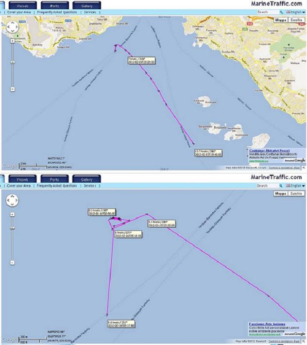

    The 8 crew are part of the regular crew on board, all of whom are french. They were managing a trip from a scheduled drydock service in Turkey towards berth in Greece. According to AIS info, they were running in stealth mode during the time of the incident, the first call was made at 00:30hours (Hellanic coast guard time) and because of the bad weather the rescue attempts were started at 07:30, and the manufacturer was informed during the 7 hours waiting time of the incident, as you might have read from the words of their spokesperson, the bellows broke off but there is a shut-off valve right underneath. Another thing mentioned in the primary reports is that the captain was warned of bad weather (which I don't think would cause such a disaster on its own). Under the waterline of the ship there are two aft holding tanks for the swiming pool located aft on the weather deck. A crazy chain of events is the only comprehendable cause at the moment for not one cause on its own (all but God's will) could take this boat down.
    All the crew are well trained (as publicized) and have operated the ship during the last summer charter season in the med.
    Attached is the last route and position of Yogi before going stealth, it shows an anchorage a day before the incident which a guess was the resting point for the crew that many are viewing as not adequate and I personally see as enough for the job if well planned like any sea trip should be.

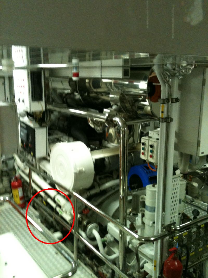

    This is what I usually see (not always) on modern 150+ yacht with 3500 series CATS.
    Follow the raw water discharge off the sea water cooling pump and the pipe splits. One branch goes to supply the gear box heat exchanger and maybe a fuel or oil heat exchanger as well. Follow the other branch and it leads to the after cooler. From the after cooler the raw water goes to the engine coolant heat exchanger and then the raw water cools the exhaust. The after cooler is the first place that gets blocked up when you have issues of unwanted muscle invasion or trash getting through your sea strainers. There still may be enough water flow to keep the engine from alarm point for a time, but not enough cooling water to cool the hot exhaust gasses that is making contact to that rubber bellows in the exhaust system down line. The rubber bellows becomes the weak link and the high water bilge alarm or fire alarm goes off first and then your whole day gets ruined.

    If these were really modern 3500 Engines you will find the FO Cooler is not in the SW System

    2010 44 meter Benetti Vision. 35 series CAT with a fuel oil heat exchanger sea water cooled circled in red.

    Also not to mention that the fwd plate coolers on the modern 35 series that are sea water cooled are used to cool the fuel oil as well the engine coolant but I am not here trying to show how big my **** is.

    To avoid confusion the point I was trying to make was any fouling of the plate coolers will cause the whole engine a problem as everything is integrated.
    On a properly setup and installed one there will be a number of set points in the AMS that will draw your attention to a problem long before it leads to sinking the boat.
    Just because Benetti cheaps it out don't assume all builders do it.
    Even though it is called a 2010 Model, do you have any idea when the equipment was made?

    It looks like your avatar picture is of a 35 series sea water cooled heat exchanger that cools both engine coolant and fuel oil HAHAHA! I am sorry you put your foot in your mouth with me today

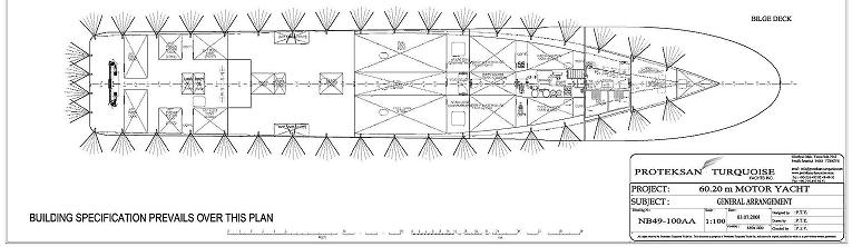

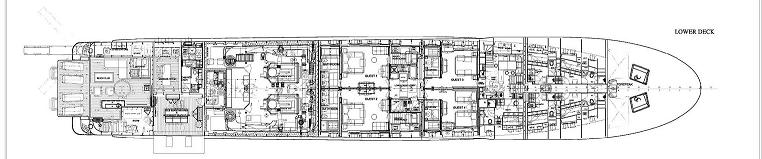

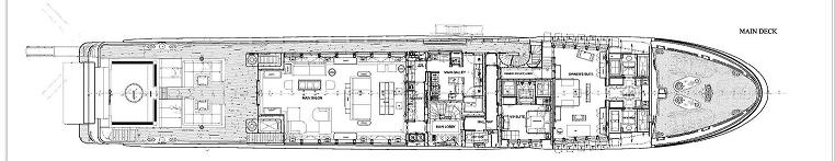

    One question if I may ask, between the initial mayday and the rescue was a long period of seven hours, and I assume that the mayday was not initiated because they THOUGHT this will happen, they called because it has already happened! So, how long before that do you think the problem started for it to become beyond saving the day at the time of mayday? Then, as I think, the bellows problem is not enough to cause the flooding of the water tight compartment on the weather deck, and this engine room had 3 pumps, and both engines (or at least the functioning one) could be a fourth pump. There is for sure a more major factor than this that led to this catastrophy, any ideas? Some other forums are talking about the waterline glass frames giving way under pressure! Still not so convincing though arguable.
    Attached are the plans for the bilge, lower and main decks. (In a later post, because the size is rather bigger than 100k's!)

  18. AlfredZ
    AlfredZ Senior Member

    Hi all,
    Here are the plans in JPG format. Hope you find them helpful to finding more clues or guides.
    Cheers.

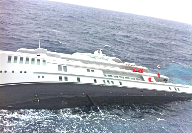

    Is it possible that Yogi could have lost her large side windows (near the waterline), when/if she turned side-on with the waves... with a lose of power she wouldn't of had use of her stabs, and she would really start rolling...?
    Personally I can see **** really hitting the fan when those windows blow out, and really adding to there problems. (Speculation)
