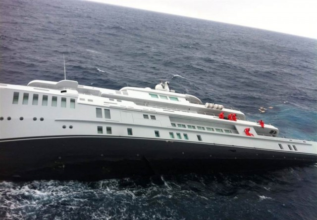

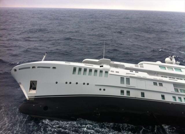

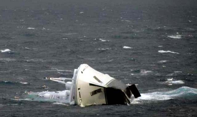

    It is a sad day for Yogi which sank this morning due to mechanical failure. All crew were safely rescued by helicopter.

    What was the mechanical failure that caused it to fill up with water uncontrollably?

    It has been reported that Captain Jean Louis Carrel said when asked about the weather conditions effect on the incident, "No, it was [down to] engine problems. It was the exhaust of the engine."

    Unreal they didn't have enough pumps to handle an exhaust.

    Look at the size of that yacht, its not a question of a simple minor exhaust leaks and a couple of pumps short.... please lets not start taking this to the direction of assumptions. The yacht was built to class and certified, it is a ship, a commercial vessel, built differently than what most are used to... Unless there was some gross negligence on the part of builders, designers and certifiers all together, this is a huge pile-up of mis-haps... not a question of "unreal they didnt have enough pumps"....
  12. Pascal
    8,818
    Well, judging by the outcome, stating that effective pump capacity was less than the size of the hole is not speculation...

    Saying that it is unreal without knowing the size of the hole is...

    Anyone in the business will be speculating/theorizing on this one . . . .
    The take that keeps on coming back to me - accepting the (supposed) comment by the captain naming the exhaust as the culprit - is this:
    First, a boat that size will have a highly qualified crew, and whatever happened was beyond the crew's capability to bring under control in a timely manner. This would indicate an unexpected catastrophic failure.
    Underwater exhausts generally have a riser coming up from the hull to which the main exhaust hosed is attached. Said riser is generally a couple feet long, but the coupling between riser and hose is still at or below waterline, if I remember correctly. The riser/hose for that size of yacht might be +/- 14" diameter. OK, hose breaks away from riser, you still have the riser in place to cap off and one engine left to run on. If, however, the riser shears off close to the hullside in a manner in which it can't be quickly capped off then you will have an enormous and effectively uncontrollable quantity of water flooding the engineroom. Things then get really ugly really fast . . .

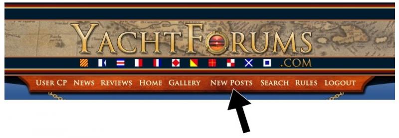

    Hi Far, since you brought it up, I have a question; Is it only me who have this header where you can check New Posts..?

    I have it too, never used it till now. "Galileo G" looks great by the way, thanks YachtNews. I'll use it in the future for sure. Cheers
