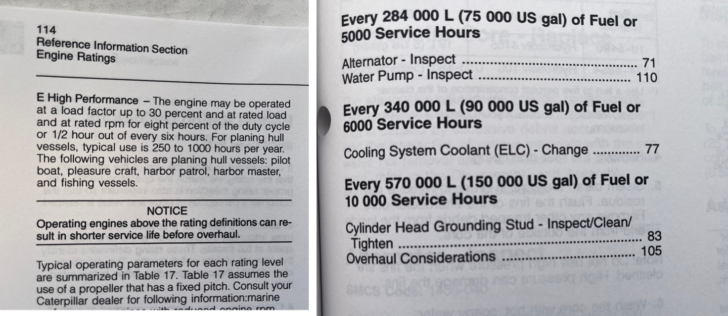

    I have looked into this quite a bit over the years. I had CAT 3208s for 16 years and now C18s. There is the common folklore about running modern diesels at 80% load for long distance cruising. This is not what CAT recommends in their literature. Most of our CAT boat diesels are E rated engines. The following is the typical wording used throughout the CAT operations manuals and literature:
    E Rated Pleasure Duty
    • For infrequent use in variable load applications where full power is limited to one hour out of every eight hours of operation.
    • Load Factor: Up to 30%
    • Typical Annual Operation Hours: 250 to 1000 hours
    • Typical Hull Forms: Planing
    • Typical Applications: Pleasure craft, harbor patrol boats, harbor master boats, some fishing or patrol boats, sportfishers, motoryachts, and cruisers.
    That means limited WOT running at rated load and rated speed up to 8% of the time (up to 30% load factor). But this load factor is your average load factor to achieve the CAT service schedule which is 10,000 hours for a major on C18s.

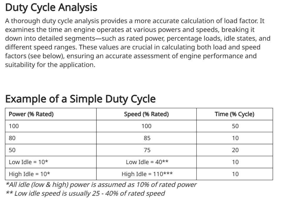

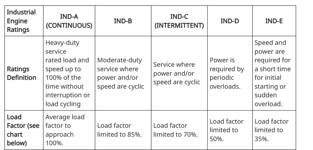

    From the CAT literature on industrial engines that are actually a bit derated from our marine engines:

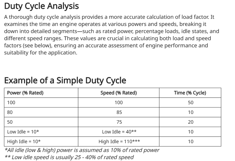

    The load factor is limited to 35% for the average over all use not just WOT full load use. And next again from the CAT documentation is an example duty cycle for a D rated intermittent duty engine. This engine has a 50% duty cycle rating with a typical duty cycle shown:
    This seems to me to be clear guidance from CAT on where the average engine load needs to be for long distance cruising. Also my CAT C18 manuals clearly provide guidance on my cruise RPMs and say I shuold cruise at 1900 to 1950 which on my 68 ft Viking Princess is a 65-70 percent load.

    What I posted above is not CAT C18 specific. It is the load and duty rating guidance across many of the large CAT industrial diesels including the C15, C18 and C32.

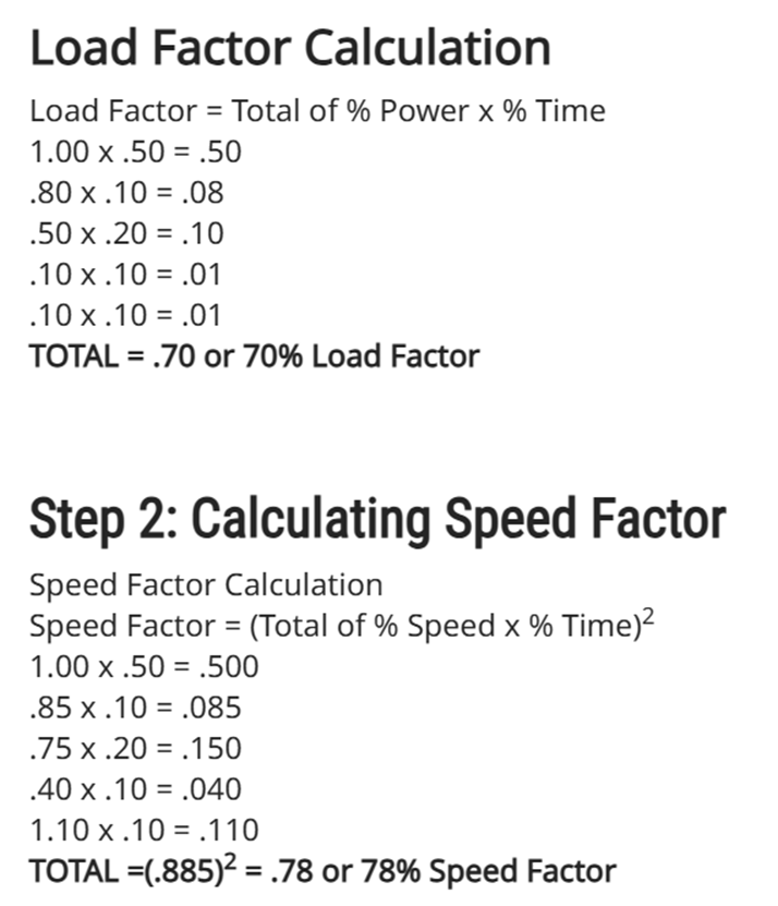

    What I posted has everything to do with load at cruise or continuous load. What I posted is also directly copied out of CAT literature and not from random mechanics or dock folklore. The images I posted directly show that when CT says 30 percent load factor, that means the average load factor should not exceed 30%. Other than the 8% of 100% WOT operation, you cannot just go to 80% and run forever. That gives an average load factor of way higher than 30%.
    The following show how to calculate load cycle and ratings. Again directly out of CAT literature. Your Cummins example seems to say exactly what I am saying as well. Yes HO can do 1 out of 8 hours but the average load factor should be 10-30%. In my post above, look closely at the duty cycle figures, these show the WOT but also what is needed on average when not at WOT.

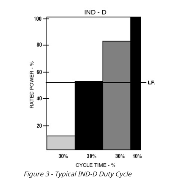

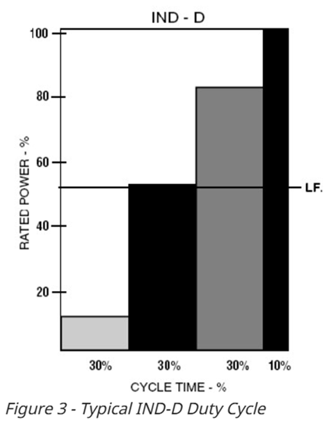

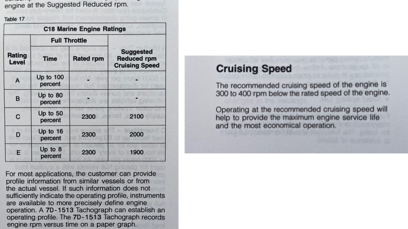

    Let me try to make this a little simpler. CATs D rated engines say the following. Look closely at the figure which shows what needs to go with 10% WOT for a D rated engine. If your 80% all day to be correct, would require a B rated heavy duty engine.
    From CATs literature for D rated engine:
    Load factor limited to 50%.
    Time at full load not to exceed 10% of the duty cycle or 30 minutes max, followed by one hour at Intermittent.
    (see Figure 3 for typical IND-D Rating Duty Cycle)

    You are comparing apples to oranges. IF you look in your CAT manual it will state that you can cruise your E rated Caterpillars at 80% load all of the time. An email to Caterpillar USA will tell you the same thing. I don't know where you are pulling your information from, but I have done several hundred NEW CAT engine start ups on all E rated diesels with many different CAT dealers and have done some seatrials with Corporate CAT as well and they all state 80% load as CONTINUOUS (cruise) speed. I don't have any CAT manuals handy, but 80% load or less continuous is what the E series are rated at, and WOT 8% of the time. It is not some weird average that requires plugging in the CAT ECM to figure out. Instead of pulling all kinds of information about offroad heavy equipment, pull out your manual on YOUR marine diesels, and tell us what it states.
    The cummins literate state continuous operation at 80% load or less. NOBODY pulls the average and does math. Rated Cruise is 80% load all day.......... same with MAN, Cummins, Yanmar and others. Volvo rated cruise is 90% load.

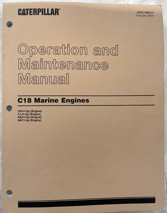

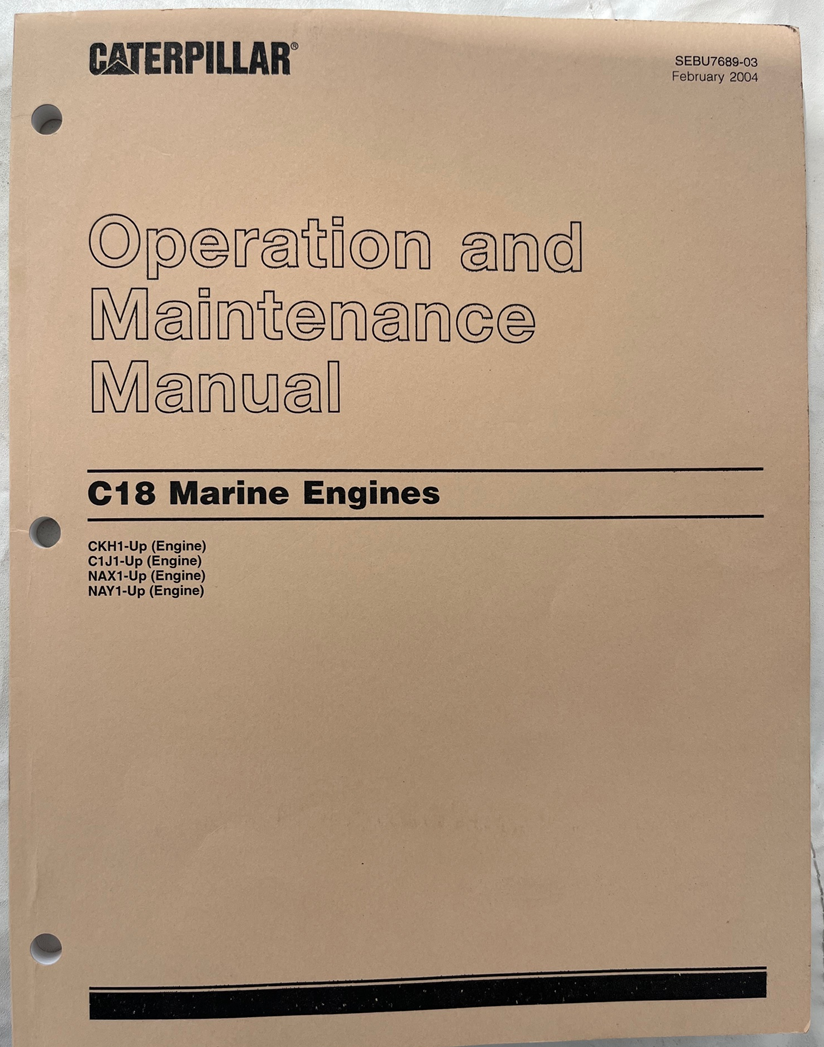

    I was on my boat this past weekend and went through my CAT C18 manuals and the guidance is as I posted above. These are the standard factory manuals. The images below all came from the factory C18 manual:
    As we know these are E rated high performance diesels. The factory guidance is that they may be operated at a load factor up to 30% or up to the rated load for 8 percent maximum of the duty cycle. The service schedule is based on total service hours or total fuel burned:
    There is NO mention in the operations and maintenance manual anywhere that says you can run at 80% load factor all day long. In fact the factory manual specifically lists recommended cruising RPMs which for the E rated 1015 and 1150 hp C18 engines is 1900 RPMs for cruising. In my 68 Viking Princess, 1900 RPMs is about 67-68% load factor.
    If all systems are operating properly, then you should be able to run at 80% load factor all day without blowing the motor up quickly, but you will significantly reduce your engine service life. As an example if you run at 25% load for 1 hour getting in and out of port and run at 80% load for 7 hours, that gives an average load factor of 73%. This is a 36.5 gal/hr average fuel burn compared to 15 gal/hr average you will see at 30% load factor. (This all assumes 50 gal/hour per engine at WOT) Running 80% load factor in this way will REDUCE your major overhaul service schedule from 10,000 hours to 4,100 hours.
    That is the issue with running 80% load most of the time, even if the engines are running and serviced properly, you significantly reduce the engine lifetime.
