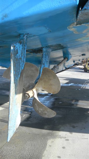

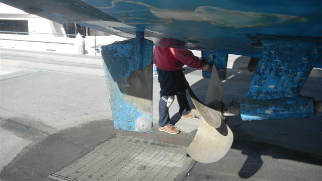

    I wanted to do this in a separate thread so as not to make my Repower thread too long. I'm starting a repower of my 54' Donzi and have determined I need to increase shaft size and thus will need new props. I'm looking for some real world feedback on good props. Boat is a 1994 54' Donzi Sportfish. It is getting CAT C-18s @ 1150 with ZF 665 gears with a ratio of 1.97:1. Existing engine are DD 12v92 1080 hp with 1.66:1 gears. Existing props are 28x37 4 blade. I do not know manufacturer of existing props. I am able to make full 2300 rpm with current props with full load and do about 31 knots. Cruising at 72% load at 1850 rpms currently yields about 20 knots with full load.
    I hear good things about Veem and Michigan. What about ZF wheels, Acme or others? Anybody running the Veem Interceptor with the pitch strips that are easily adjusted? I doubt I can go much larger than 28" diameter without getting too close to the hull. I'll measure tip clearance when I haul-out later this month.
    Pictures from older haul-out showing existing props:

    So I see a few things:
    That strut looks nice and massive, the barrel looks plenty long enough to take a longer cutlass bearing, hoping you can get it bored for the bigger shaft? Are the bolts accessible from the inside?
    The gap from the forward propeller face to the aft face of the strut barrel looks too large, normally 1 x shaft diameter (2-1/2”) is max, 1-1/4” is preferred. You can adjust the overall shaft length on the new one to take care of this issue, double check before you order.
    The thin jam nut is in the wrong location, it should be first and then the large nut should follow, about 50% of the shipyards seem to get that right.
    Minimum prop tip clearance range for a non-tunnel design is typically 15% - 20% of the prop diameter. So for a 28” prop, that is 4.2” to 5.6”.
    Make sure your new prop is setup for a Propsmith puller tool.

    These photos are old from when I bought the boat and surveyed it. All paint was removed and redone. The prop nuts are now in proper orientation. I’ve been aware of too much shaft exposed between the strut and prop since I bought it. We had planned to either cut the shaft or set new engine fwd a bit to draw shaft in closer. Now that I’m going to new shafts and props we will make sure it is correct.
    The strut bolts are reasonably accessible but I think we will just bore the strut in place. We have all the equipment and expertise to do this. This way we can do a straight thru line bore into the shaft log if I have to open that up a bit too.
    I’m skeptical of those Veem interceptors. Yes, it would be great to be able to make simple adjustments, especially in my case with new engines, slower shaft speed, lighter boat, etc. But those adjustment strips on the Veem don’t look like they would last very long. Anyone run these for any length of time? Veem advertises Cabo and Riviera as OEMs using them. Any others? What are Viking, Hatteras, Spencer, etc using these days?
