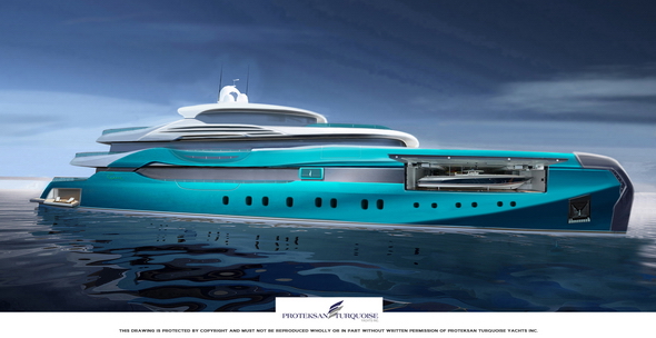

  1. Proteksan Turquoise 'Pro Plumb' 54-meter superyacht
    Proteksan & Turquoise showcases a new project of 54-meters LOA. This one has a plumb bow and unique styling. Round curves, bellied balconies, subtle aggressive corners, fold-down bulwarks and large forward tender garage help make this vessel stand out among other Proteksan boats.
    The wetted surface of the hull is pretty close to the LOA of the yacht creating balance and efficiency at the same time. 54-meters LOA and just under 53-meters LWL tell the story. The design will be pretty spacious with comfortable overall beam measuring just over 11-meters (11.10-meters).
    Fully loaded displacement should be around 1,000-tonnes and at half load top speed can be expected to be 16-knots while cruising is at 14-knots. 90,000 LT of fuel will feed twin 1911 HP CAT 3512B engines. Construction materials are expected to be Grade A steel for the hull and a hybrid Aluminium Alloy 5083 & Composite superstructure.
    A quick look at the design of the vessel other than the obvious plumb bow, the main tender storage is in the bow as well. Two large tenders are stored there and serviced via 'gull-wing' shell doors on either side. Accommodation below on the lower deck shows two doubles and two twins for guests.
    Looks like the master is perched just aft of the amidships area on the bridge deck enjoying balconies on either side of the room. Jacuzzi is up on the forward end of the sun deck and flanked by sunpads. Al-fresco dining table and chairs for twelve sit on the other end of the deck. Fold out doors on the aft end of hull jettison to create a beach-like affair and in conjunction with the spacious swim platform, there is sure to be good time near the water.
