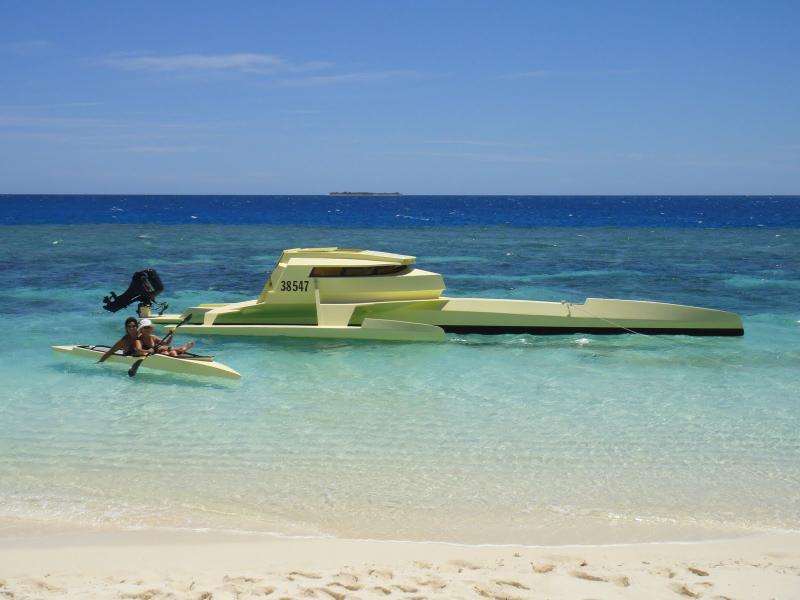

    So what does this 100 ft yacht with an 8' beam look like? I don't think you'll find many on the market :rolleyes:

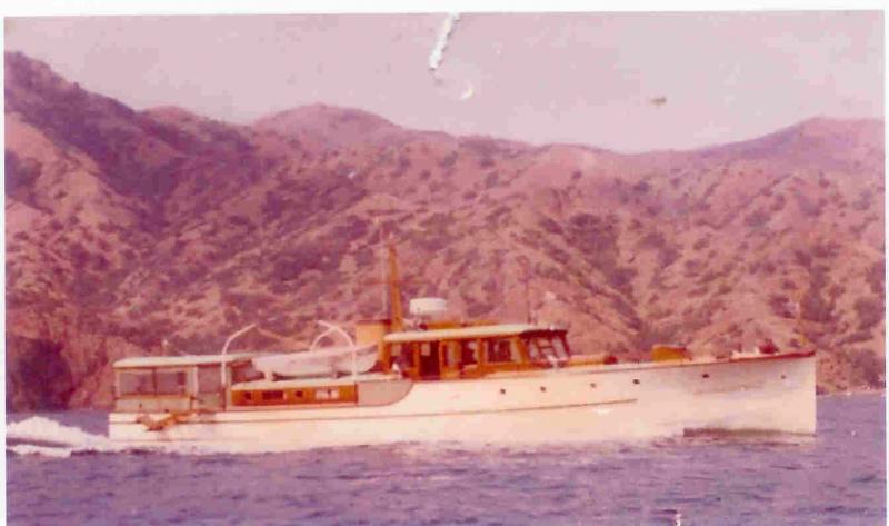

    Brian, I just plugged those dimensions into several regression models. As you know, the regression models really don't need much information about the shape beyond the dimensional (LWL, displ, ...) and non-dimensional (Cp, Fv, ...) numbers.
    However, there have been hundreds or thousands of boats built to similar dimensions, just not recently. The vast majority were built before petroleum and high horsepower engines became pervasive, e.g., before WW2.
    Here is a 63 foot Lake Union yacht from 1930, not too far from proposed, but of course heavier because built of wood. More to come...

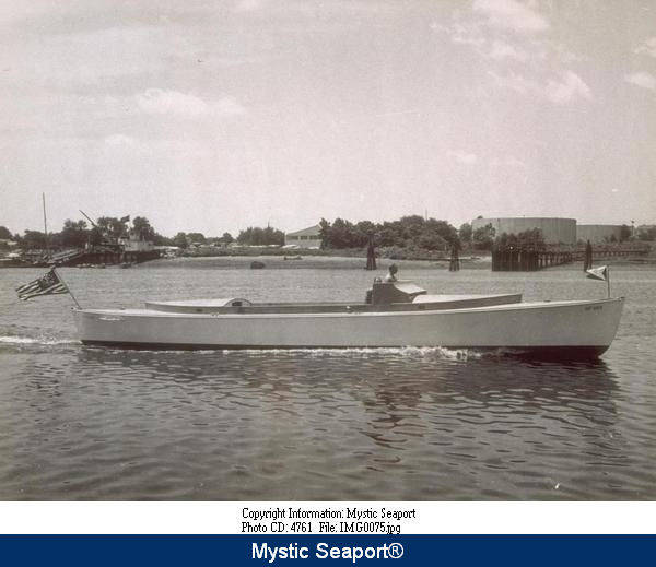

    ... Here is another, its "only" 40' long, and it does have training wheels, but it actually exceeds the regression models for performance.

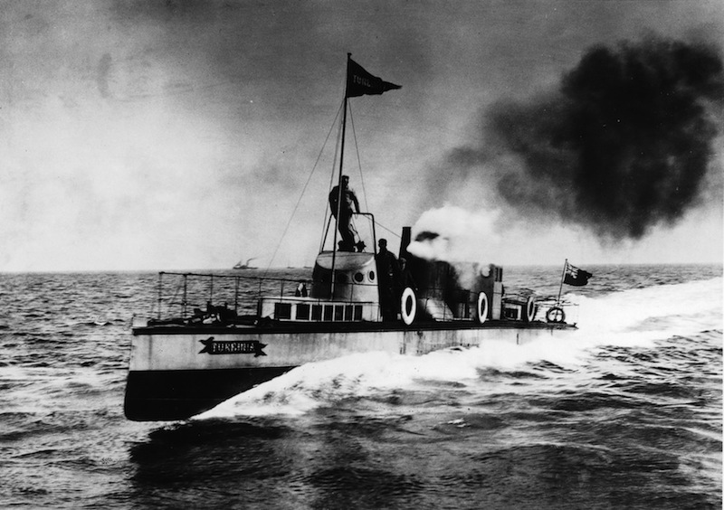

    Turbina
    About the right dimensions, but far heavier (steel and steam turbine). Many similar vessels around this time (late 19th century) chiefly as torpedo boats and commuters (some torpedo boats started out as commuters or toys for the rich).
