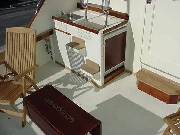

    I replaced the totally trashed fighting chair in favor of a custom aft deck table mounted on the existing chair pedestal. Bait freezer gave way to a refrigerator/icemaker. Any teak that was trim or vertical received varnish. Any teak that was horizontal or walkable stayed bleached and natural.

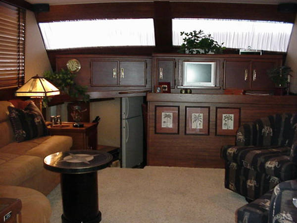

    The interior mahogany paneling and cabinetry was badly sun-struck and faded. Rather than refinish it by stripping back to bare wood, we elected to employ the interior satin finish that has a stain built in. It took several coats and some finesse, but the results were easier and quite acceptable.

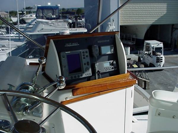

    Since she didn't have a hardtop, there was no overhead box for the electronics. I fabricated this pop up panel with the RayMarine stuff mounted inside on a custom engraved face plate. A linear actuator and the push of a button opened it. It turned out to be a good solution. Closed, with the power off - the equipment was secure from theft and out of the weather.

    Would like to get some more detail on the way you did the electronic panel with the actuator. Very tidy and safe, not to mention smart.

    It was pretty simple. Its a teak frame set in the top of the cabinet with a solid teak top attached at the rear with a piano hinge. The radius sides are Starboard attached to the top and face plate with pairs of teak strips. Before the linear actuator was installed, I would just lift it open and latch it in place. The 12v linear actuator (I think we purchased it on ebay!) was then mounted from below and merely pushed the hinged unit up to a stop. We used an up/down momentary toggle switch mounted in the face of the cabinet.

    The electronics panel looks great.
