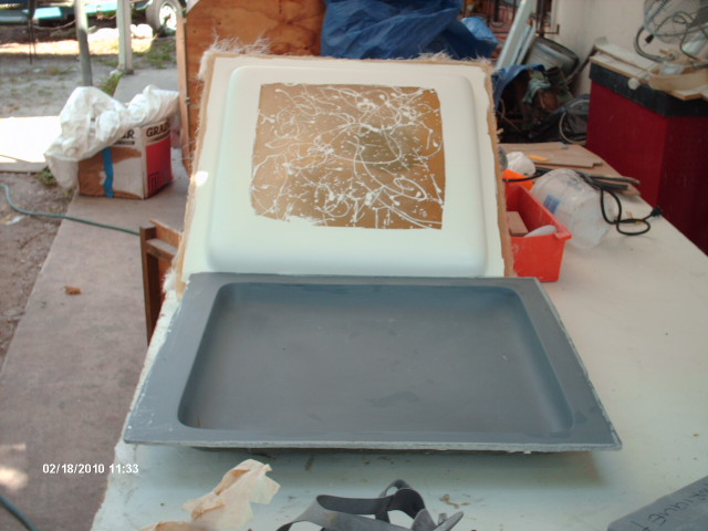

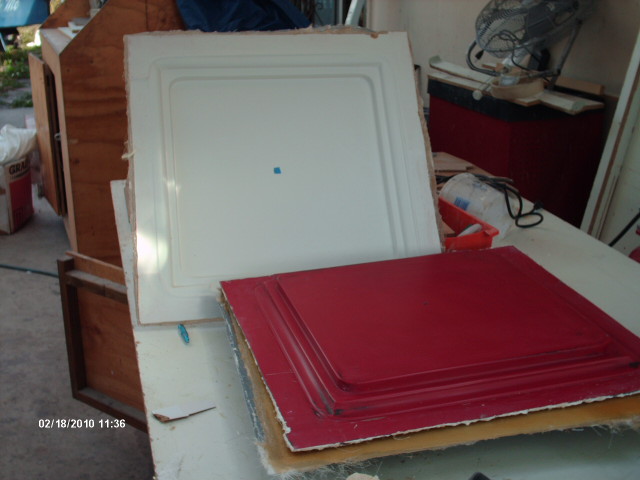

    I fabricated a two part mold and assembled three of them with 1/2 '' plexiglass. The originals were heat molded lexand with a wooden seating insert painted finish and rubber gasket. I still have the molds if you are intrestea some hatches, send me a PM.

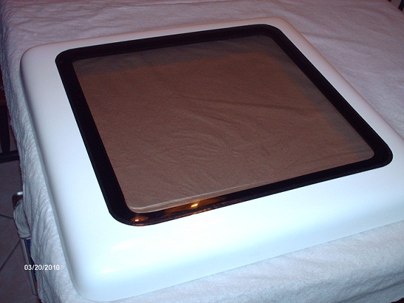

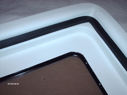

    Is this what your looking for ?

    post hatch molds
    molds and hatches
  18. tunaal
    tunaal New Member
    Aug 16, 2010
    8
    New Castle, NH & Clearwater, FL
    Those hatches look like a perfect replacement. How would I go about getting one of them? Nice work!
