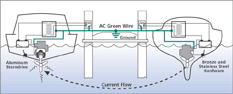

  19. Capt Ralph
    14,553
    Two boats tied together at the dock by the common green wire (ACv Ground fault line). Now all the underwater hardware is tied also.
    Natures battery and the softer metals loose.
    Now, Amplify this with a boat that has some leaking current on his boat. Ground fault current, Bad neutral connection, OR USUALLY, Some SFB that wired in his own air conditioning poorly. Your boat will loose zincs quickly, then you're bronze.
      16.8 KB
      1,097
  20. Berean
    Berean Senior Member
    Aug 26, 2007
    303
    Sarasota FL
    That is a great diagram. The galvanic isolator basically "unplugs" my boat from that great big battery called the marina and all my neighbors who are essentially functioning as cells. That seems straight forward enough. Thanks!
    As to any stray current that comes from my own boat, would ensuring the absolute integrity of my bonding system eliminate this problem?
