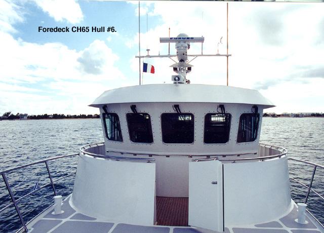

    You guys are not only geniuses, but witty ones. Thought someone might ask the range to see if bladder might be needed onboard;)
    I sent the foredeck picture to K1W1 with the grabrails showing on and aft of the bridge in regards to the safety aspect of holding on or tethering. I wasn't able to attach it, so if anyone is interested, perhaps K1W1 would be kind enough to fill in for my computer ineptitude.

  9. K1W1
    7,453
    The picture I was sent is 141 KB which is too big to post.( limit 100kb)
    I will alter the attributes at work tomorow and post it then.
  10. K1W1
    7,453
    I had to come into the office to get something so here it is.

    1,634
    Thanks for help posting the photo.
    As to Ben's original post about a Portuguese bridge, you can see where this helps deflect water over the piltohouse top, improves visibility, and prevents waves from hitting full force into the windows. The photo shows the railings which provide additional safety. Storage access is on the inside of the bulwark. And as mentioned, the "overboard prevention for men" is on the inside of the bulward on a sistership.

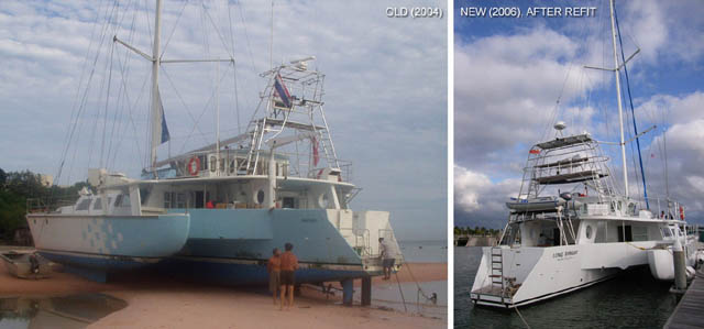

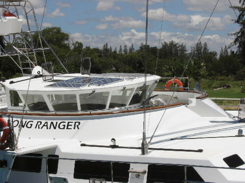

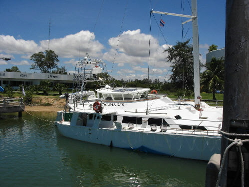

    Portuguese Bridge on Sailingboat
    Here's a rather interesting bridge arrangement on a sailing trimaran. I haven't seen too many such bridges on sailing yachts. The bridge was done rather well, but the arch/tower was certainly not very pretty.
    I took this photo at a Ocean Marine in Thailand during a recent trip

    Regarding the tower, this is my design.
    One can compare original alloy tower with new one we did in stainless/teakwood gratings/FRP roof. New tower is wider and easy to access, this is favourite place for guests to sit when running between islands. Note that all parts of new tower are structural and functional at the same time: for instance, handrails and ladders provide frame structures...
    Sure, tower is not top elegancy, but please have in mind that the whole boat exterior is 'workboat' style. We did complete refit of this 87' trimaran during last two years.
