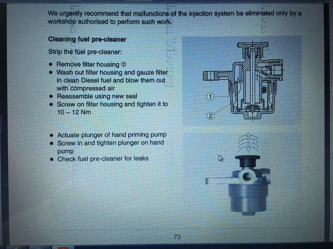

    Have you ever cleaned the fuel pre-cleaner? When you look at the operating book to change the fuel filters it says clean the fuel pre cleaner first. I've never done that? Your thoughts

    Picture of fuel pre-cleaner
  14. Capt J
    14,435
    I have not experienced what the book is telling you. I have changed the racors, then the Man primary metal filter (with the screw on clear bowl) and then the 2 pleated paper filters (secondaries) inside of the metal housings on the top rear of the motor. I know or was under the impression there was a s/s mesh filter like you're talking about which I've had cleaned by someone else. But I am not familiar with what the book is saying but that looks to be after the primary and secondary filters. That looks like it's on the injection pump itself which was the s/s metal screen I had a Man dealer clean.
