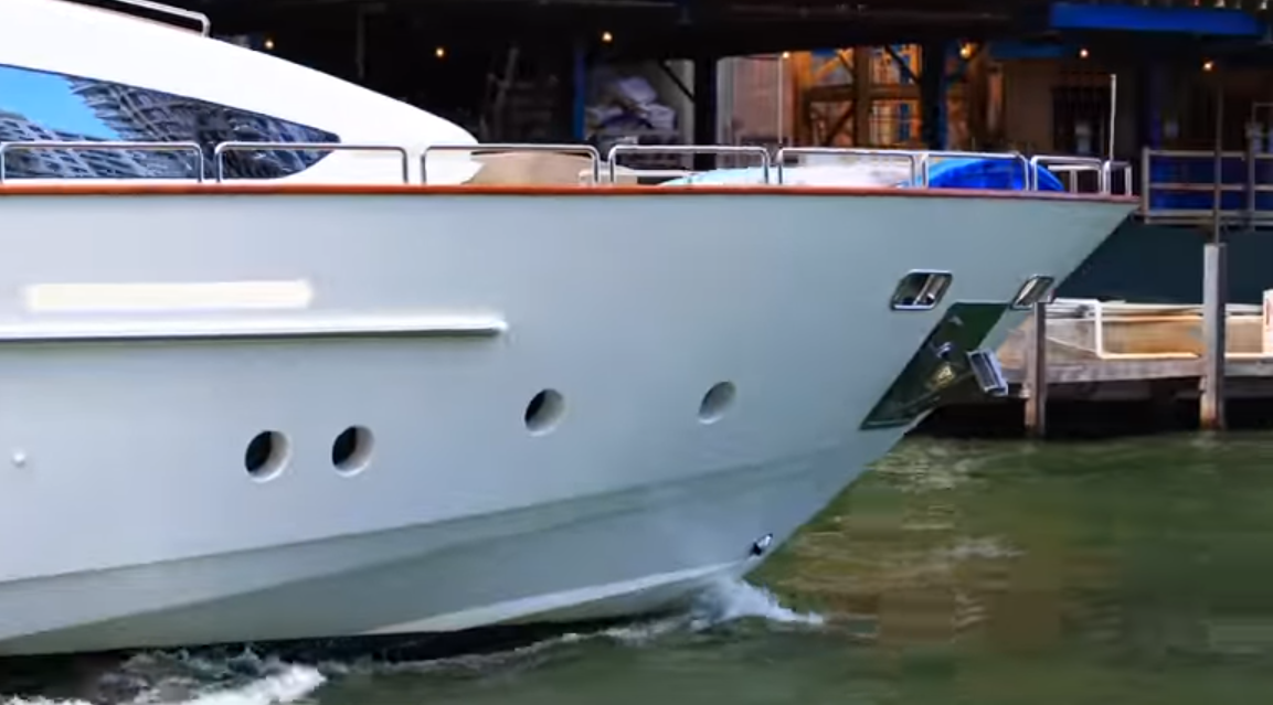

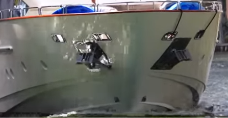

    You can always do what this guy does if they don't fit on your backing plates. ????

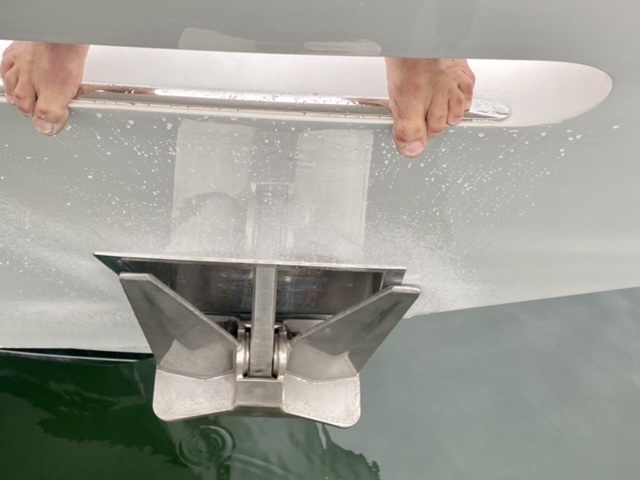

    Installed. It actually fits pretty well

    Those toenails might need some work. Look like mine

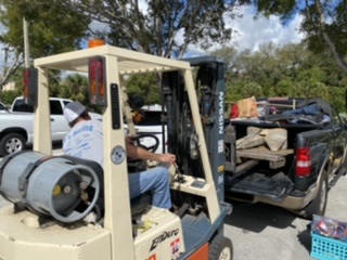

    Nice! We are hauled out and I thought it would be a good idea to drop the chain and paint it. Holly **** hauling that chain back in by hand is tough! Fork lift got the 296lb anchor but the chain was a work out!!
