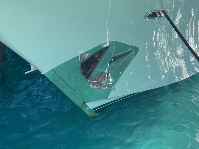

    I think the solution is going to be to add a stainless steel plate around the existing pocket and just get a bigger. That Hatteras part supplier whose name is taboo here of YF has bigger one, used.
    I don’t care about SS and neither does the boss. On the 84 the first thing I did was replace one of the two 100lbs SS CQR with a galvanized 176lbs Bruce. Never had an issue dragging.
    looking at other similar sized boats here in Compass I noticed one with anchors not recessed.
    looks like that s the best solution to my problem

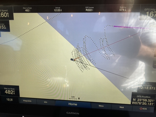

    I hate that anchor. Dropped in 11 feet of water just north of Farmers in a spot where I have anchored many times and we re in a slow drag with 225’ of chain and 15kts wind. That s over 16:1.
    anchor is flat on the Sandy bottom with just one fluke partially sunk in
    Never had so many issues in 30 years. Last night at big majors with 150’ of chain in 11’ we dragged 30’ overnight.
    that thing is going up for sale as soon as we get back!
    Or maybe I ll see if it fits the pulpit on my 53. Maybe it will hold a small boat

    If you can blend that pocket with a larger stainless surface and still manage to take advantage of the pocket, that would seem to be the best outcome. I'm tube-surface plane, and we catch a meaningful amount of water up the tube, often to deck. That recess will help deflect that energy and potential, I'd think... We bubbled the tube with an enlarged center that then returns to size in order to remove some of the energy, and we were reasonably successful. This is the benefit of the recess. Even consider shimming out from the recess to support the anchor, but try to keep the recess...
