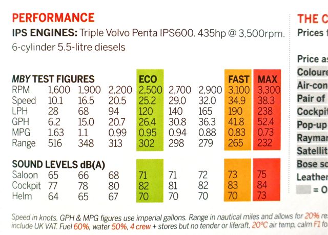

    Of course we did the homework before we designed the yacht for IPS/600, the IPS/900 were bigger and about two ton's more heavy. Other boat builders had already tested and we got the figures pointing to the best configuration for us, which it still is, by far.
    BTW, right now I have a 4 pod design in the pipeline... ;-)

    Instead of recalculating I'll post the Delta 54 test figures from MotorBoat & Yachting with litres and imperial gallons. The 900(hp) is how Volvo describes it for comparison, yes, but I no longer have the estimations for our boat. With twin IPS/600 the top speed is just over 30 knots.
