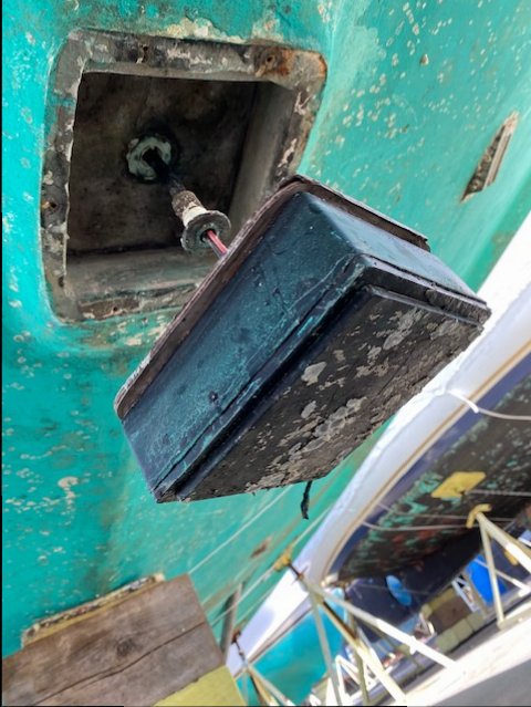

    I am in the process of updating the electronics package on my new to me 2000 45 Express. There are two existing trandsducers in the hull. The forward one is roughly 8" square, and the current chirp models are appox 14 x 8.
    Does anyone have any thoughts or tips on modifying the pocket to fit the new one?

    I took photos of the forward transducer after removing the frame and seal, but not sure if there is a way to upload them here? ( sorry I'm new ) The after transducer is smaller an not disturbed. I had thought it was done at the factory, but maybe was done after the fact. I don't have any experience with them. I guess I can talk to a fiberglass guy to see if feasible to modify to fit the new one, or seal it back in and abandon it in place and use a traditional thru hull version. Any help or comments are appreciated! thanks

    In the inside of the hull, just a "conventional" looking bronze thru hull with nut, and the cable coming through it.

    this is a photo, hopefully i am
    uploading it correctly!

    Cabo, and many others, originally located a plug for the transducer in the Hull Mold and laminated "around" it.
    If the old transducer is 8" long x 8" wide and the new one is 14" long x 8" long, I would have the yard enlarge the flush opening to fit the new transducer. Once the opening is cut, they can make a plug and laminate the 6" longer section to much the current bottom laminate, the install will look OEM and the risk is minimal.
