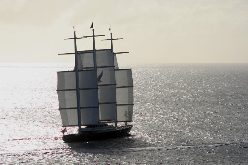

    "I have read with interest the opinions and questions posted about my Maltese Falcon "Clipper Yacht" over recent weeks. I'll attempt to answer these as best I can now that some time has elapsed.
    We call her a clipper because she attempts to achieve the multiple advantages of those fast square riggers from the past. If you look at photographs of the last of the big sailing windjammers, you will see that the fore and aft sails are really just vistigial---all the power is coming from the square sails themselves. The Dijkstra design simply carries this trend to its logical end, and eliminates all these redunant sails. The DynsRig concept leads to a yacht with the ability to point so high, that jibs, etc. are just in the way.
    The superstructure is just sufficiently high to permit a view ahead, over the bow, from the wheel house. Any lower, and the view would be blocked by the bow, and thus I believe, be unsafe.
    The signal mast forward is required for the radars, which cannot be mounted on the rotating masts. The height is required to raise the radar beam above the superstructure sufficiently to protect crew from the radiation. Also, this mast, in my opinion, fills in a space where one might otherwise expect to see jibs, and so it is there partly for aesthetic reasons.
    The sails are set automatically by a single person from a central console. Of course, there is routine maintenance required by an agile crew of sailors aloft, but rarely do they have to be in the rig during sailing. The upper sails are set or furled as required to control heeling. In a twenty knot true wind with everything set, and hard on the wind, the heeling angle is about 22 degrees. This isn't much for a small boat, but it feels too much for most guests, so we furl the sails necessary to keep heeling to around 15 degrees, and there is only a modest drop in speed.
    To date the we have set and furled all the sails over one thousand times. We have had only two or three problems requiring a man to go aloft to sort. We have experienced no damage to sails or rig. This is a staggering number. With all due respect to Mirabella V, I expect that during her entire lifetime, which I trust will be very long, her sails will not be set this many times. The DynaRig is very practical for a big boat, for the ease of use factor, if for no other reason.
    The Falcon may be a motor sailor, but not by my definition, since she sails faster than she motors---if that doesn't qualify her as a sailboat, then what does?
    I have raced classics for much of my life. I believe the Falcon is a new classic, and to my eye, she is very beautiful."

    Tacking Maneuver
    Can you describe the 'tack' maneuver in more detail?
    Which way are you rotating the mast? all together?
    I believe I have seen a reference to the masts being able to rotate 360 degrees and another indicating only 180 degrees??
  19. jediwhite
    jediwhite Senior Member
    Apr 9, 2005
    45
    Viareggio, Italy
    Tacking the 'Big Bird'
    The masts all rotate 180 degrees, +/- 90 degrees from amidships, they could go continuously round and round except for the need to have electrical cables to power and control the sails and lights.
    The fore is an exception as it can be 'overrotated' approximately 10 degrees each side to allow us to pick up the port tender and launch on stb side and vice versa.
    The sequence for tacking is that we come 'off'the wind a bit to get boat speed up, then start start the tack, turning the bow through the wind.
    We hold the fore mast, effectively backing the sail, then as soon as the bow is head to wind we rotate the main and mizzen masts through the wind until they are full and drawing, then we complete the tack by rotating the fore mast to its new postion, and off we go. It can be a bit slow and we always lose boat speed but have never been 'in irons' and rarely use any 'help' from the engines. sometimes we have one running 'just in case' but we pride ourselves on not using it unless absolutely neccessary.
    I hope this explains it a bit more
