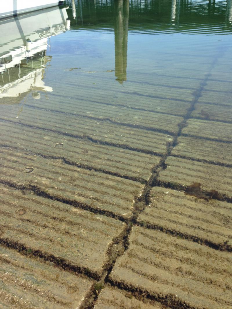

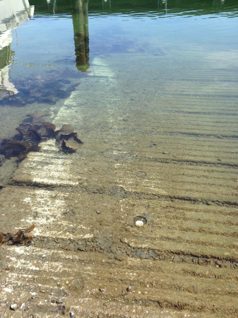

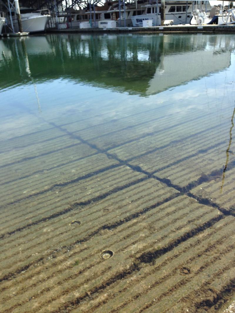

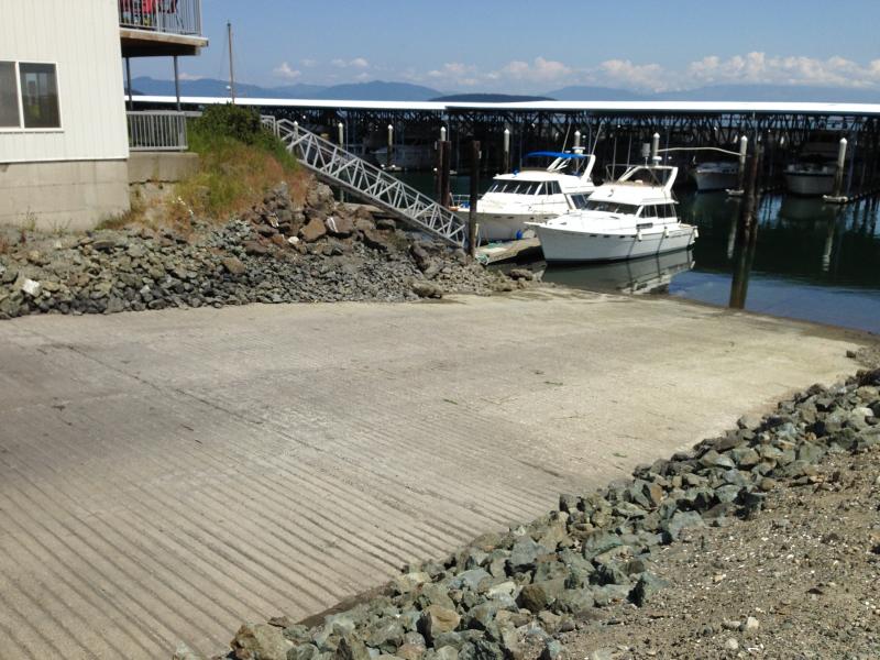

    Launch Ramp pictures
    Here are pictures of the launch ramp in question. I went at about a -0.6 tide which should be more than nine feet below the launch level if I'm correct about the timing of the launch and the tide at that time.
    My impressions of the ramp (merely as an interested observer, no training in this sort of thing) is that there is no fault with it. There are some places where the ramp is scratched but no obvious signs of this disaster such as paint stripes and certainly no signs of collapse. There are deep scratches but they do not look all that recent. The ramp appears to extend well past the rollover point.
    There are very faint tracks on the barnacles that go down the ramp and veer off of it to the left into the mud (as you face the water, the stbd said of the boat as it was launched.) This might be what the builder is talking about -- but rather than going off the end of the ramp he fishtailed off to the side. The tracks look wide enough, but do not look particularly recent and there is no large disturbance in the mud where they end. Of course, this is after many tide cycles but it would take a much smarter person to determine whether these have anything to do with the incident. They are so faint they do not show up well in pictures.
    The water level at the time of launch appears to be about the level of the white rock in the first picture.

  7. Capt Ralph
    14,557
    Wow
    Some very good pictures and observations. Thank you for your time on this.
    I do agree, This ramp looks to be in very good shape.
    Kind of instills in me the ship did not hit bottom if the tide was up where that white rock is. Even if the hull was on a stern down incline. Could you figure another 3 - 4 feet in the basin?

  9. dsharp
    dsharp Senior Member
    Aug 23, 2009
    240
    lake jackson, tx
    On the last picture there appears to be dark marks on the pilings across from the ramp. Are those water marks? I'm not used to having that much change from high to low tide. From the video it looks like the boat never got any lift at the transom. Whether it was too heavy by design or the engine room door was open allowing water to enter is anyone's guess at this point. She seemed to float well on her side, for a while anyway.

  17. Trawler George
    Trawler George New Member
    Jun 2, 2014
    Anacortes, WA
    Those are mussels and barnacles. We have large tide ranges in the NW, a fact that gives joy to the shipyards and grief to unwary boaters. You can still see "tidal grids" where people used to work on boats by tying them to pilings and letting the tide fall until the boat is sitting on horizontal pilings that support it. I don't think it is legal in WA anymore due to EPA regulations but I have seen it in Vancouver (at the rowing club) and Alaska.
