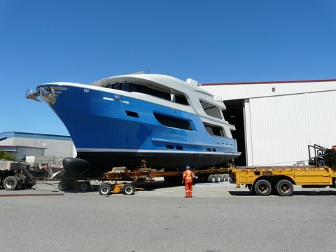

    Just got a call from my buddy out there...they moved the 90 back into the building in the middle of the night, and at the time of the launch the hard top had been installed, so when they got back to the building the dollies were still attached, so get this....they took a chain saw and cut the hard top off...wiring and all....to get it back in the shed...apparently they want this boat out of sight of everyone. This is getting crazy...anyway he had no update as to any litigation progress.

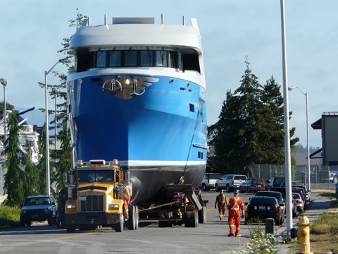

    If you look at the photos, the link to which I posted in #168 above, you will see this isn't the case. The flying bridge was removed before they ever started the move, and it occurred in broad daylight, as you can see.

    I live there, bro. Either you or your friend are making stuff up.
    Does this look like the middle of the night to you or that the flying bridge has been removed with a chain saw? I was there when they attached the crane to remove the darn thing.
