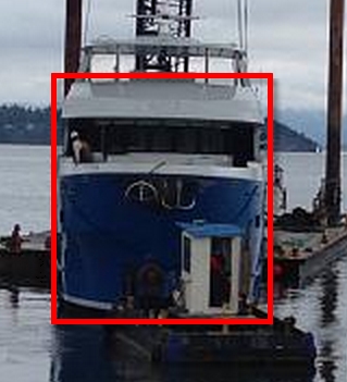

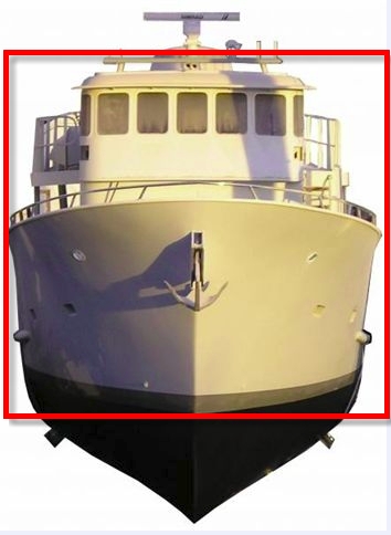

  16. Delfin
    Delfin Member
    May 28, 2014
    52
    Anacortes, WA
    It might be an optical illusion, but once I measured it, Baden's height doesn't seem that much greater than her beam. Did I understand AMG and your point correctly? She is certainly taller than Delfin, but while we will have to see the USGC report for more information, Baden's behavior in the slings would suggest a serious ballast deficiency. That's probably enough speculation, but your point on the 'ideal square' for a trawler is very interesting. Thank you and AMG.
