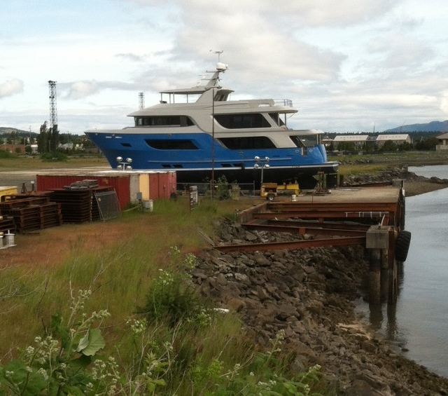

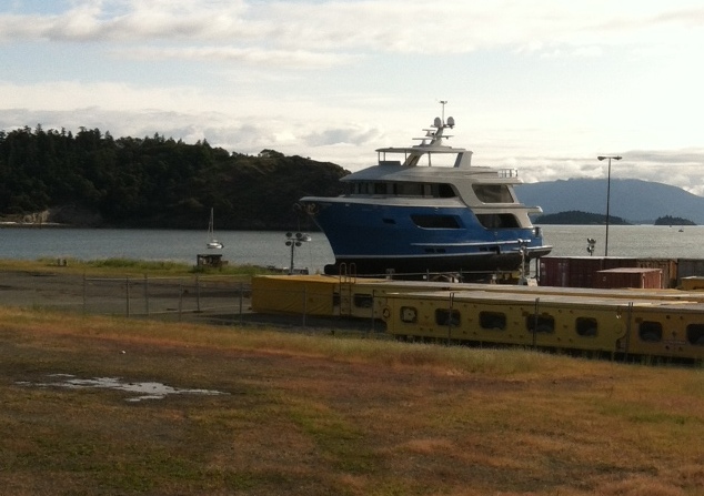

  10. Boatbuilder
    Boatbuilder Member
    Jun 27, 2011
    49
    Anacortes WA
    The vessel is now on land, see a couple of cell phone pictures taken from perimeter fence.
    This is the barge dock just north od Anacortes Marine, location:
    48.30.334 North
    122.36.434 West

    There was zero visible activity Saturday when I took the pictures, I think the Lights were there for the night crane activity getting her out of the water, and I doubt there is any in ground power there that could provide anything. I doubt you would want any of the ship's circuits energized after the submersion.
    She is sitting out in the weeds...who would ever buy it?
