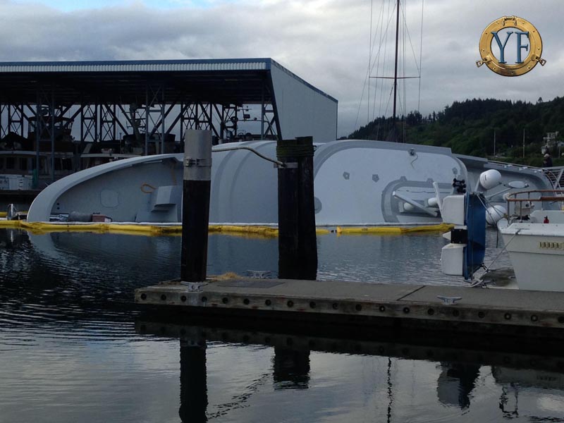

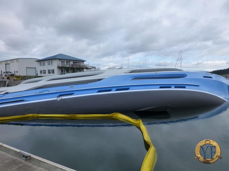

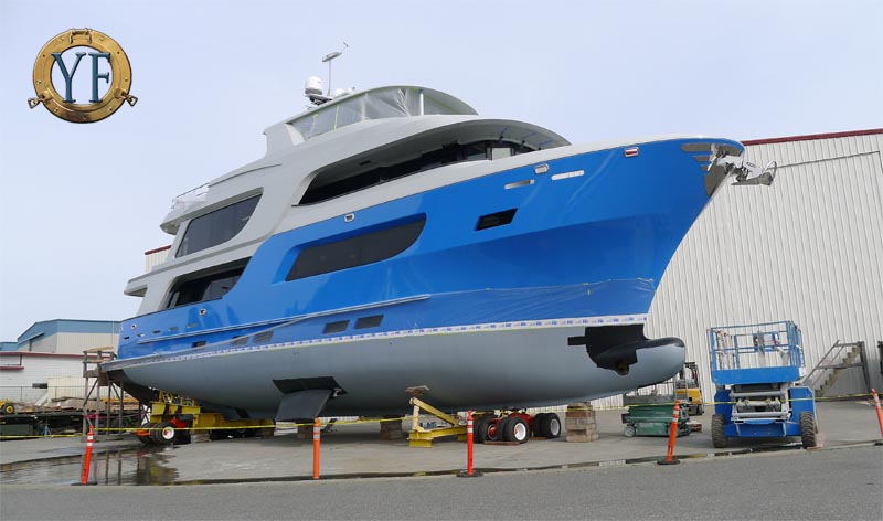

    Judy Waldman was in Anacortes for TrawlerFest last week and sent me these pics of the new Northern Marine...

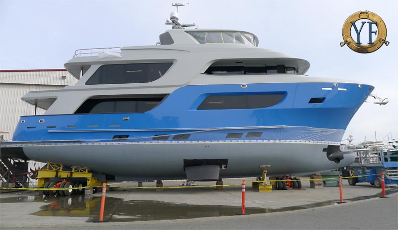

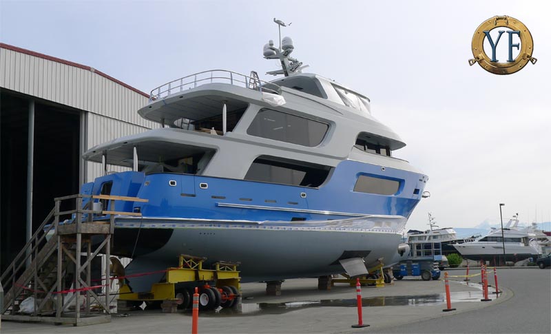

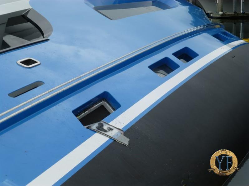

    Are those five windows right at the waterline? If so, aren't they exceptionally low? I mean at the expected waterline. Obviously the current waterline is different.

    I see. Glad I haven't gone insane yet.
    If you look at the rendering, they seem to be not much above the water line.
  8. olderboater
    olderboater Senior Member
    Sep 2, 2013
    7,127
    Not just the rendering. Judy's photos too. They just seem to be in a very odd location to me. I'm looking at their other models and also the waterlines when underway.

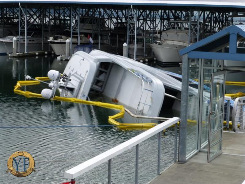

    Some more pics just arrived...
