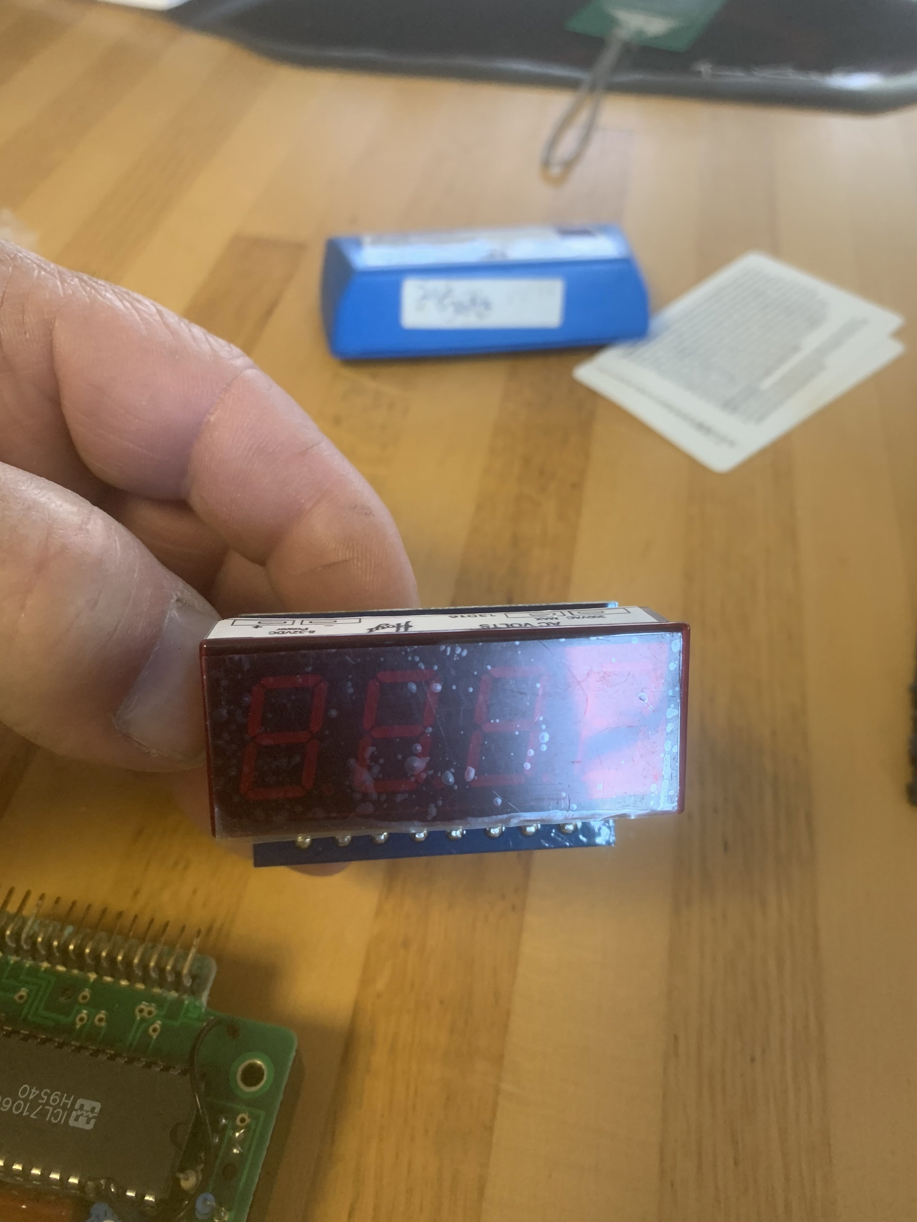

    The closest I could find is coming from. Hoyt Meters and I’m hoping with a little bit of modification I will be able to use The bezels that are there I’m going to try one first and if it fits in the way I like it I will order the rest of them and I will post pictures I went to all the websites that everyone here had posted Who would’ve thought it would’ve been that difficult to replace a couple meters I will post pictures hopefully with the meters in place

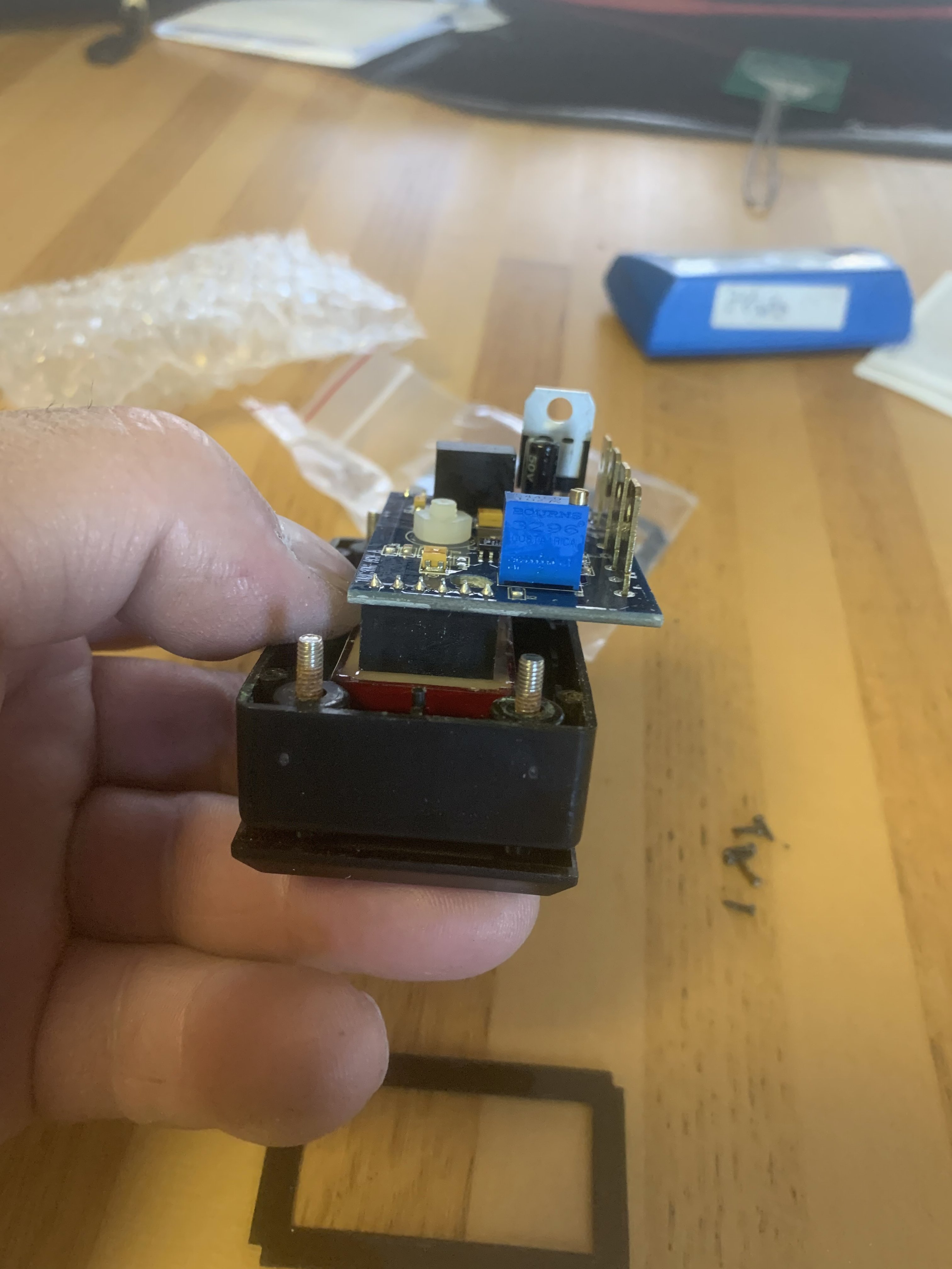

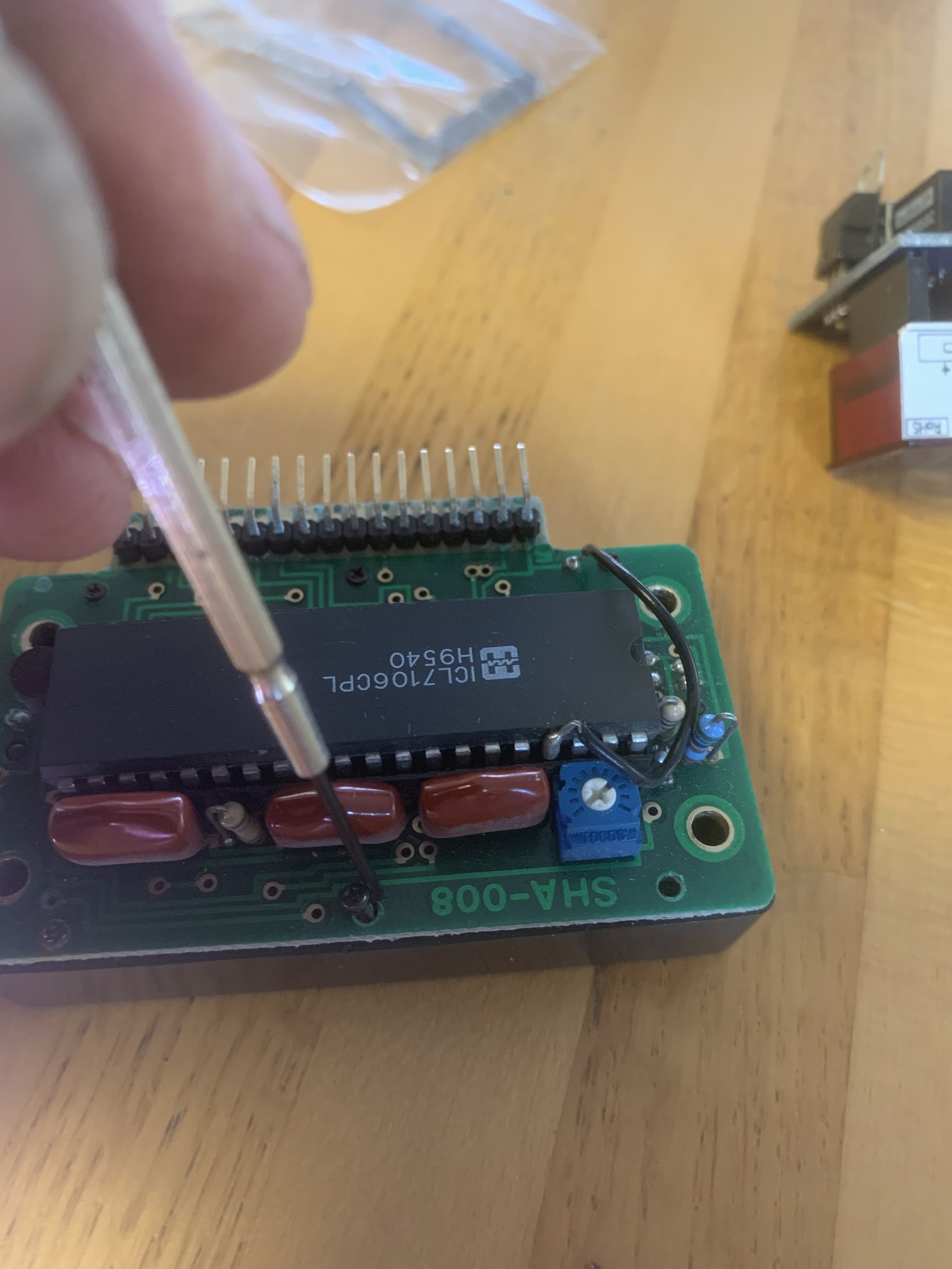

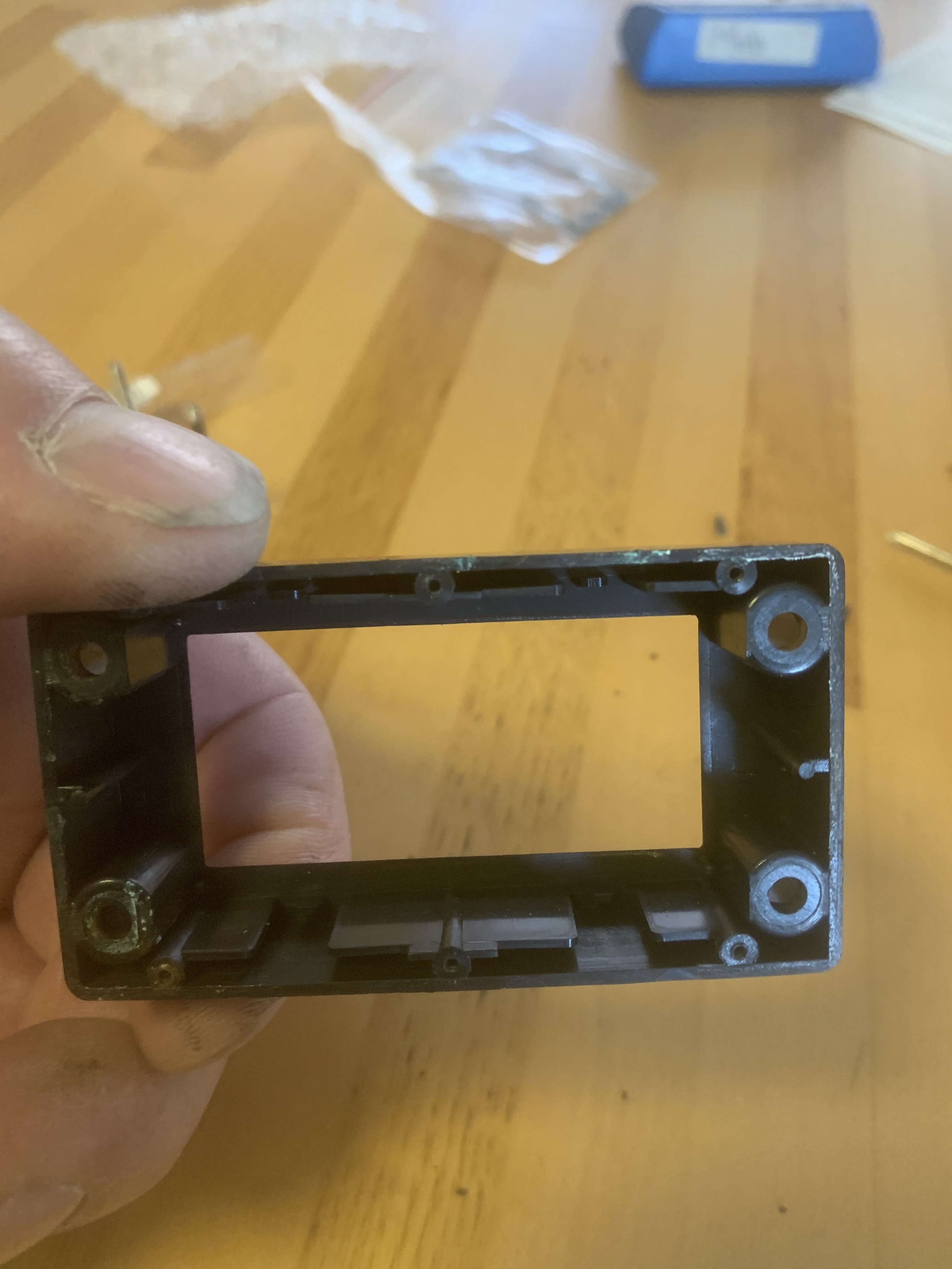

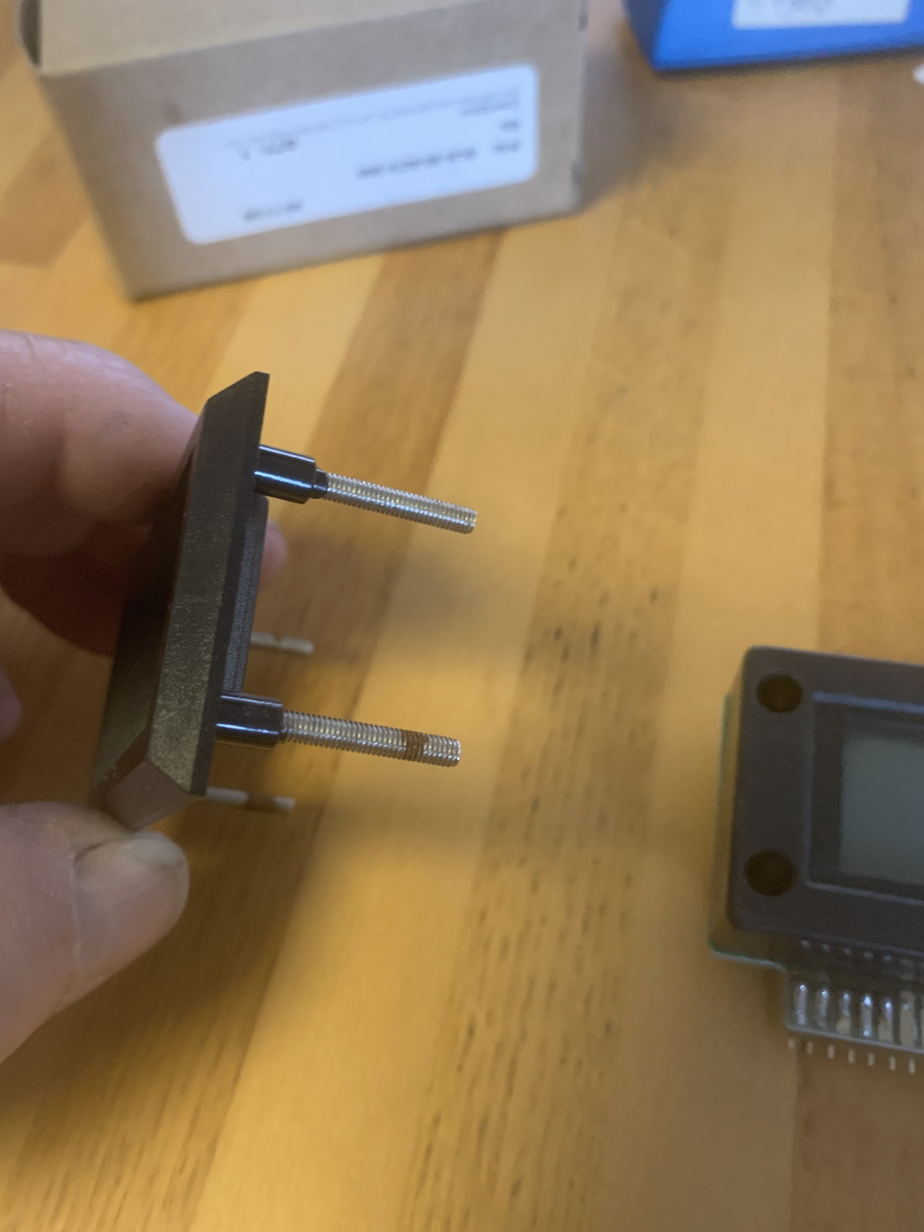

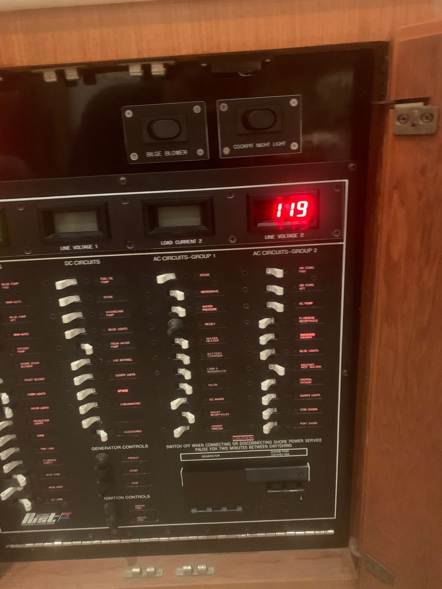

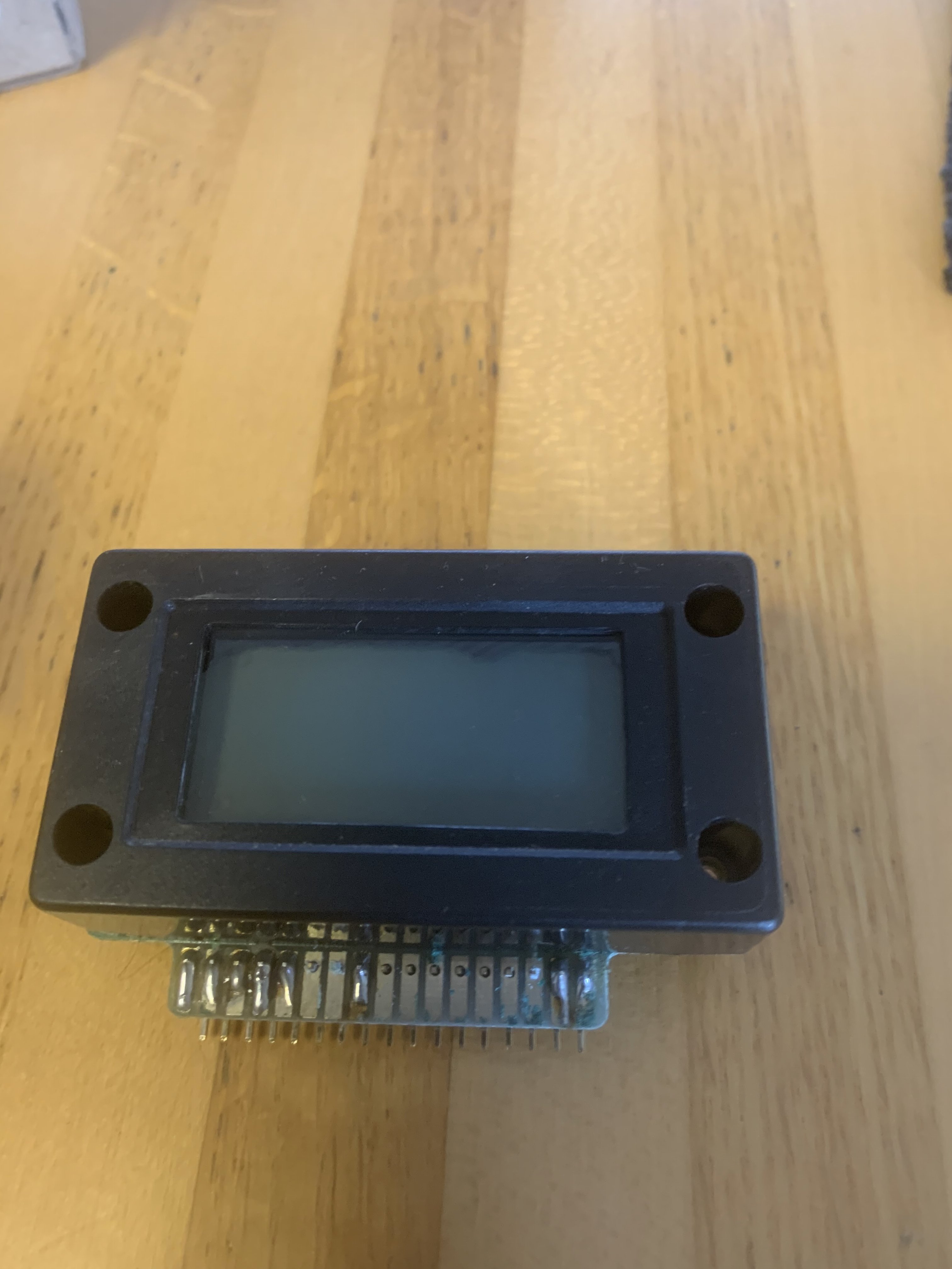

    Some of the photos were not in order but you can see the original panel meter I took it apart by little screws in the back and inserted the new panel meter I just had to file the corners just a little bit so it fits snug then I put a piece of quarter inch foam on the top and the bottom to fill in the gap between the original housing in the new panel meter and reassembled everything the panel meters came from Hoyt meters in New Hampshire hopefully this will help anyone else that needs to replace these meters I will be ordering one more voltmeter tomorrow into amp meters
