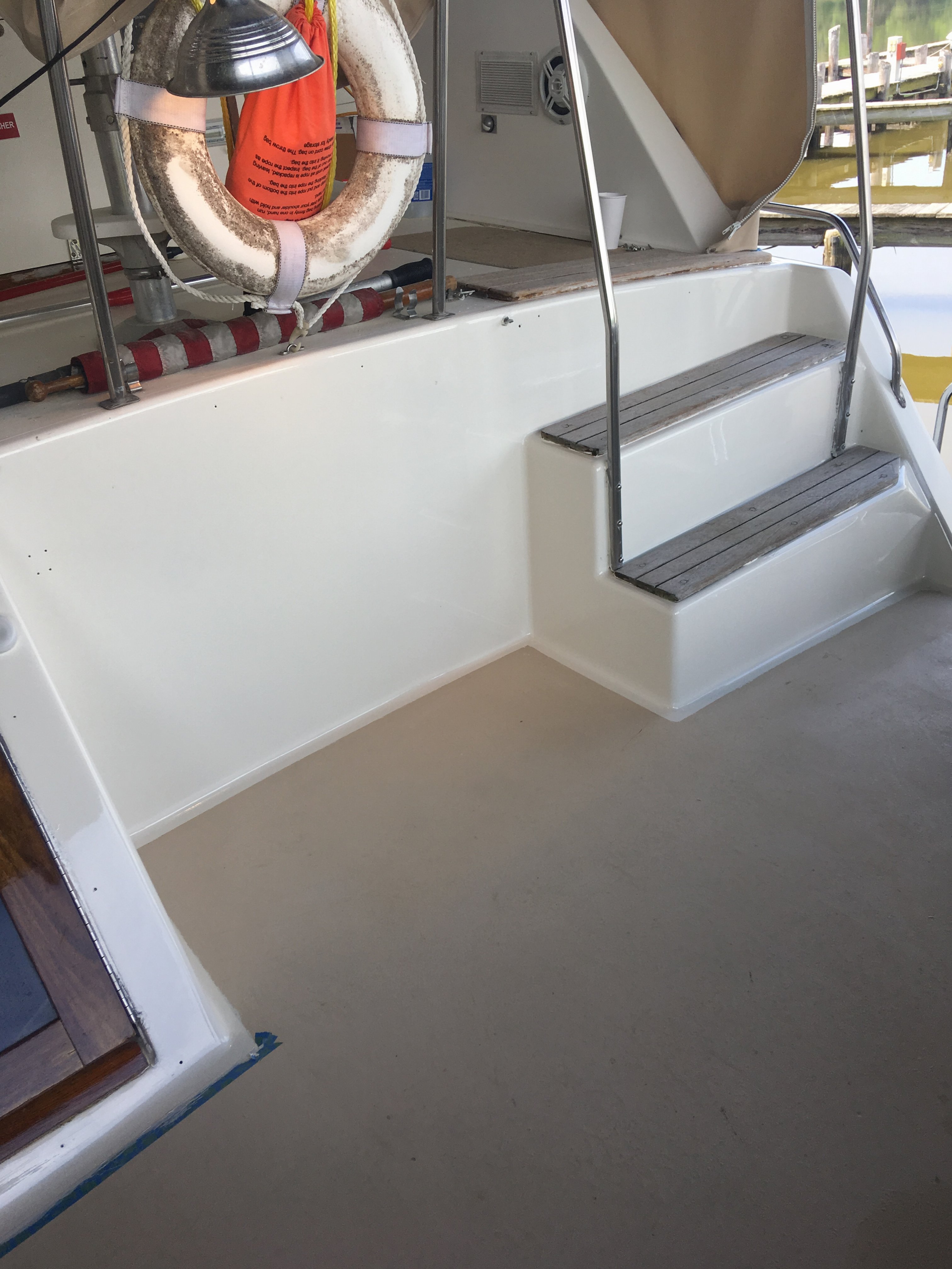

    Here are some photos.

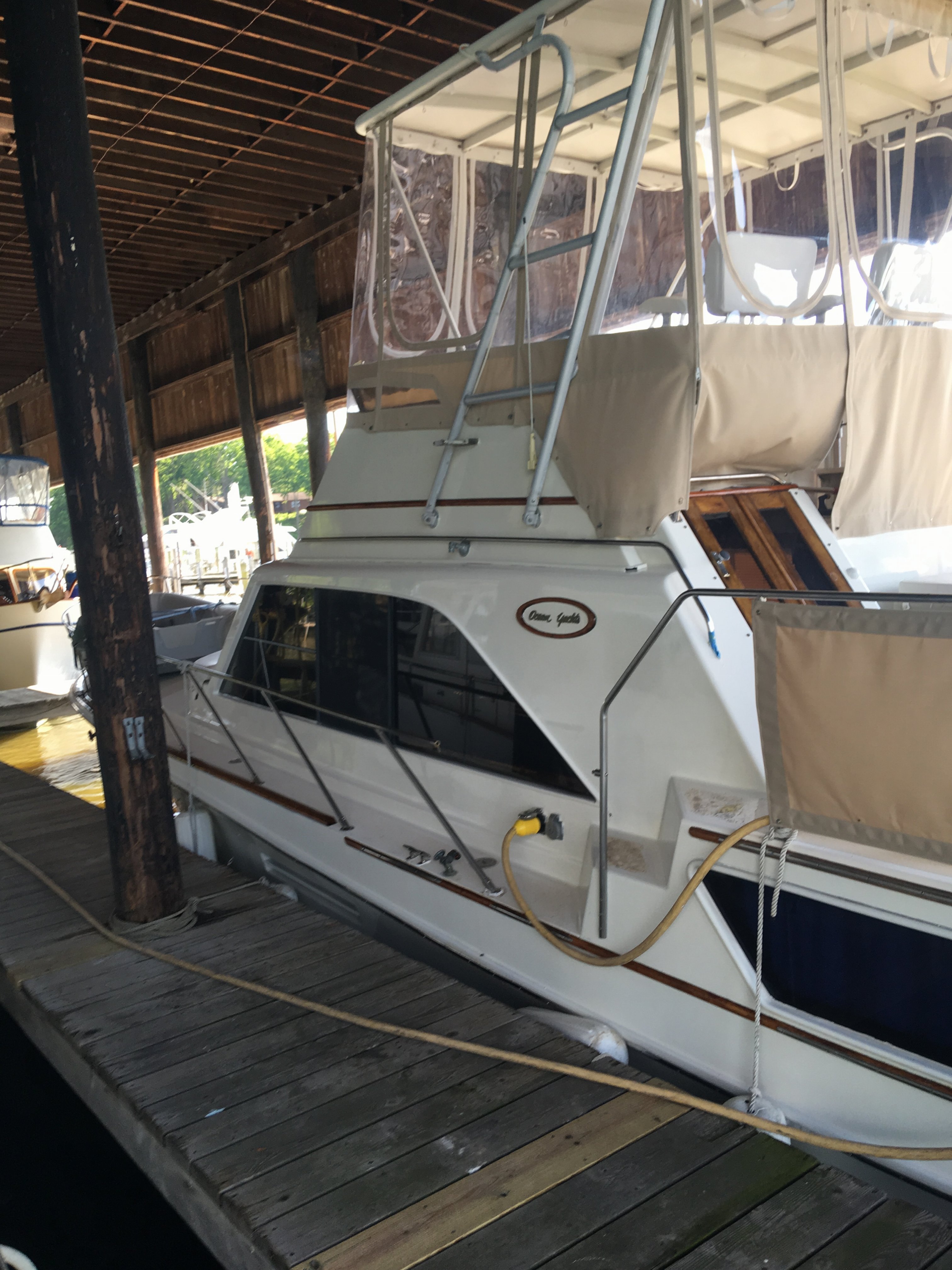

  10. cleanslate
    cleanslate Senior Member
    May 29, 2018
    1,658
    Cherry Hill, NJ
    96E7C1AB-7B53-4718-B576-B7E8258075CD.jpeg One more from deck up to canvas in this photo

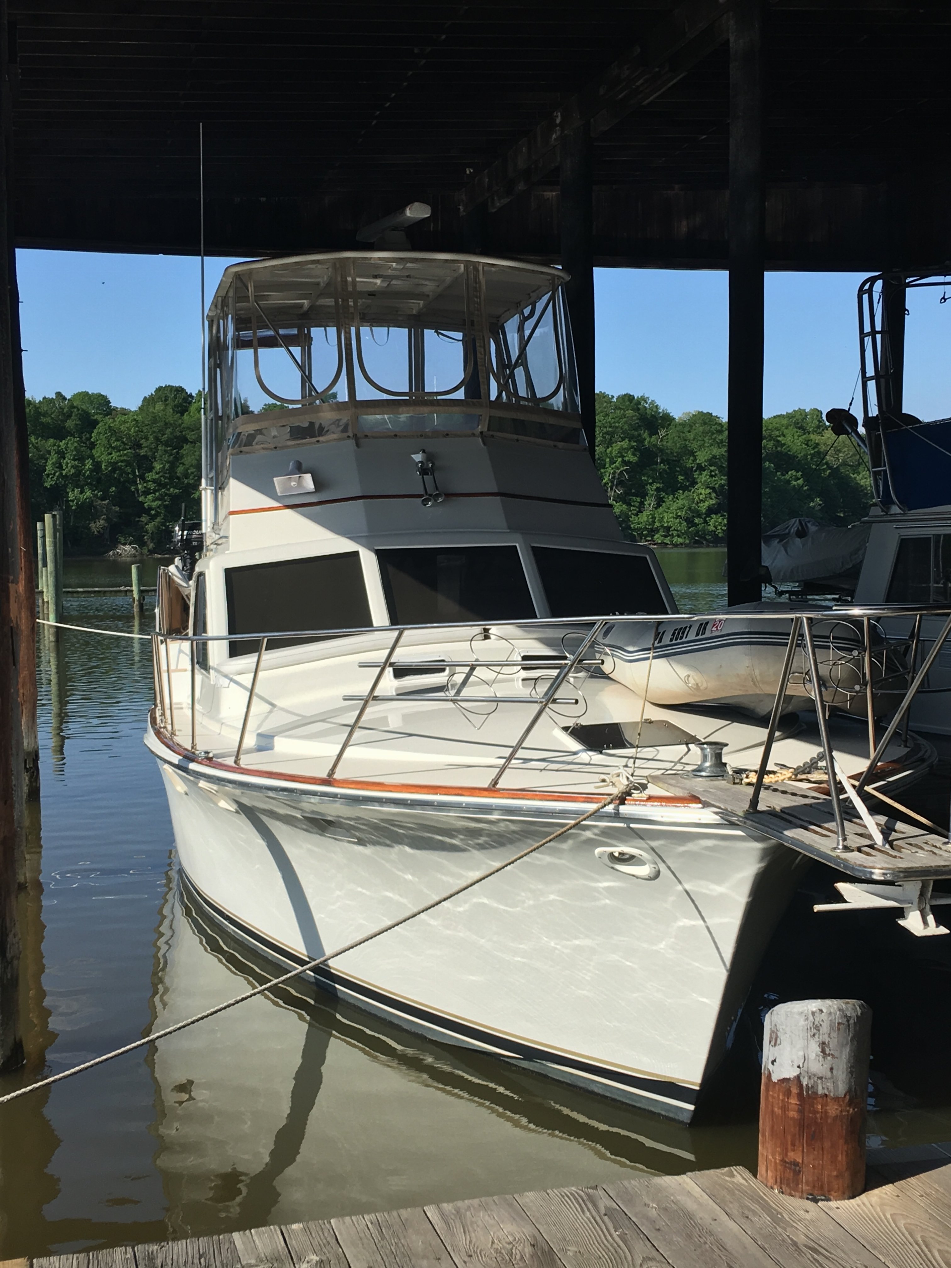

  11. cleanslate
    May 29, 2018
    1,658
    Cherry Hill, NJ
    2238C7D4-53D2-4A00-B721-F26E419DC09B.jpeg Forward deck/ front windows etc
